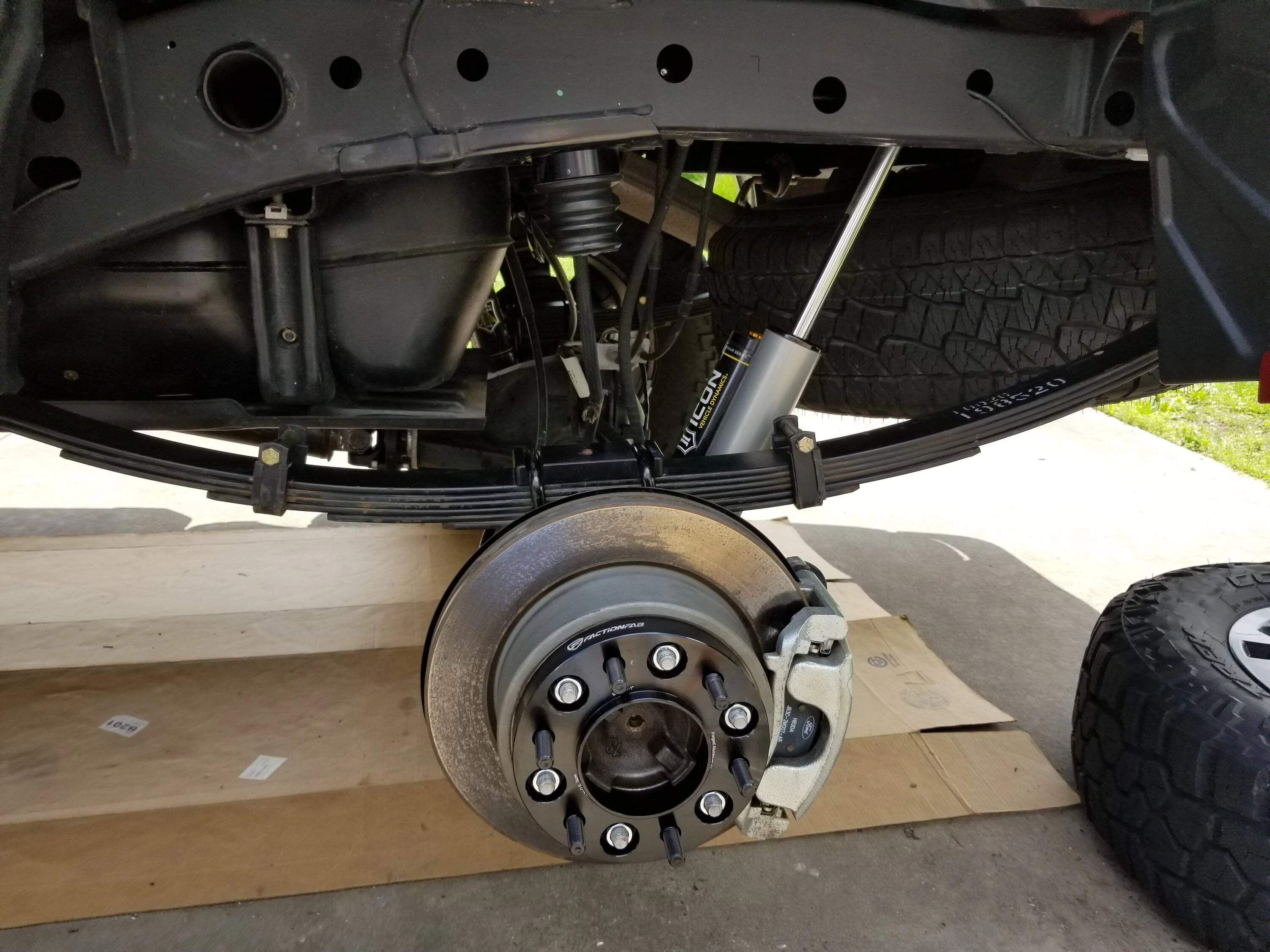

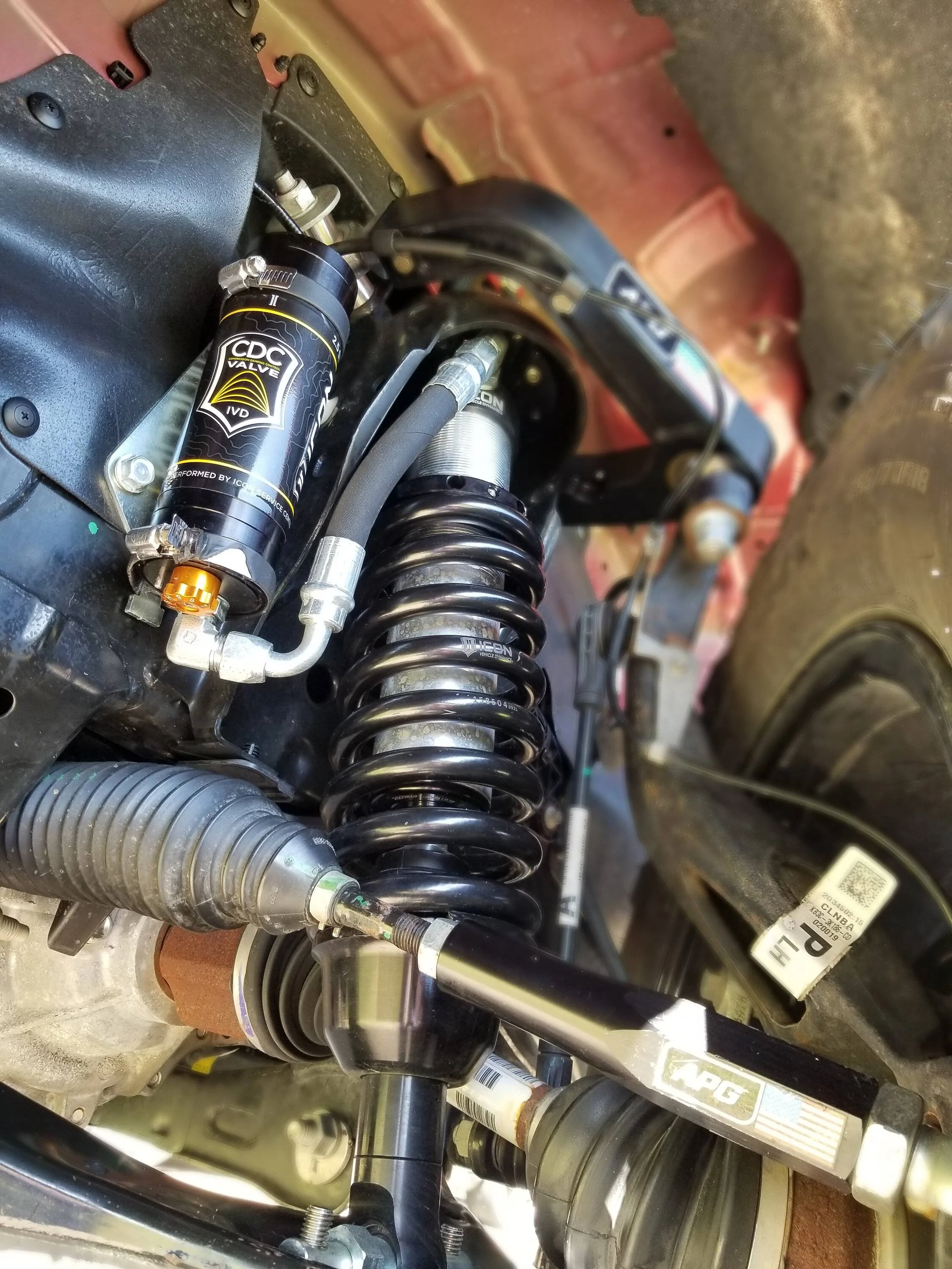

Has anyone put these rear springs on their truck? Did it change the stock ride height? How did it change the ride?
https://www.stage3motorsports.com/198520-19-22-ranger-icon-multi-rate-leaf-spring-kit.html
I have the ICON leaf pack....added 1.0" height, installed as shipped, without swapping in or adding the extra leaf.. I went head first down the rabbit hole, Front and rear ICON 2.5 adjustable valve, remote reservoirs, ext travel all around...Firm ride, corners flat ..Not for everyone, but I like it..Over built.. yes, but peace of mind that I can push it offroad, and make it back to civilization....
