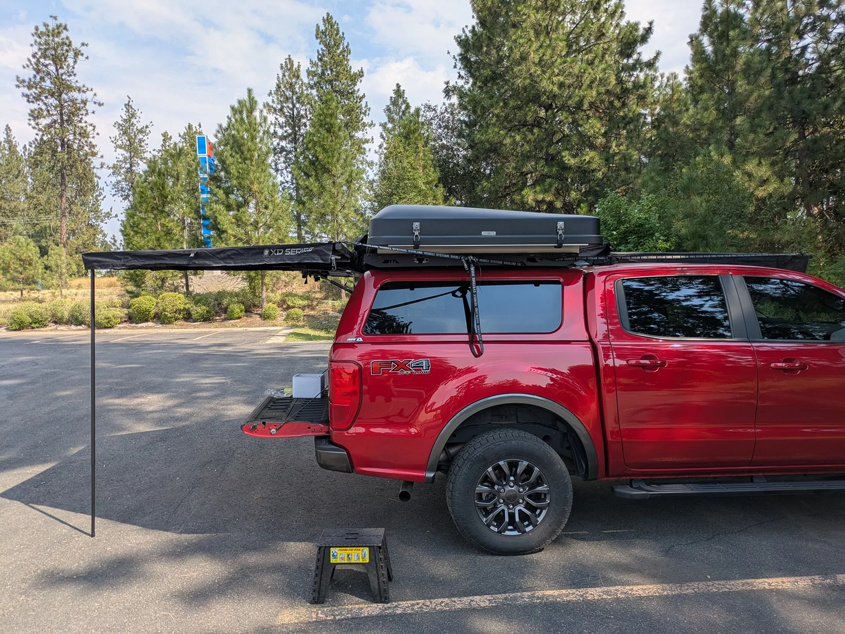

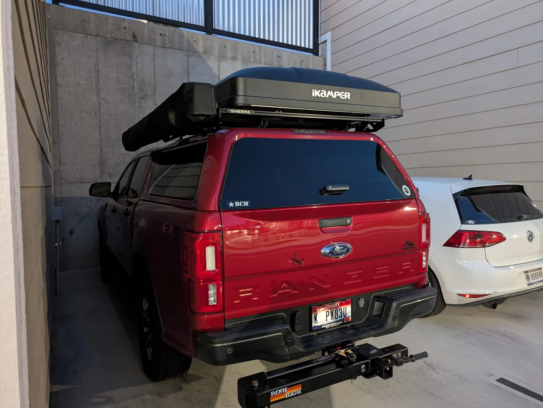

Hello all, I have a 2021 Lariat that is my daily driver that has 60,000+ miles, and I've owned it since new. I have a color matched A.R.E. shell, and it's set up for camping with a rack, roof top tent, and 270 awning that is mounted full time. I've noticed lately that the ride feels "wallowy" and not very tight. It's probably been going on for a while, but just now noticeable to me. Do you think it's worth the $1,800 to upgrade my suspension with the Ford Performance Off-road leveling kit with the FOX coil overs? I'm on a limited income now (64 yo) and anticipate keeping the truck for as long as it is a good runner. I keep up with all recommended maintenance. Thanks.

What did the Eibach Pro 2's do better than the Fox and what type of surface did you notice the improvement on? Is your rig loaded with weight up high and in the bed? I'm mostly trying to correct a mushy feeling, without precise control, and lots of roll in corners. I'm also thinking about a rear sway bar, but don't know if that will help. Air bags would help if they are able to be on separate air chambers (right vs. left).

With your A.R.E. shell, camping rack, rooftop tent, and awning mounted full-time, you have a significant amount of constant weight on your truck. That's why I lean towards the Eibach Pro-Truck Stage 2 kit. It seems perfectly suited for our kind of setup, where handling that extra weight while improving on-road comfort and off-road capability is key. The lifetime warranty and "set it and forget it" design are big pluses.
