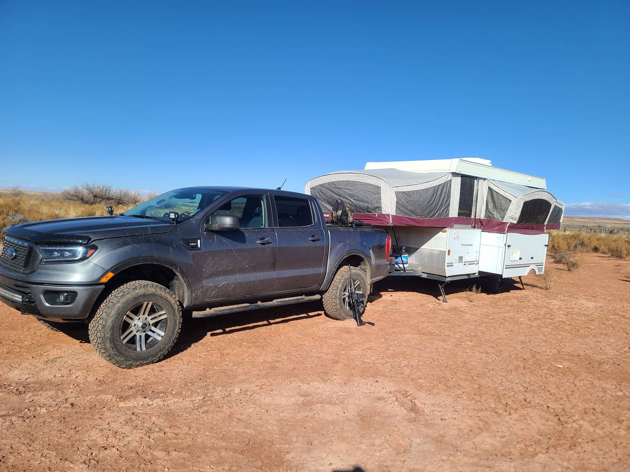

2019 Lariat 4x4. Towing 4500 pound (gross) travel trailer with 6500 pound rated weight distribution hitch. When first set up the WDH the truck rode with stock rake. After a couple of month long trips the rear is definitely lower, even without the trailer. Dealer replaced one broken leaf spring back in February before the first trip. Payload in bed never more than 350 pounds. New aftermarket springs and shocks?
Pretty happy with my ARB / OME EL121R. Beat the pants off the stock Ford springs in ride quality. The springs Lift the rear by 1.5", add 600 pounds spring capacity. Have my spare hung on the rear which bring the rear down a bit. They make a no lift 600lb extra capacity spring which would work well for you since your truck is already lifted. Call them @ 1 866-293-9078. to discuss options if interested.
