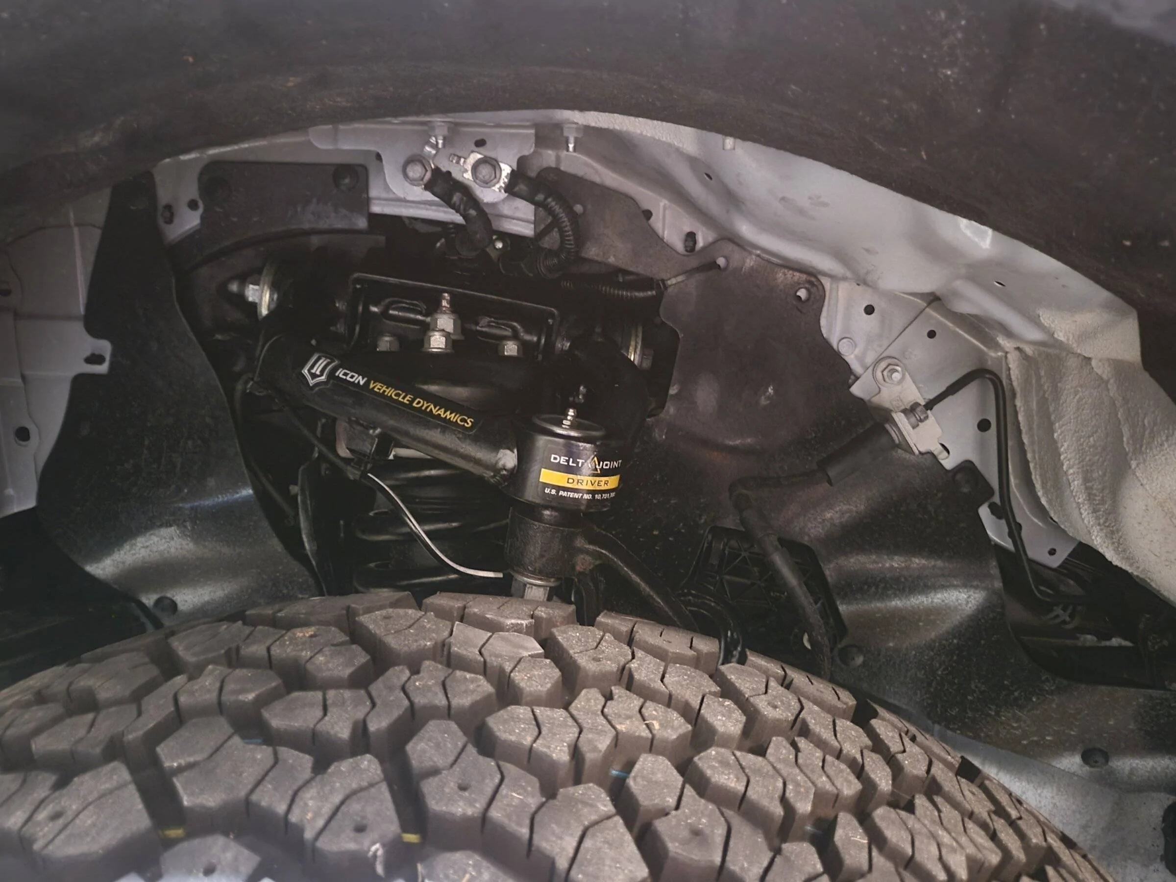

'21 Tremor, '16 Audi TT, '21 Ducati Hyper, '85 E30
Separate post:
Since we are already level, any further lift will require aftermarket upper control arms.
Members with 2" spacers have needed UCAs to get their alignment back in spec.
I have Icon UCAs.
