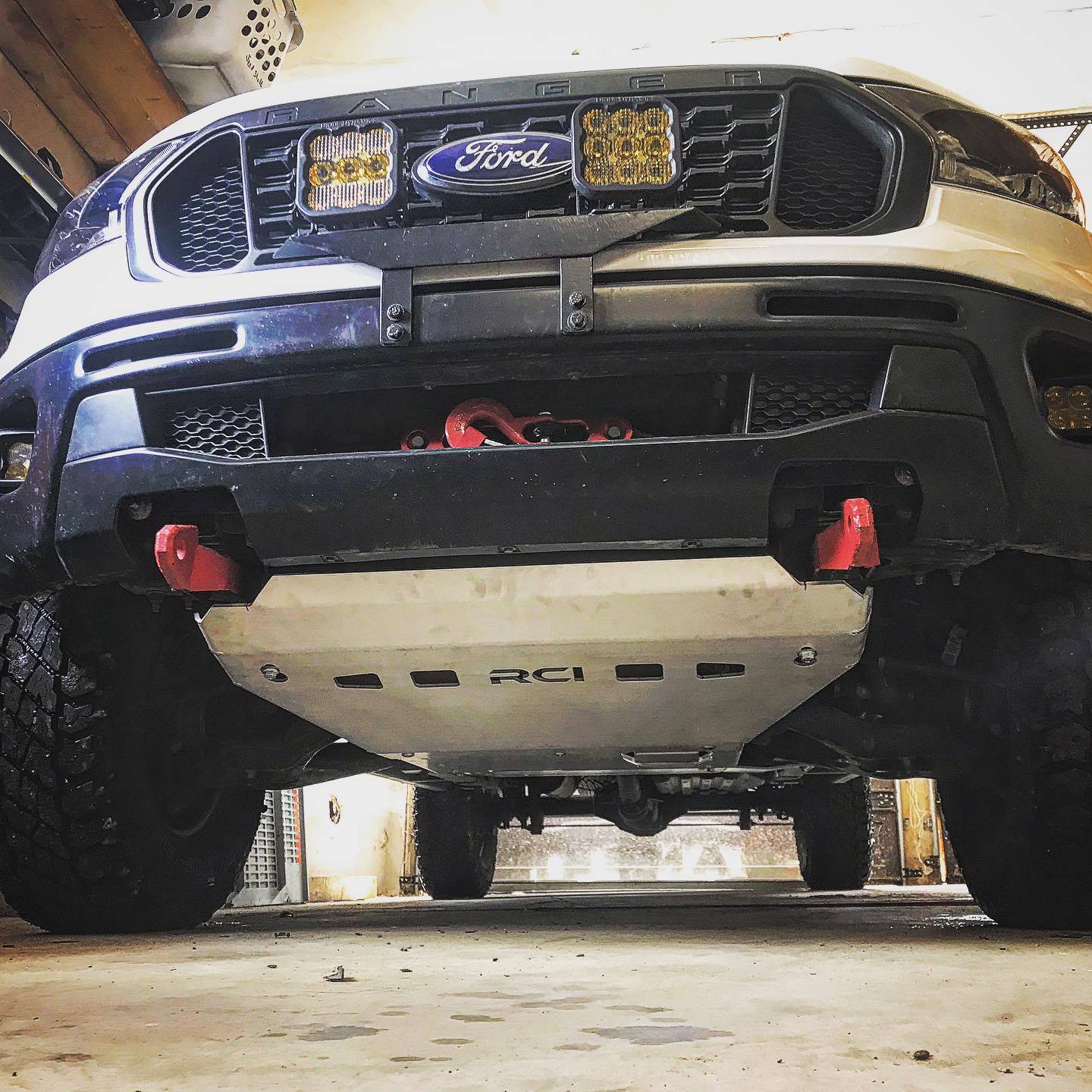

RCI’s ears must have been burning. I received them last week and installed them this weekend. Very well made products and super easy to install.

hey shane, what light mount is that you have for the amber lights?

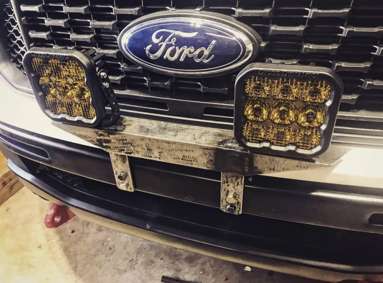

It’s a scrap metal original from Shane’s garage. Piece of angle and a piece of strap welded together, cut to shape. Drill 4 holes in the bumper and put in some threaded rivets (or just use a nut and bolt). You got yourself a light bar. The US bumper is steel, so it works quite well. ?

nice work! thank you
