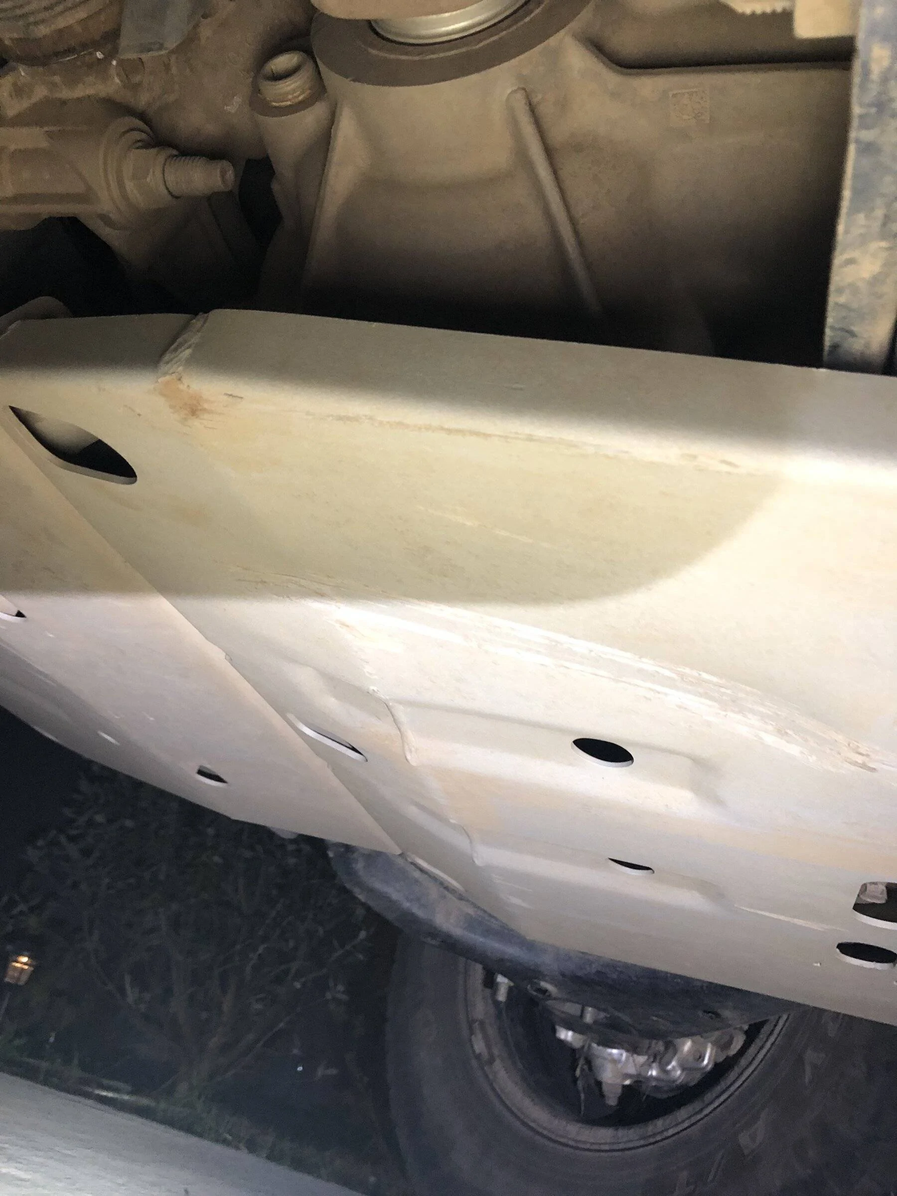

So the plates are worth every penny! Had a pretty hard impact on the High Water Mark last weekend. Right under the front diff:

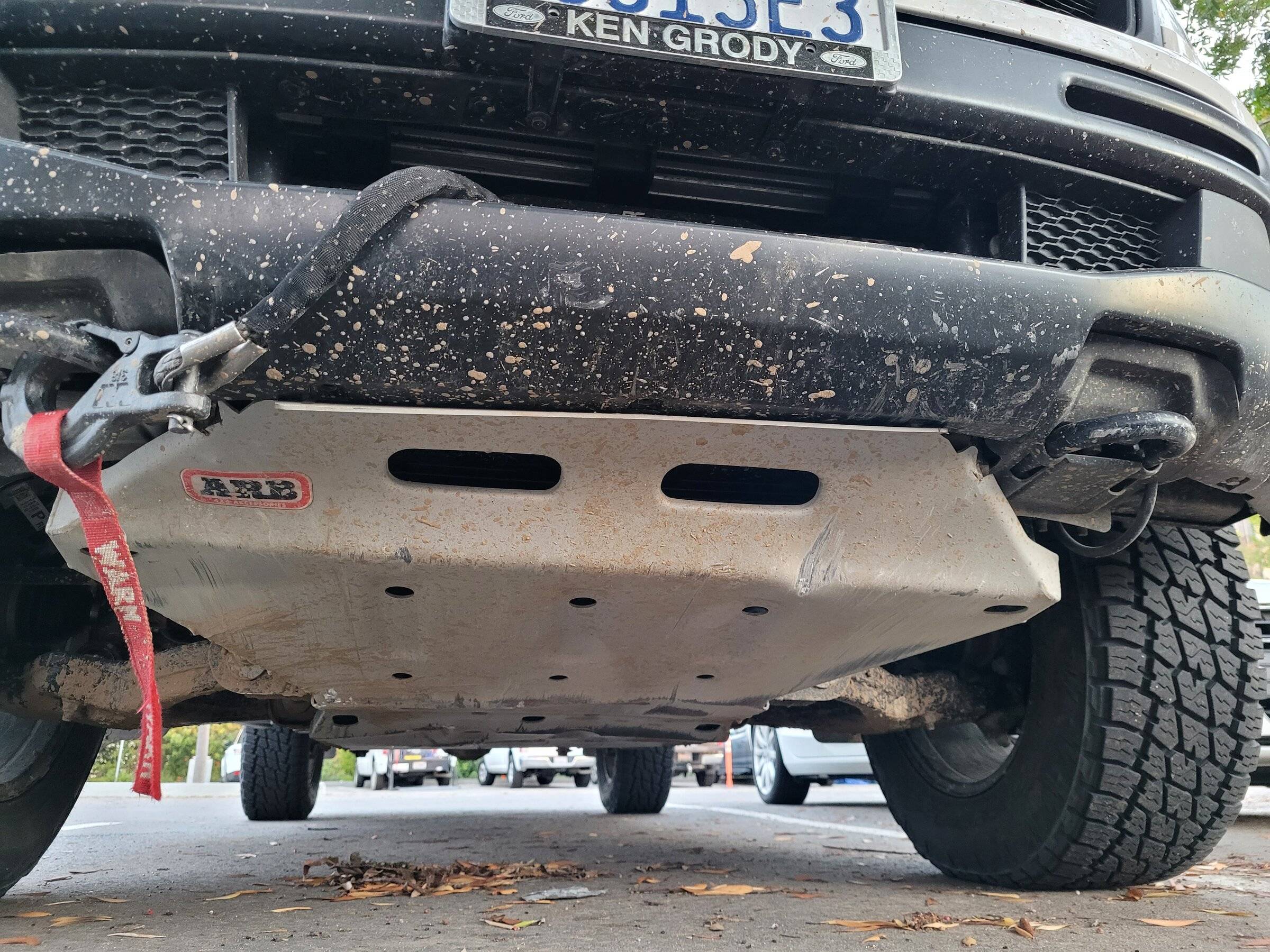

Do you have pictrues of how you modified the skid to work with your 589 plate? I have the plate coming in and now I need to modify my ARB.
Hey @Colo_Ranger post #93 on this thread has the best pictures of my install. I ended up grinding the corners of my 589 mount near the lowest bolt hole and cutting a notch on the ARB plate to get it to fit..
However my plate also had a few dings on it by that point, so it was a Lil warped. With a stock ARB plate you might have to grind less.
Hope this helps

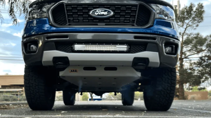

For the FX2 trucks with which looks to be an skid plate, but is mostly fake(shame on ford!) the ARB Full kit will mount up correct?
sklnbnz
Graham
Mar 11, 2021
102
315
Arizona
2020 Ford Ranger XLT 4x4 Sport
Should not be any issue with it since it's the same frame.

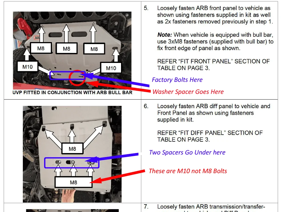

I installed mine this weekend. No lift and no helper. Used a Pelican case to prop up the plates since they are a bit heavy for one guy to lift up alone while crawling under the truck.
Made some notes on the install sheet attached due to some omissions and misprints. Will figure out the Oil Plug situation closer to my oil change time.
So I'm missing the factory bolts on the front skid. I sold my FX4 skid and all hardware that came with it prior to picking this up. Can anyone link me what I need to purchase? Just 2 bolts right?
Seems like it's the below. As the holes fit the largest bolt in the ARB kit.
W505443-S439
https://www.fordpartsgiant.com/parts/ford-bolt-hex-head_-w505443-s439.html

If I recall... All the Front skid bolts are the same thread but don't quote me on that for sure... See a Parts Department guy for the actual spec on the Skidplate Bolts, or if you have a buddy who will let you pull one for a couple hours, pull that out and run it to the store and get the right one!
