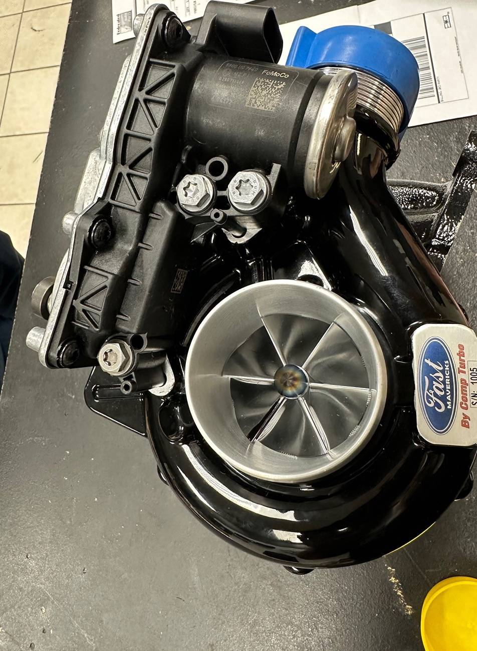

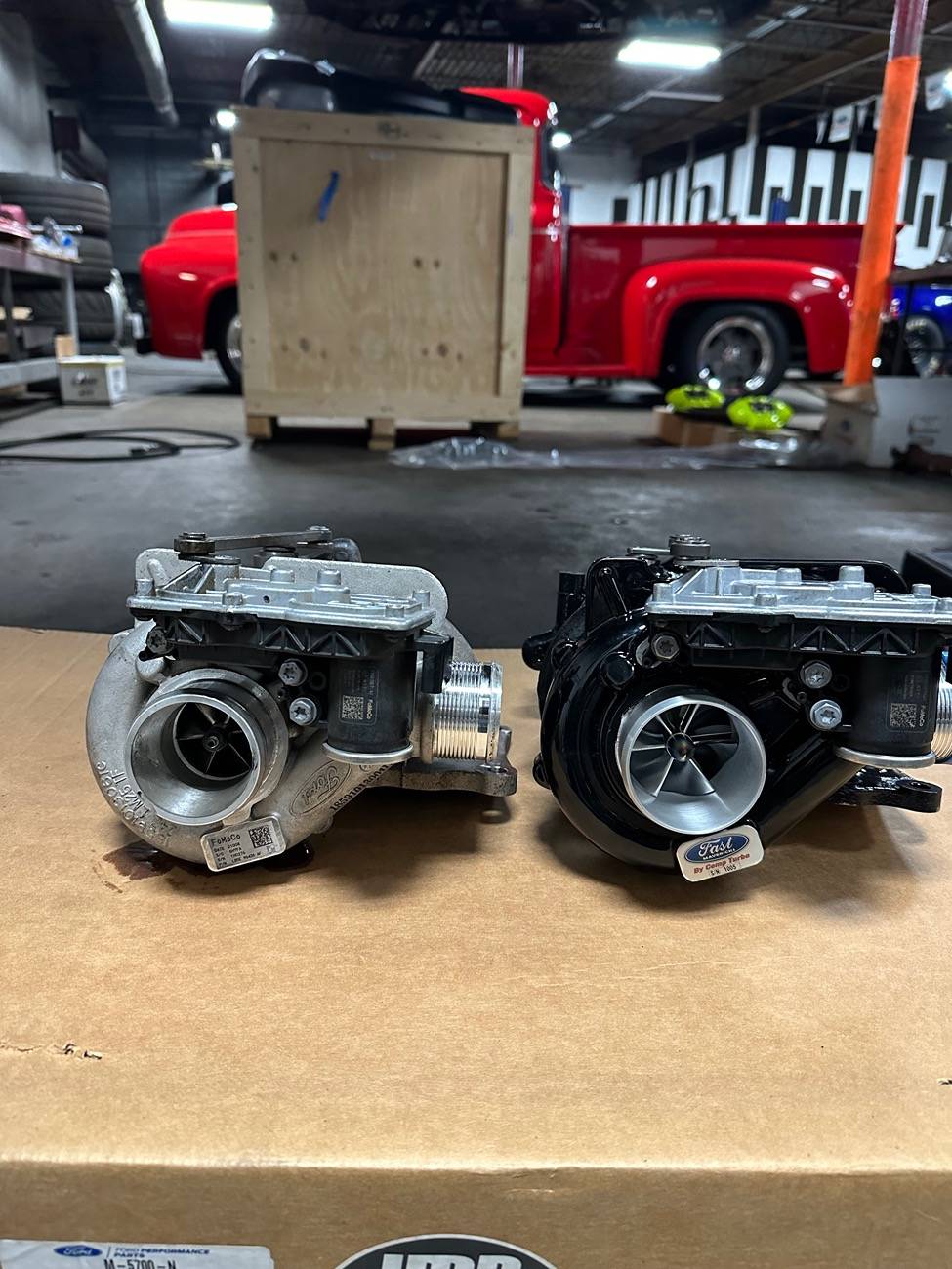

What difference does the 9 vains versus the OEM make? Inquiring minds want to know.
The whole compressor wheel is bigger, it’s a larger wheel with more vanes. The housing is machined to accommodate it. I have something similar in mine.

Vane count can impact spool speed and rpm range for optimal power. More vanes spool slightly faster but have more mass and can run out of efficiency quicker. Less vanes take a second to get going but have better top end efficiency. Unless I have that backwards. Basically the meat and potatoes, been out of the modified turbo world for a bit.

More turbo vanes more better!
I had assumed more was better! I was hoping there was a reason it was better, but maybe that's all there is. ?

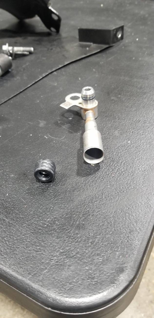

I didn't get to drive it very far I developed a coolant leak, there is this weird slip joint on one of the coolant lines and decided to play it safe for once

okay second drive impressions, this turbo is great, the turbo whistle and blow off valve noises make for a fun test drive and the response feels close to a stock turbo I highly recommend it, I will be doing some data logs in the next few days and will post about the findings, Work Turbochargers claims the 52mm compressor wheel is good for 500 crank HP
