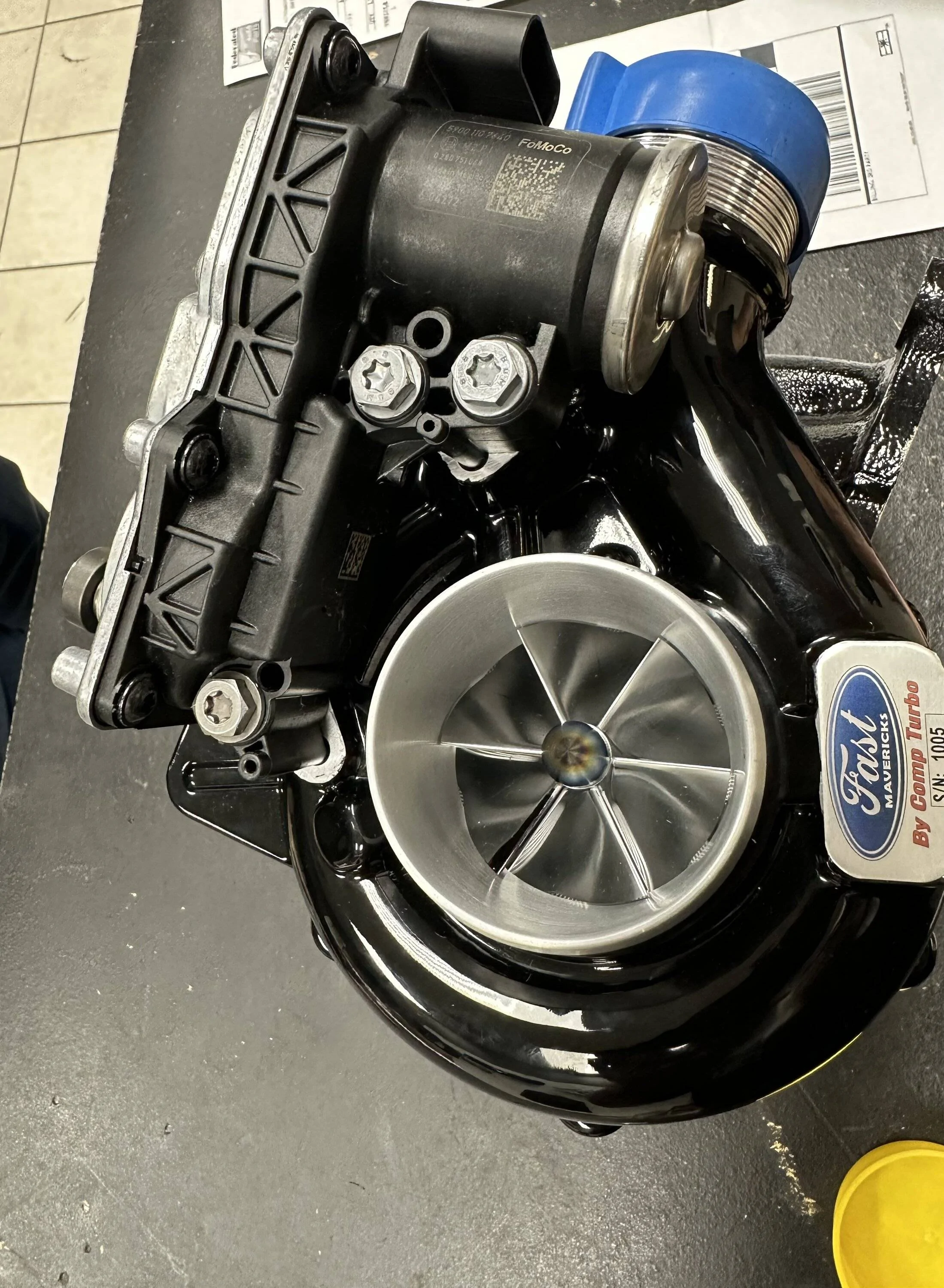

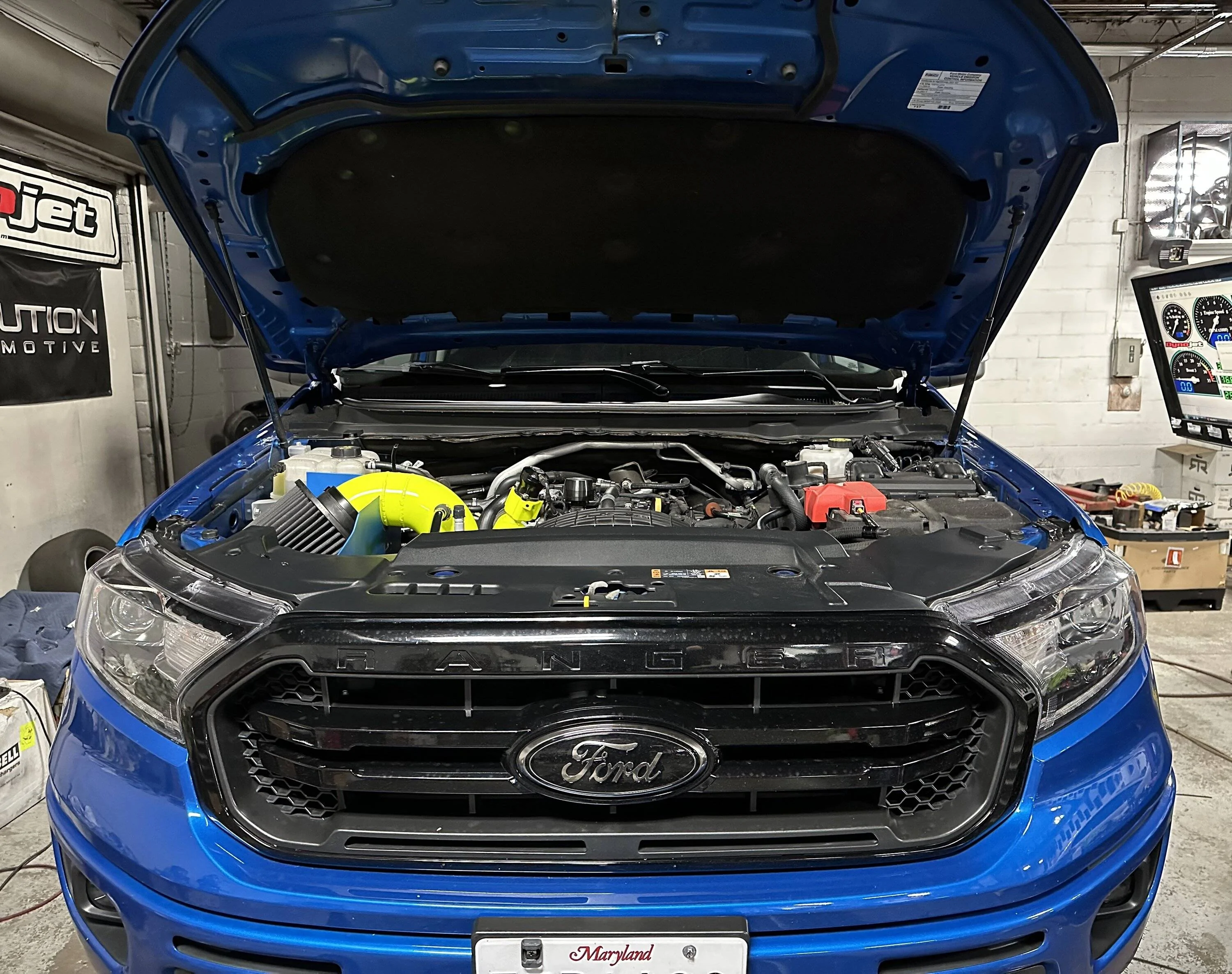

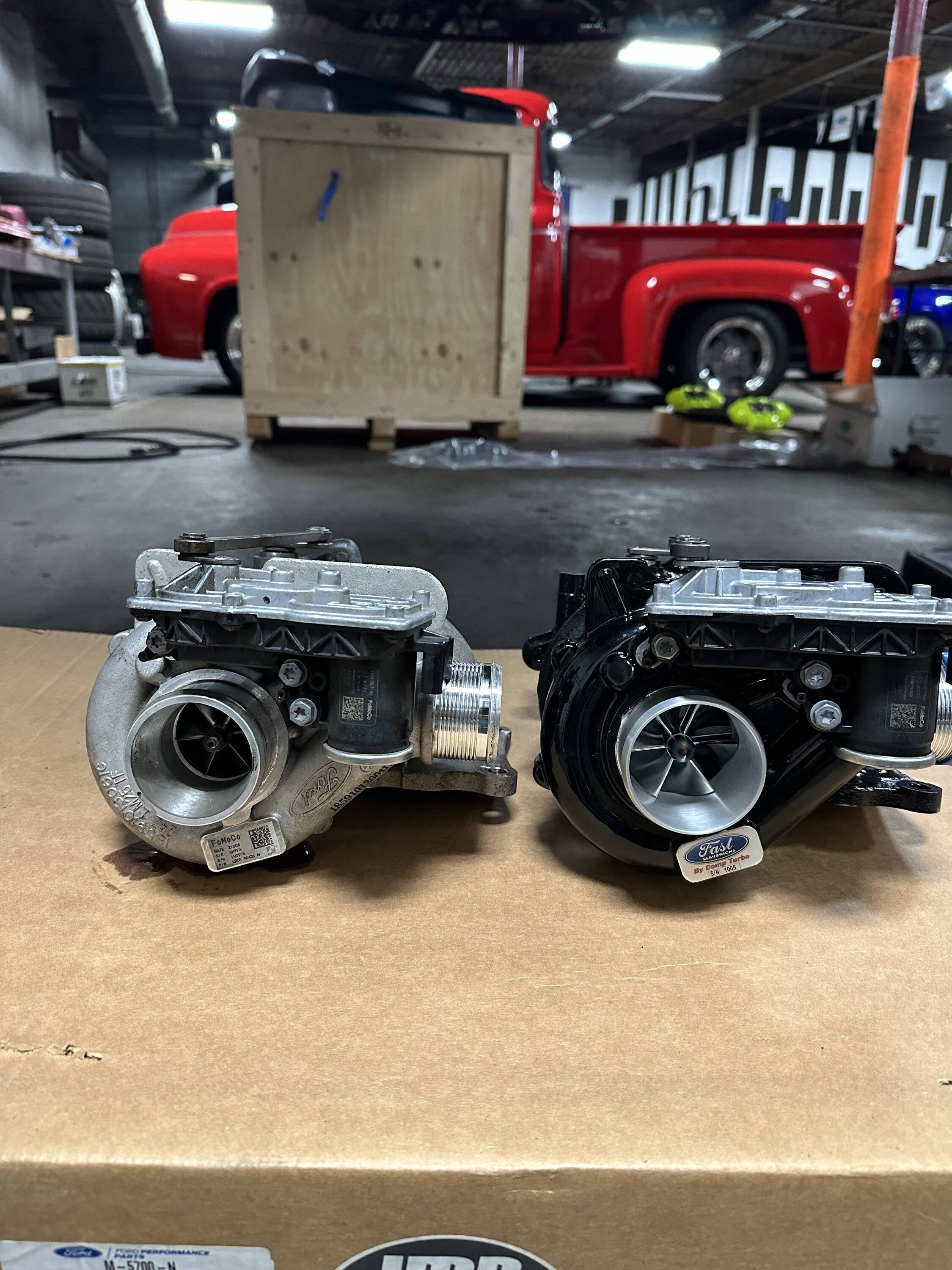

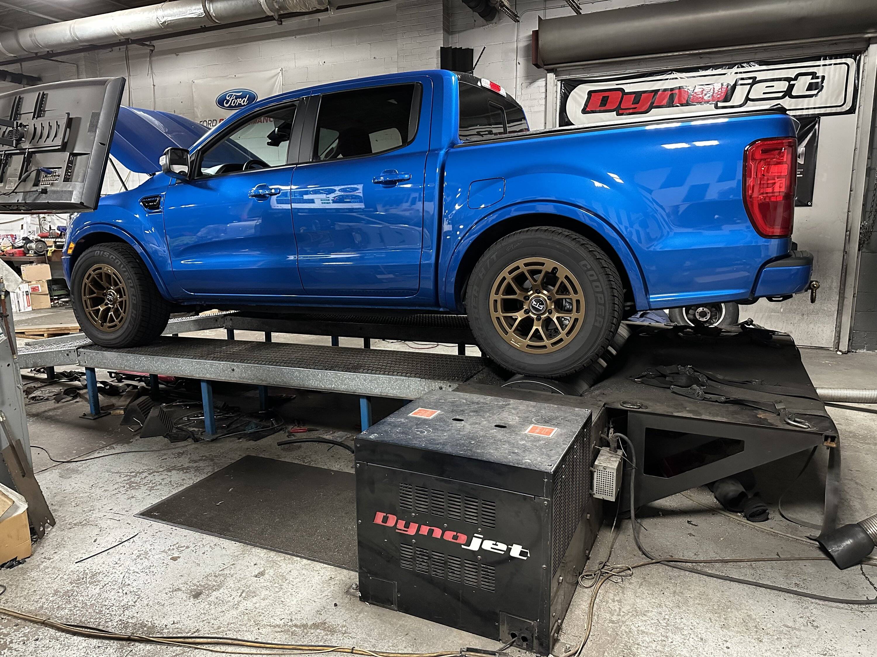

I have a Fast Mavericks 57mm upgrade. I am fully full bolt on with some custom made parts as well. You will probably want e30 if you upgrade the turbo to even benefit enough. The stock turbo is able to make more power than 93 octane can support as it is.
