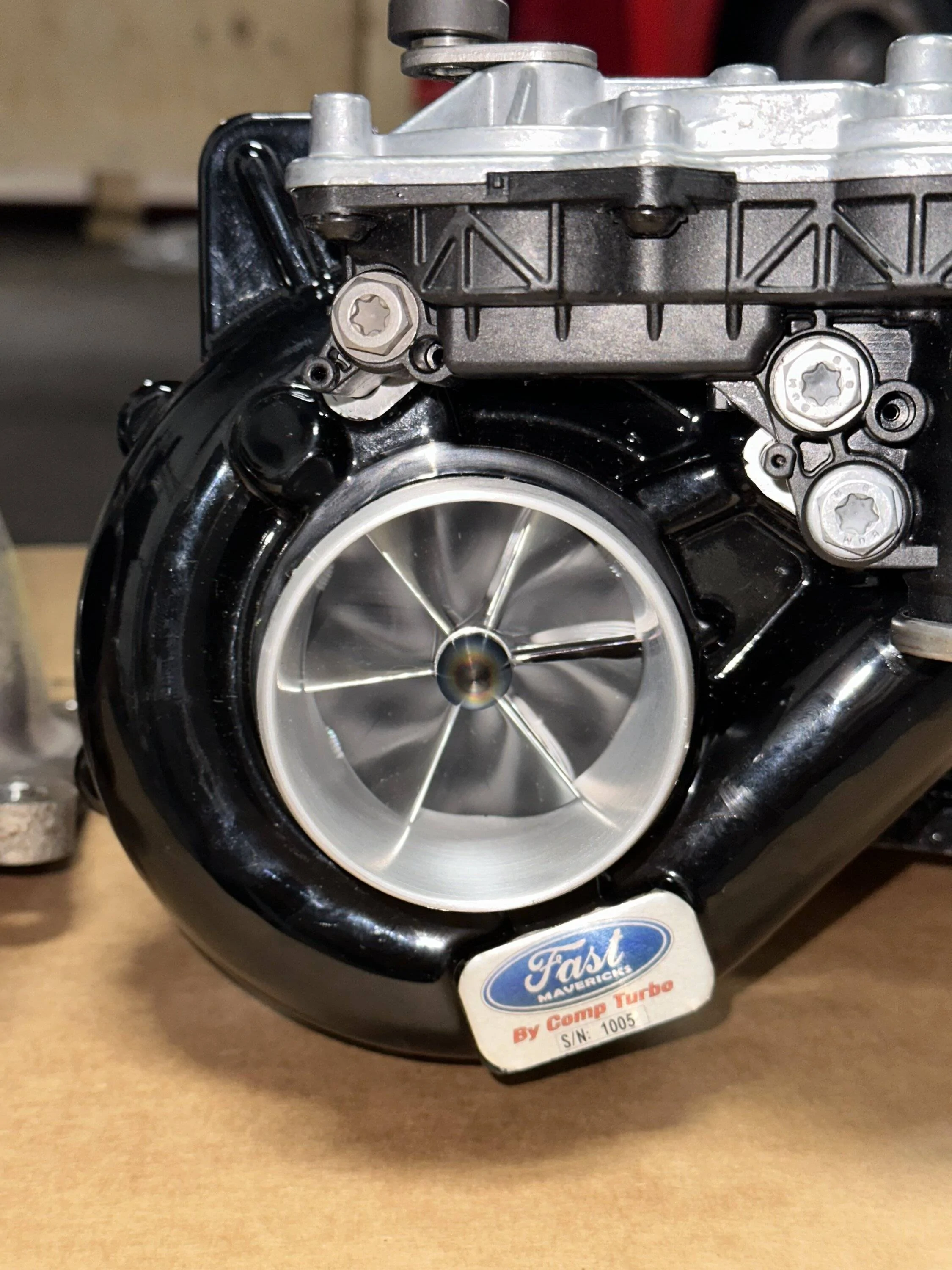

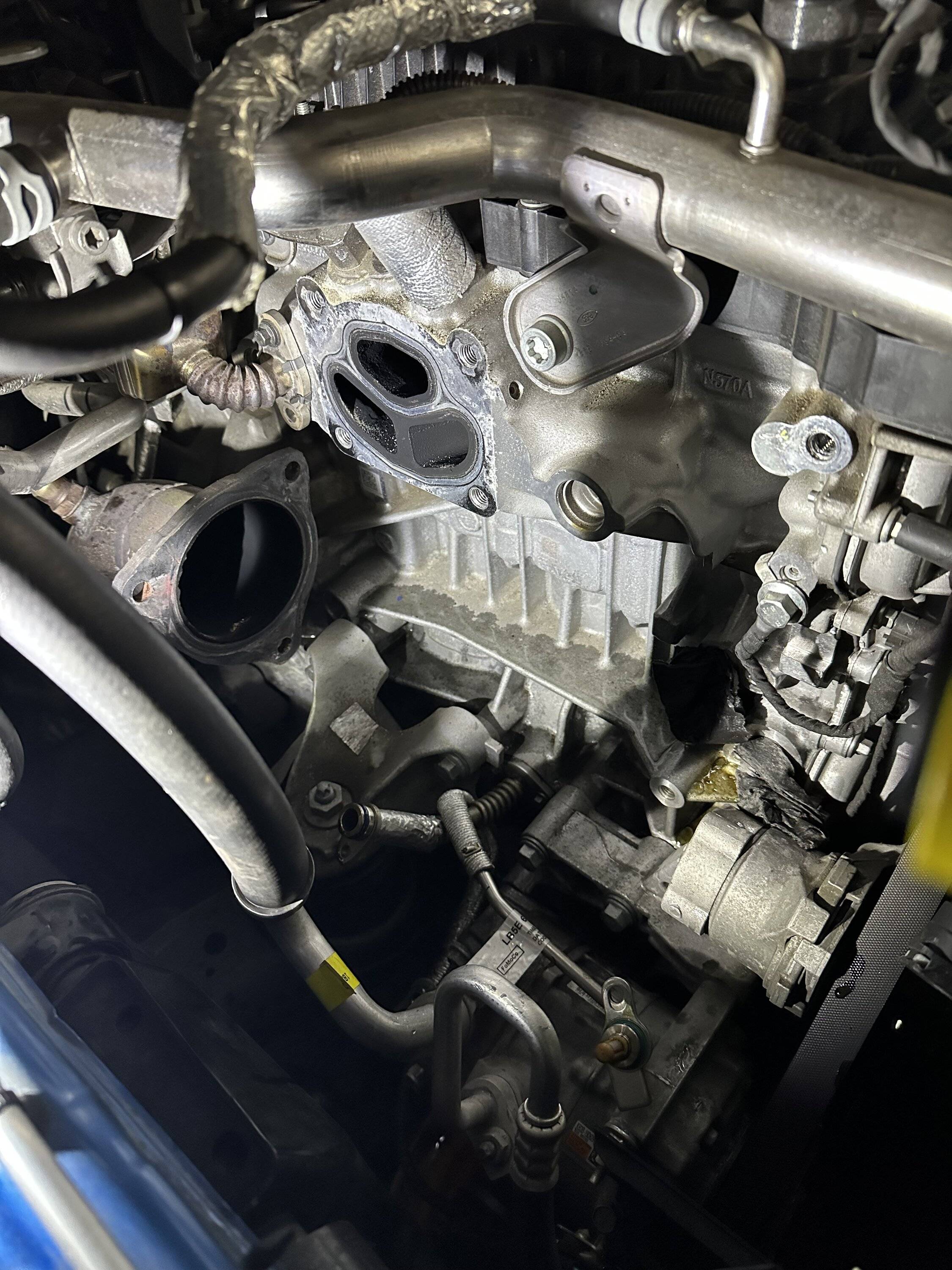

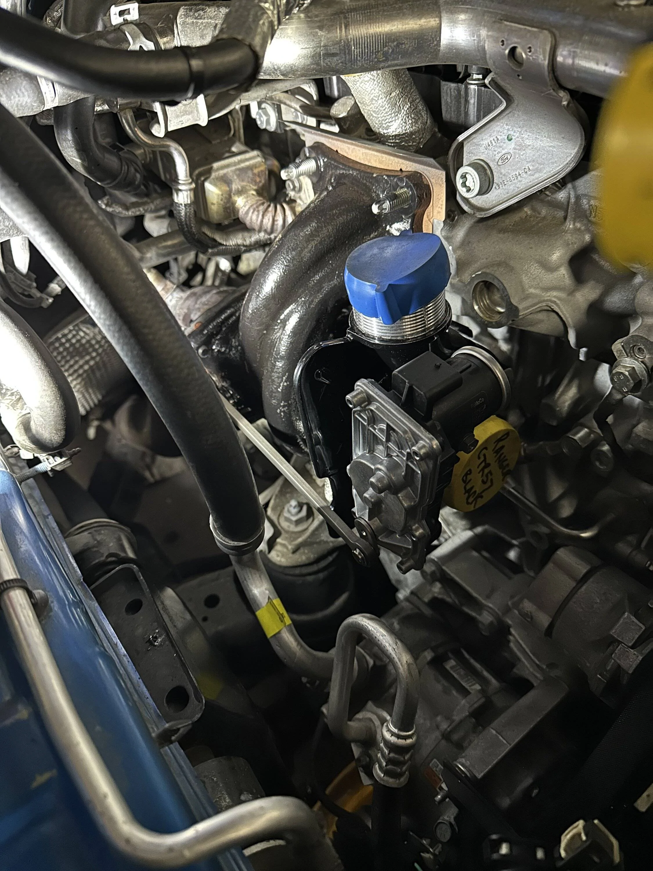

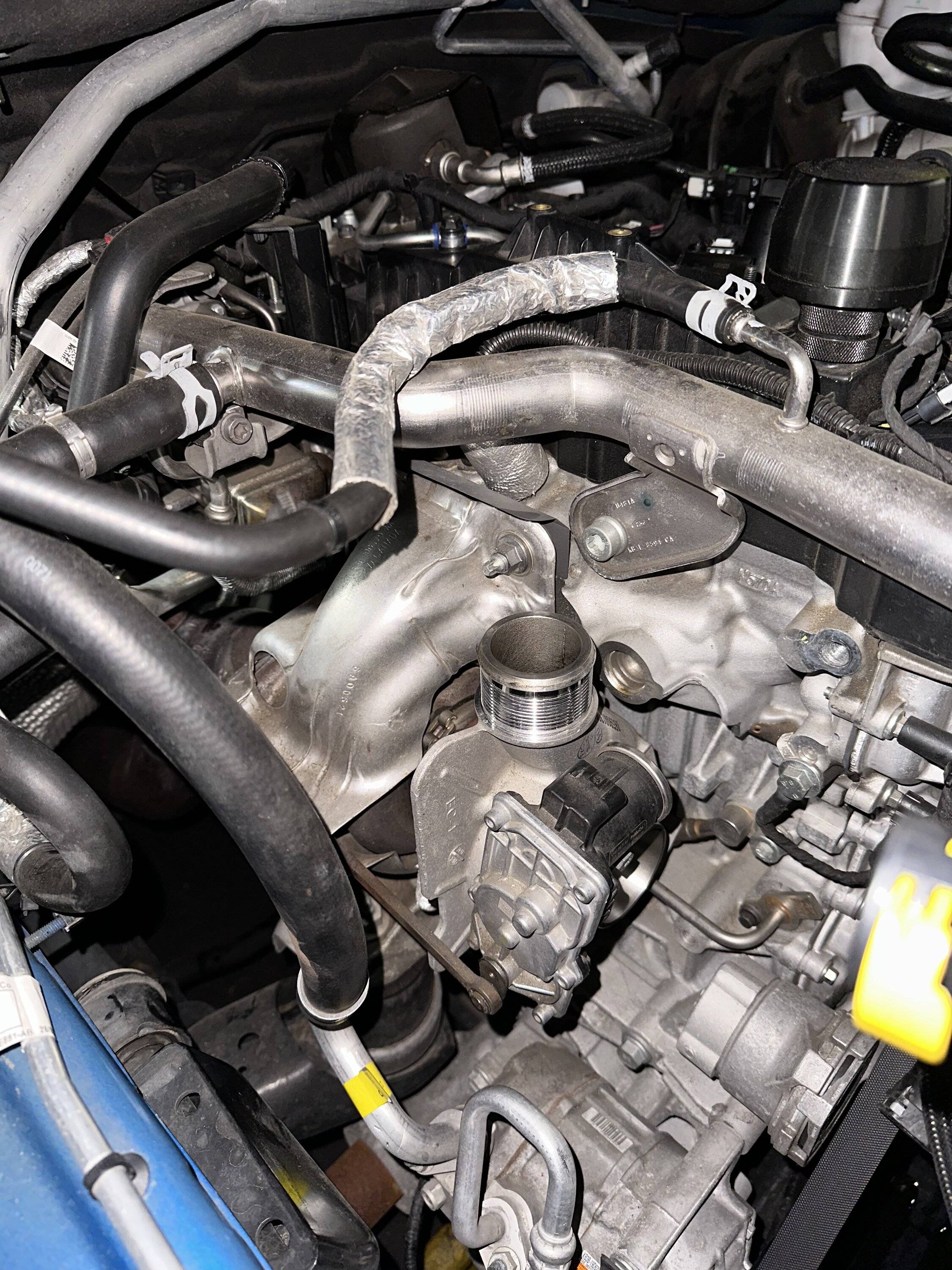

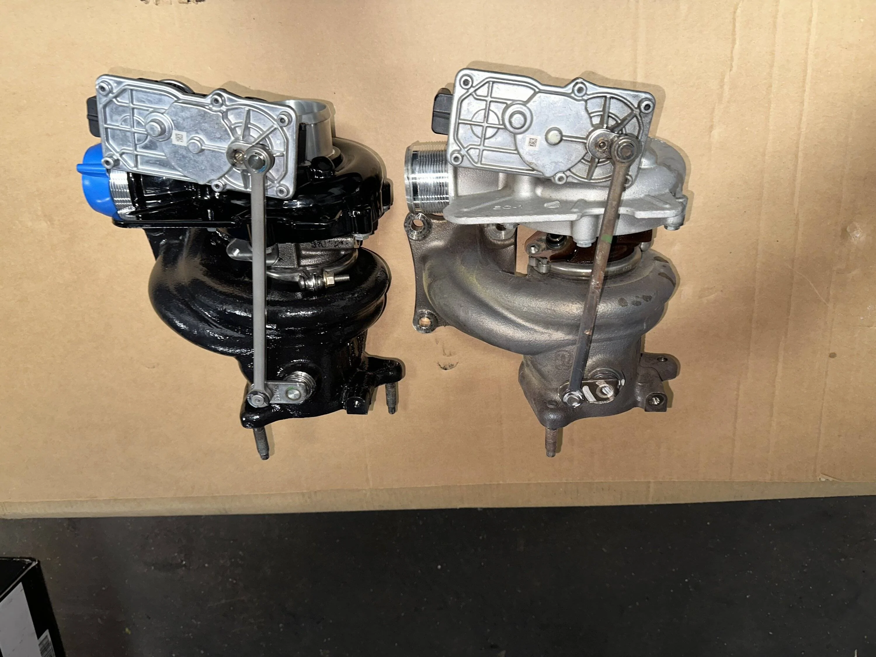

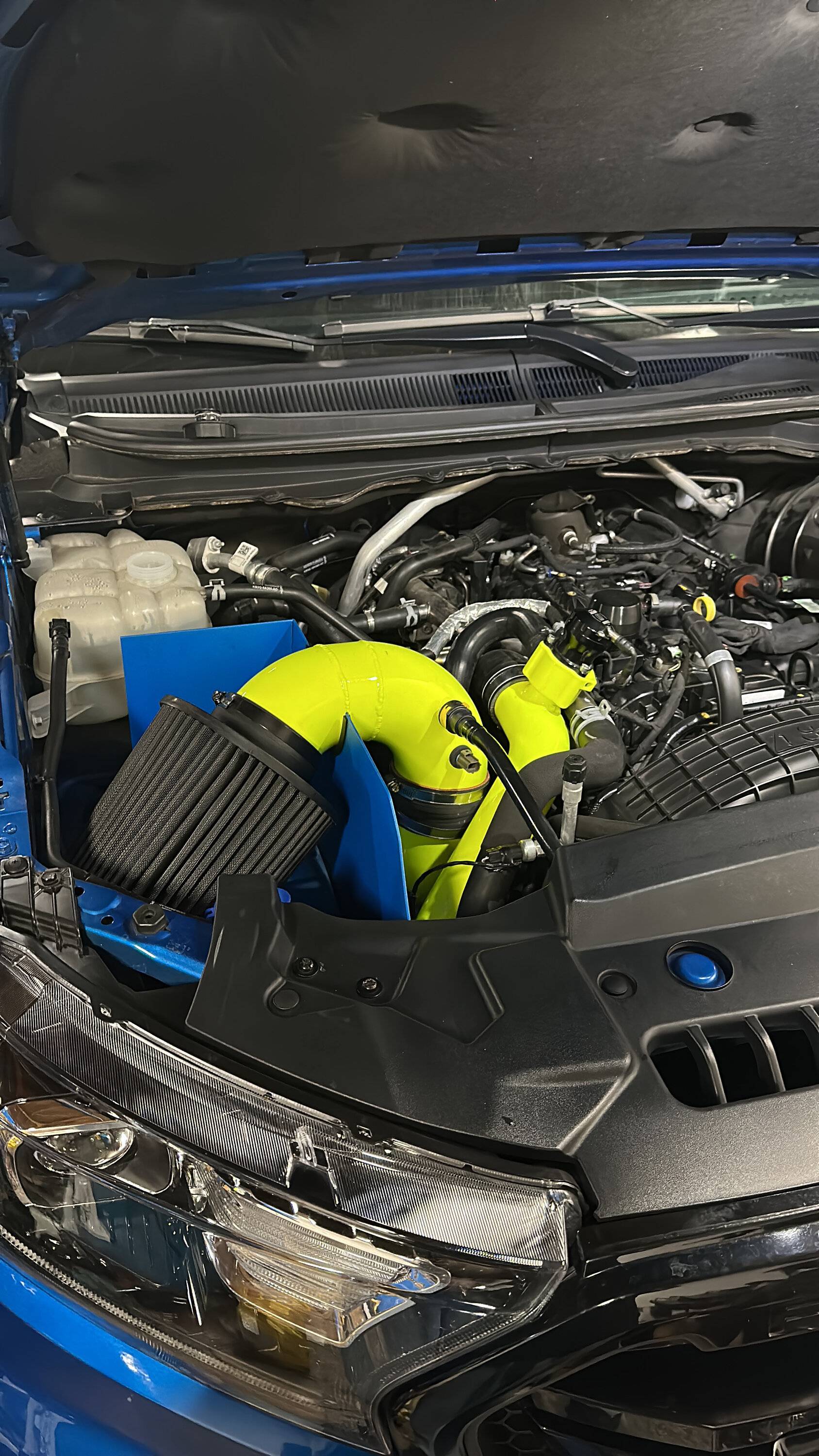

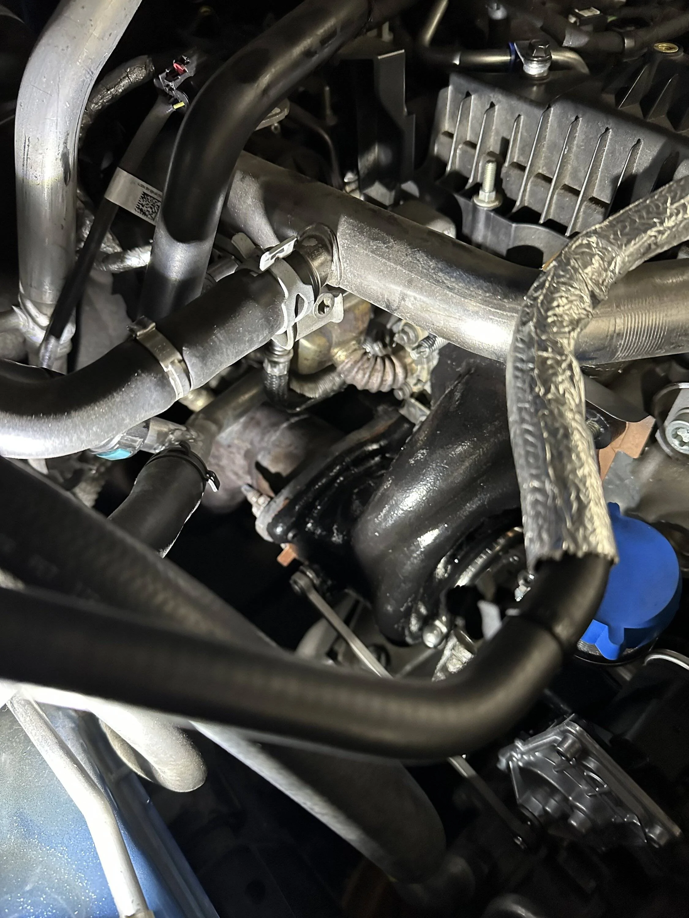

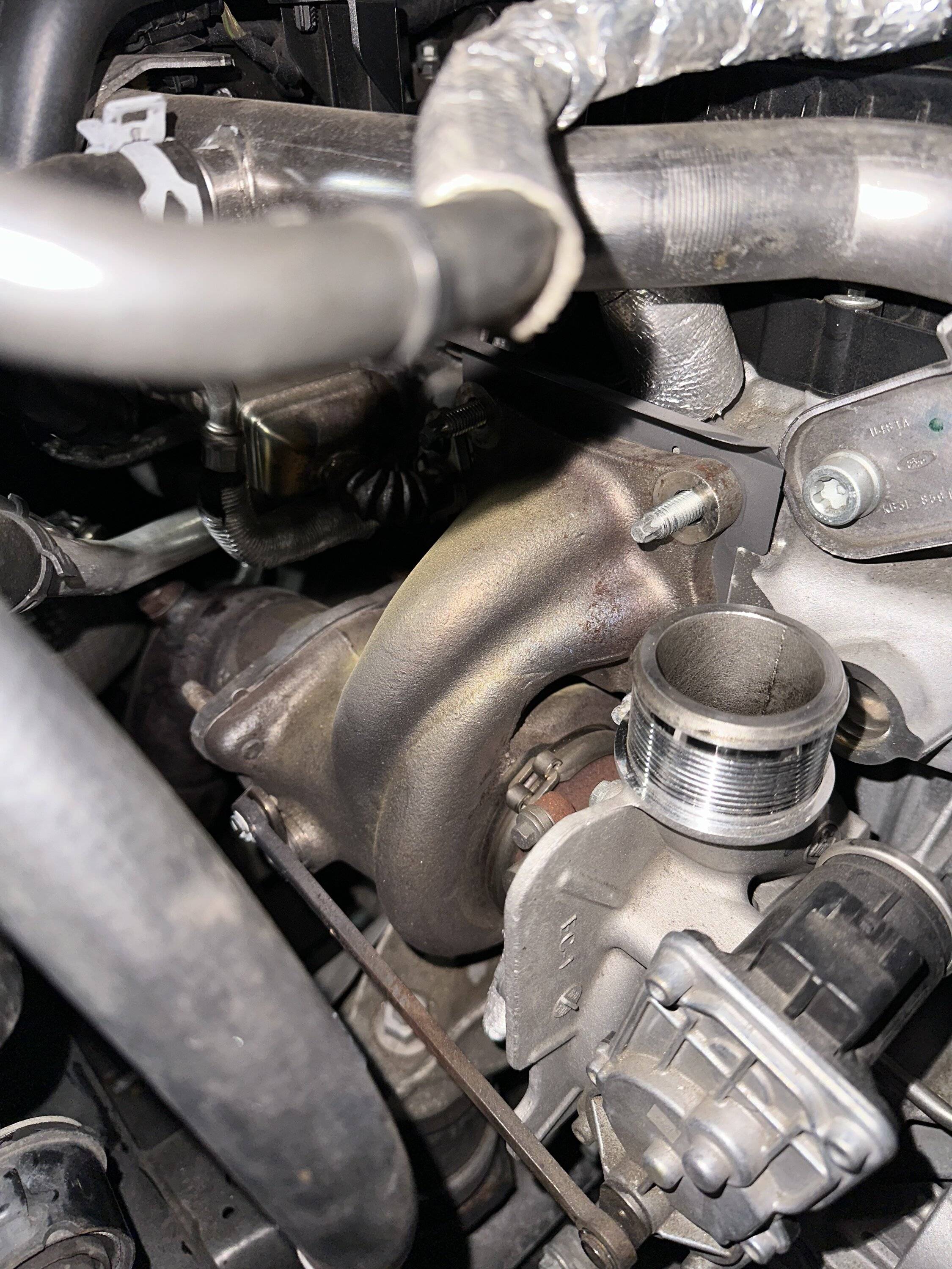

So I put my Fast Mavericks upgraded turbo on this evening. Definitely a different driving experience than before. It is really strong and I haven’t even floored it yet. It makes a lot of turbo noises too, especially with my intake on it. Gotta look at data tomorrow and see about a tune revision then we’re flooring it and more data. Hopefully dyno very soon. Currently on E30. The install was straightforward and took me about two hours while taking pictures along the way. I never even jacked it up.

Not heard of fast mavericks. What's the difference between it and stock?

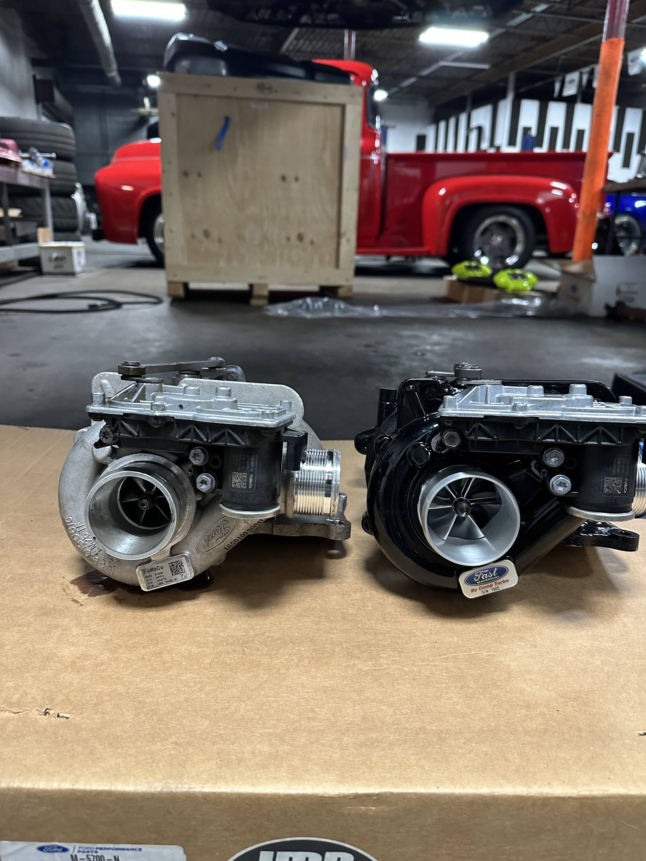

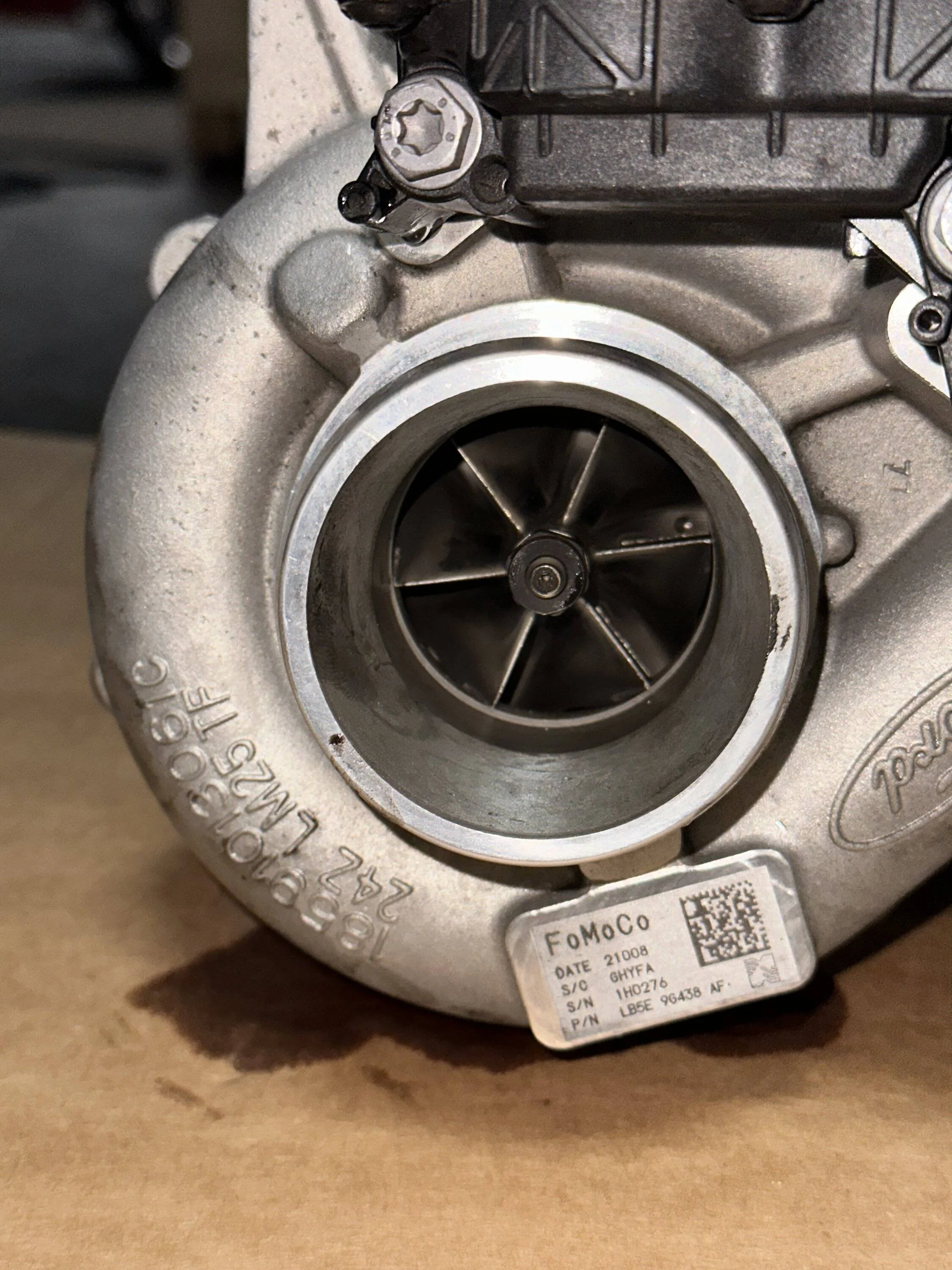

He’s got a 2.3 swapped Maverick. He sells them directly but the wheels are produced by Comp turbo. This is a completely stock, brand new turbo from Ford but with a larger billet compressor wheel and machined compressor housing. I need to drive it more to get a better impression but so far I’m impressed.

Very nice and congrats on a successful install, Mike! Bet all kinds of noises will be gushing out of that whale penis intake now 😆
Speaking of which dynos will be forthcoming of this new turbo setup I hope 🤞
It actually took the squeaky sound away and replaced it with lots of new noises.
Dyno baseline pulls on 93 and e30 tuning
were done last Friday, gonna do some street tuning then back on the dyno at the next opportunity. I’m hoping a few days but we have paying cars to tune too.
sound up on the video, that is on the tune for the stock turbo and in the rain 😳

So, Fast Maverick takes stock Ford turbos and reworks them? Can you send in your used turbo for a core charge return to recoup some of the money you spent?
And I wonder if Ford will see those and issue a 'cease and desist' because the logo looks very much like Ford and the use of Maverick. Maybe not, as I don't understand copyrights and trade marks.
