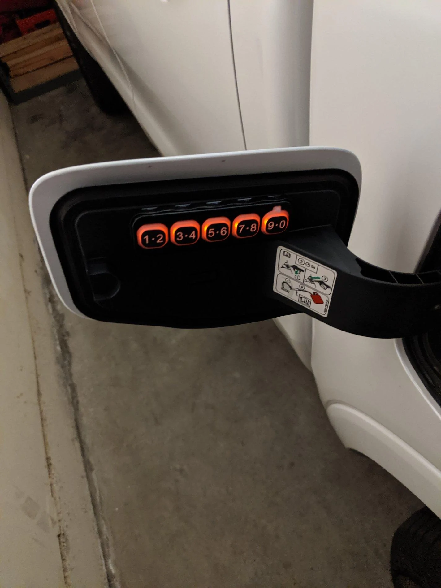

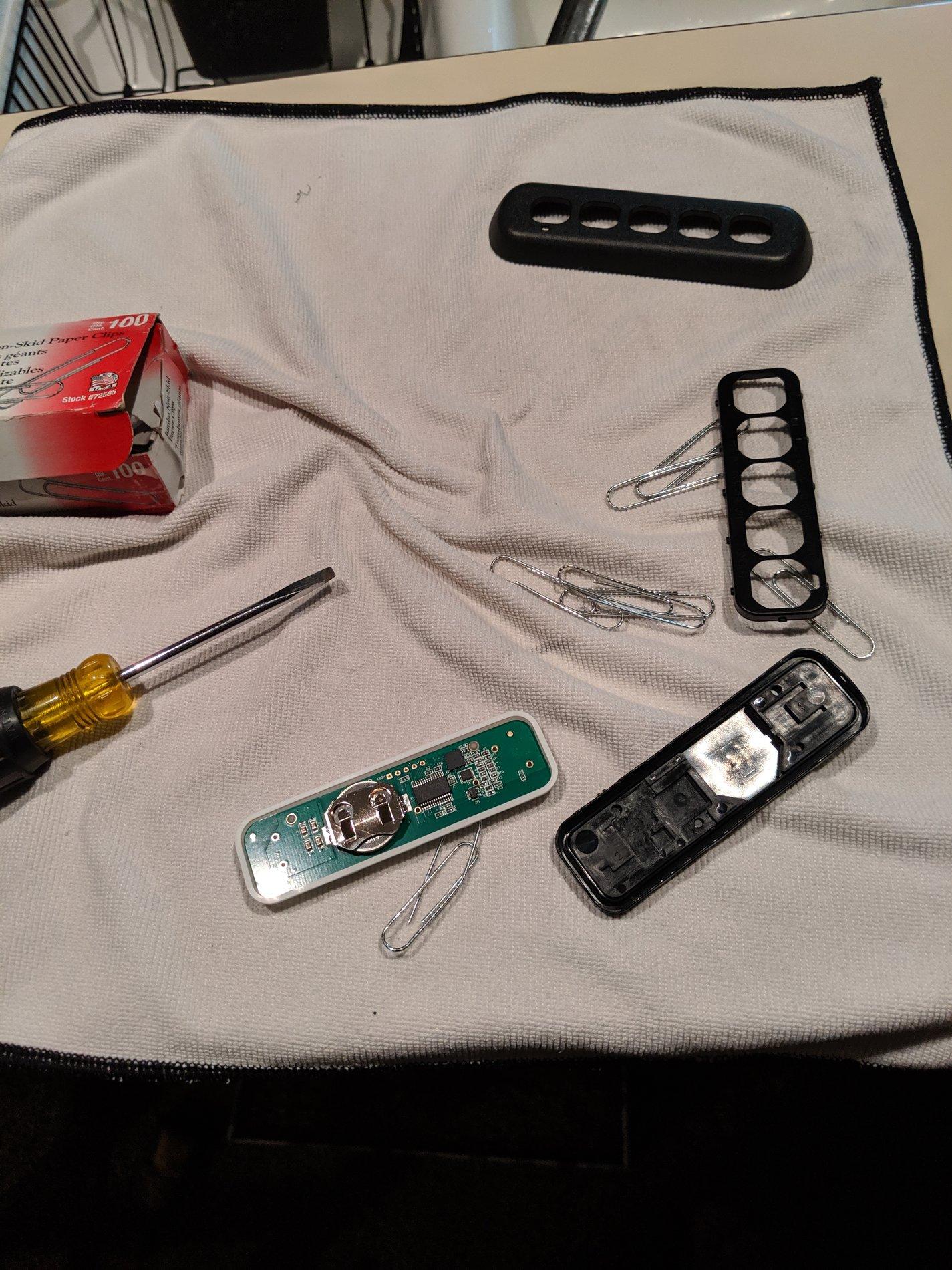

And now it's installed and working in it's new location. And to answer any questions yes it works, the memory held the code, it works from 50 feet away, the outside cover is just cosmetic and it still is protected from dust and water, nothing hits when you close the door (why I left the cover off). Used dental floss and turtle wax paint safe sticky remover. Best $85 I ever spent ha
Excellent spot for install!

My factory keypad has stopped working , and when a button is pushed the red light doesn’t respond. I guess battery is already dead? How do you replace battery?
I had the same problem. You will need to remove the keypad (do this on a warm day- and gently pry off the double sided tape) then once its removed (note: no wires are attached to the truck) then pop off the housing, then unclip the housing. the battery is there. replace and re affix with same type of tape/
This is a brilliant Idea! I will copy this...if you don't mind!!!!

A new keypad has been ordered. Ford says battery can't be replaced, but obviously they can be. May use gas door option also. I hope these batteries aren't a common issue. Mine didn't last 2 months.
Well, if they didn't somehow protect the battery after it was installed, it is possible it ran out just sitting on a shelf. Many things now have some sort of plastic piece you need to remove in order to activate the battery to protect against that kind of thing. I will be interested to hear how your second one goes.
The battery is a key fob battery and should last a pretty long time unless it keeps transmitting somehow.
Excellent location, Very creative! Did you leave the outside cover off because the fuel door wouldn’t close or just for convenience, changing battery etc?
And like asked before- Can we program these ourselves or do we need to take it to the dealer for programming. I’m all over this if I can program it myself.
I left it off because I didn't think it would let the door close properly and because I liked the look better. Also for convenience now that you mention it
