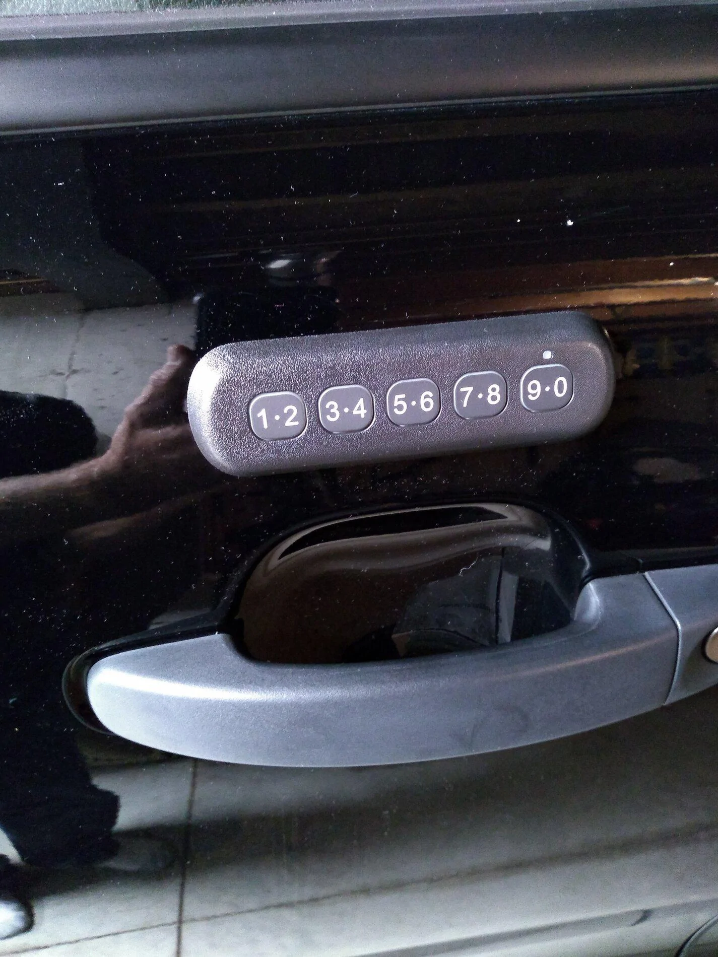

I just bought a new 2019 Ranger XLT Super Cab. After getting the truck home I noticed there was a keypad on the driver side door. The salesman didn't mention anything about it. I did a little research and found that it is probably wireless and to install a new code I need the factory code. I believe I should have a card with the factory code printed on it. I called the dealership and talked to the salesman and at first he said he didn't know my truck had that option. Later in the conversion he said he put the card in the slot in the user manual folder. Anyway he didn't seem too interested in finding the card and insinuated maybe I lost it. Just wondering if the techs at the dealership can retrieve the factory code some how.

Just so you know, those are just stuck on with 3M tape. If you don't end up using it, you can just use floss or fishing line to strip it off. They are known to have battery issues and usually have to be replaced instead of new battery installed. Not worth the hassle IMHO.

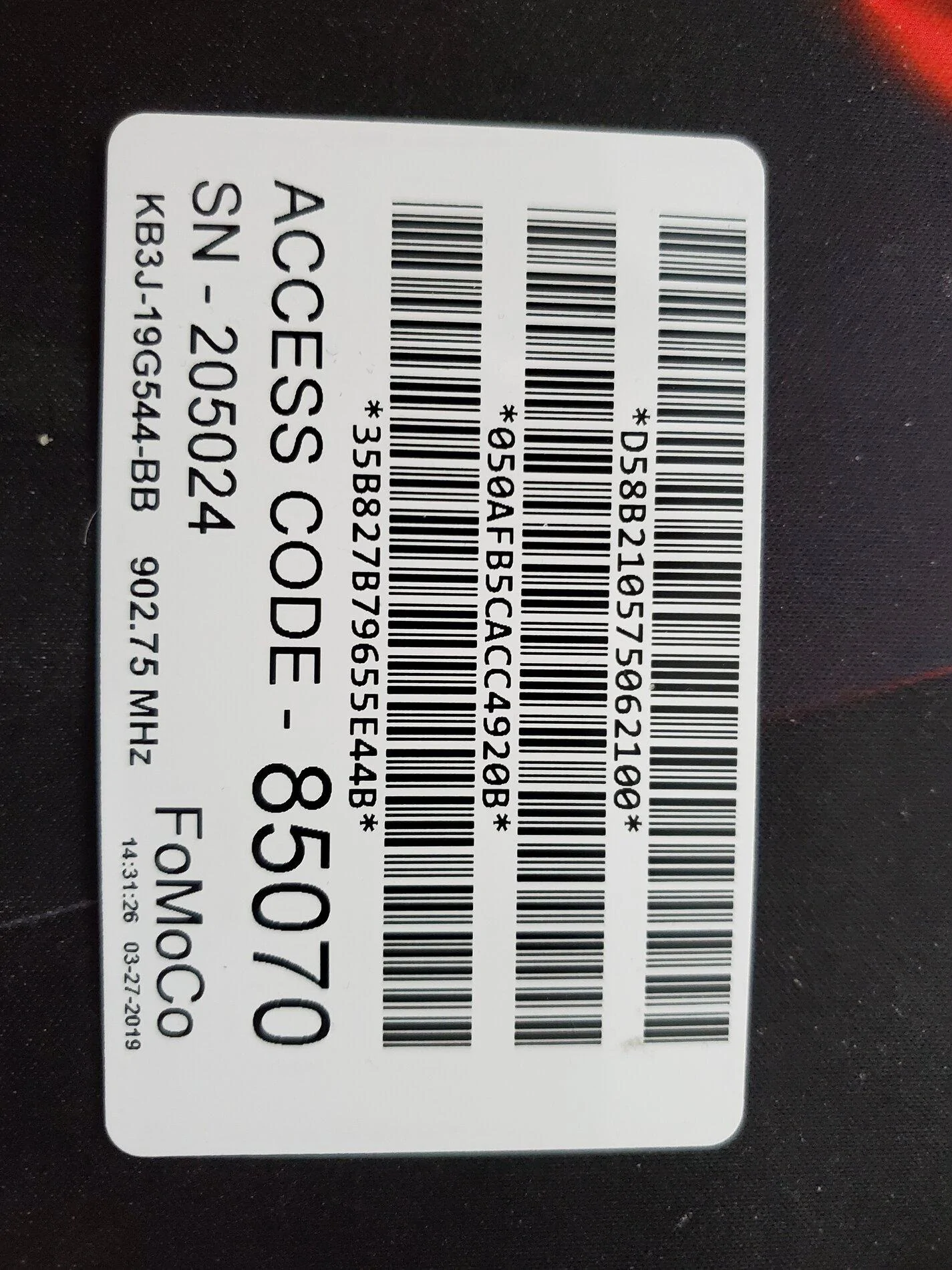

If it's factory it would be listed on your window sticker.
When you press any buttons the LED above 9-0 should light. If not it's dead and needs to be replaced anyway.
Mine was in the slot in the owner's manual folder. It's not real obvious what it is. Here's what the card looks like:
