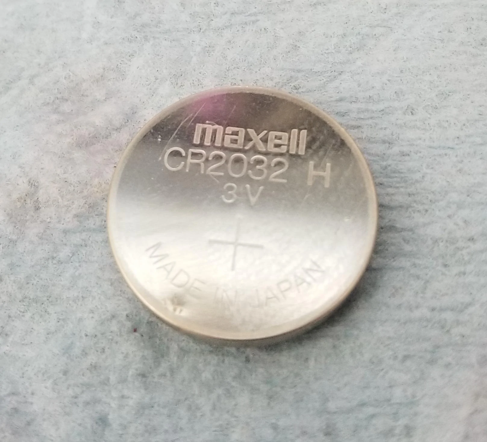

Okay.. here are the results of my factory installed keypad that failed.
#1 dealership couldn't find a wiring diagram so they kept dragging their feet for me to bring it in to fix.
#2 I carefully removed it from the paint.
#3 It is in fact, a stick on device
#4 volt meter found a dead battery.
#5 replaced battery and restored functionality.
#6 Easy process, and did not hurt the paint- i removed during full sunlight (heat).
#7 used 2 inches of Scotch double sided tape to reaffix.

Update: after replacing the batter and having not installed it (sitting upright on workbench) The battery is dead again after 23 days

Same here. I pulled and replaced mine (with dental floss) like you did and a few days later it was dead. Volt tested the battery and it was 0. Put in a second fresh one at 4V and after a few days it was dead too. Must be an open circuit in the circuit board draining the battery since the keypad has gone through the factory battery and two more. Frustrated I have to now go through the warranty process at the dealership, waste of a day.
However I was able to relocate it to inside on the gas door. Fits perfect and works great (while battery was not dead). I posted the pics on another thread.
