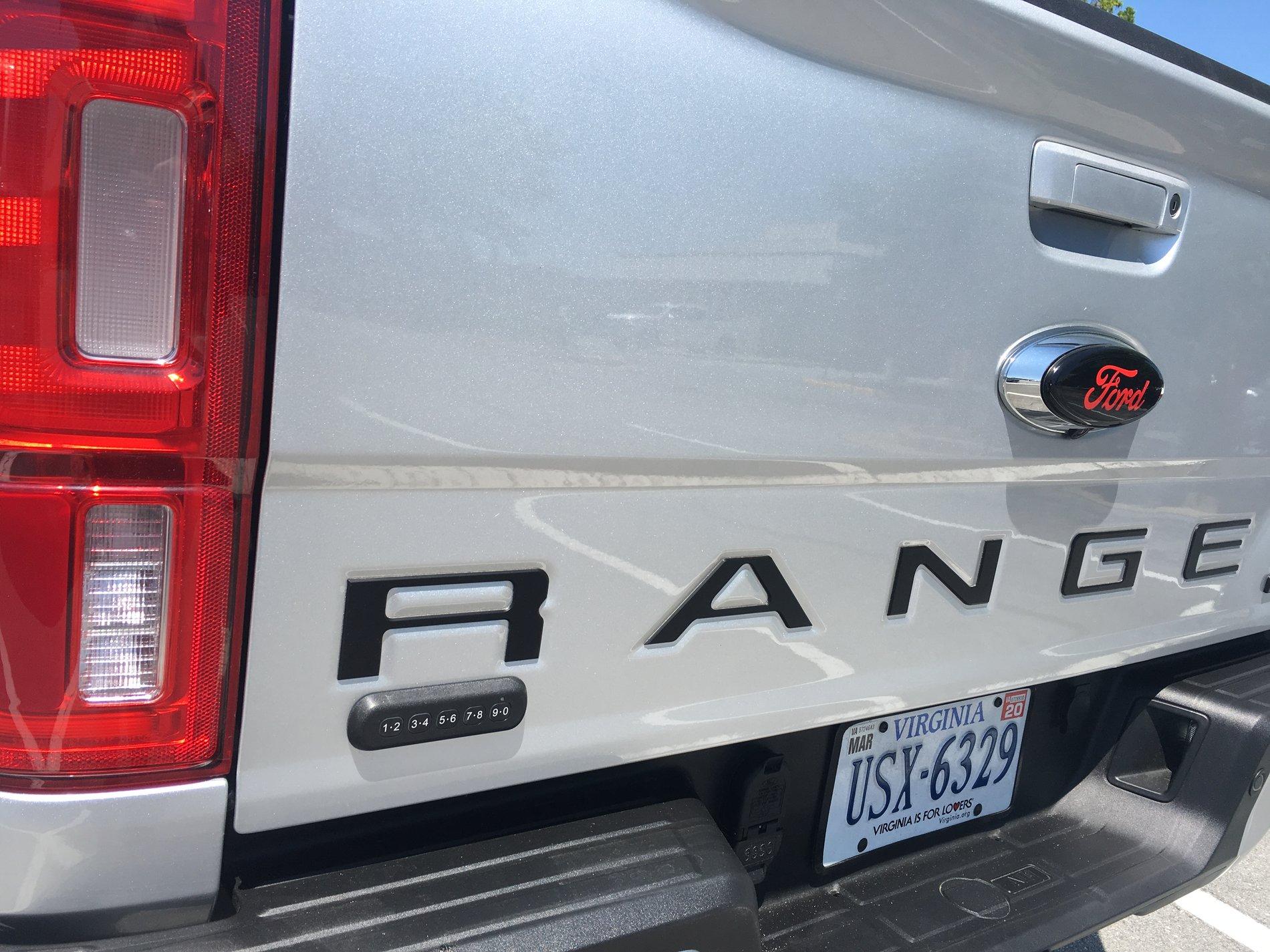

I got the aftermarket. Stuck on the back. Gonna move it because it’s so ugly! But it is convenient on the back for loading things in the locked bed. I might move it to the right of the license plate on the black part under the key slot for the spare tire. I tried there first but it wouldn’t stick.
It definitely looks best hidden in the gas cap! I had to have the dealer to the initial programming. That was a rip off. Waited more than an hour and $75.
