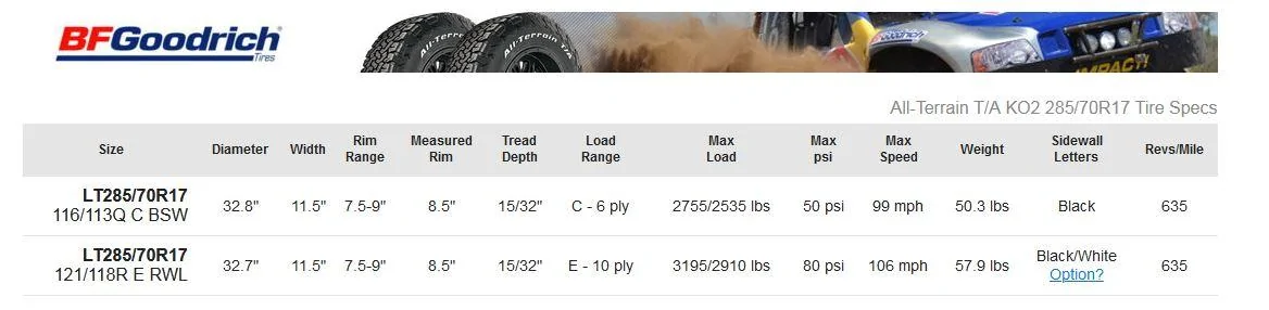

Have you looked at the BFG K02? They are one of the lightest LT tires in a 285 weighing in at 51 lbs.
what load rating? KO2's just so dang expensive...

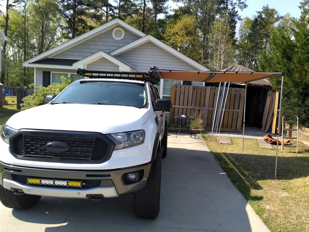

Here are my 285's, I have the Ford Performance/Fox level kit, 1.5" wheel spacers and BDS intrusion beams. No issues at all with rubbing.
did you remove the front back ones? i plan to to do the bds beams also but was wondering if i needed to remove the back one

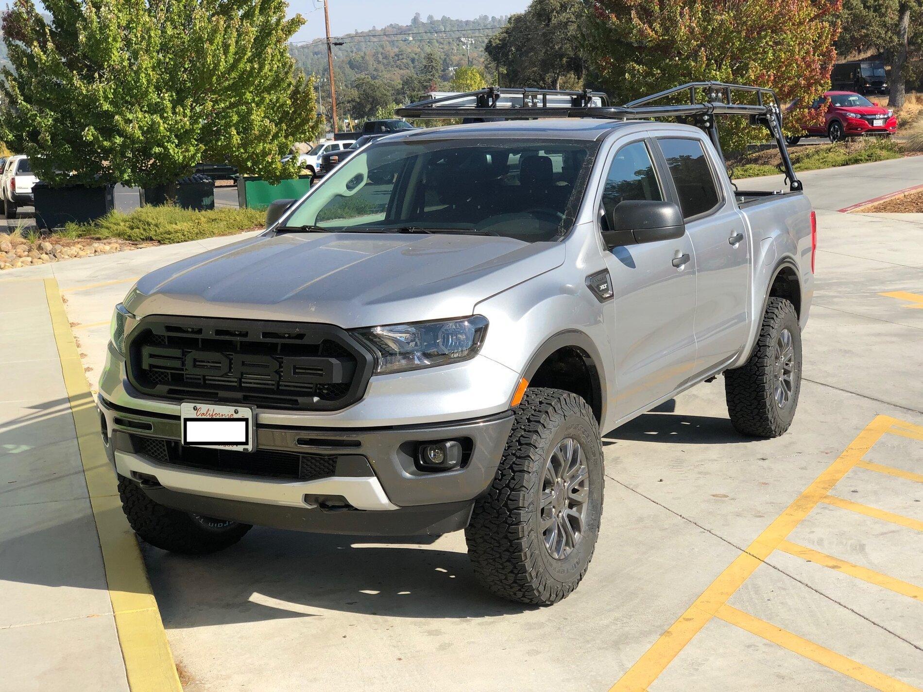

Best I can do looking through my photo folder. Basically with 0+ offset wheels the sidewall pokes out, but the tread appears to be inline with the fender flare.
How wide are the wheels themselves at 0 offset? And what flares? I forgot those probably help a little. They aren't the largest flare.
