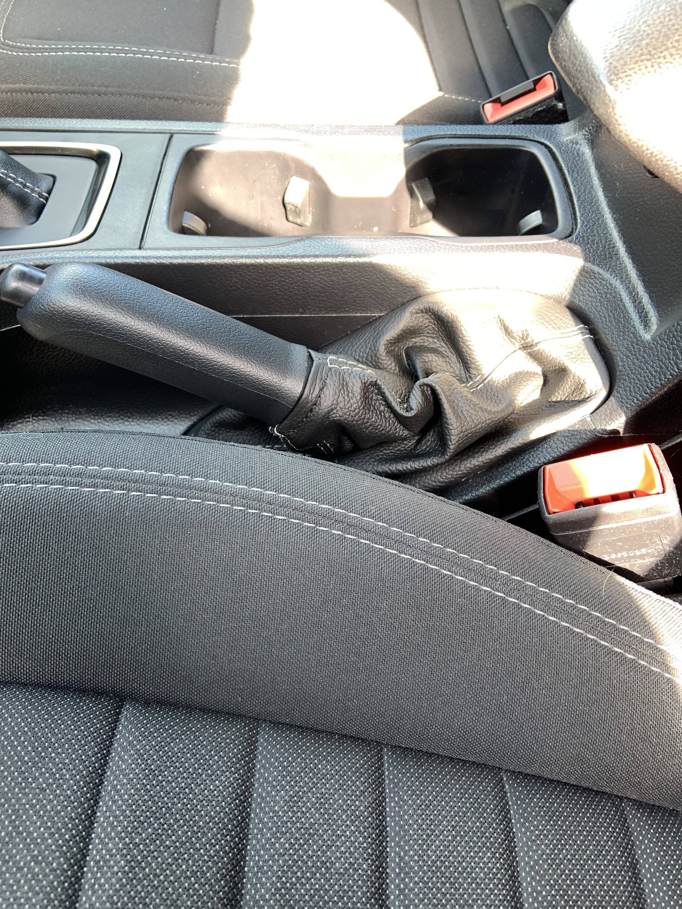

wife noticed my oem parking brake boot cracking a bit ago. decided to order the redline goods one. I got the slow shipping and it arrived recently. I will probably pull my old one and fit the new one to the frame this afternoon so the glue can set overnight.
I certainly appreciate when a cheap OEM part has better aftermarket replacements available, even if I've gotta pay for 'em. wife's jeep liberty had this issue with the power window mechanism. an important wear part inside the door was plastic, and that plastic would disintegrate after awhile. but some dude on ebay made powder coated steel replacements, which we found after jeep's oem replacement part failed in a few months.
*5/15 update:
Installed my fresh parking brake boot today. the replacement one from redline was just a tiny shade loose on the plastic frame. I have a little bunching in one spot on the frame where I had to take up a little slack, but that's hidden now that everything is snapped back into place.
I used E6000 and clips as recommended in the recent vid and it went on easily enough. just had to fiddle a little to line it up before setting it aside to dry.

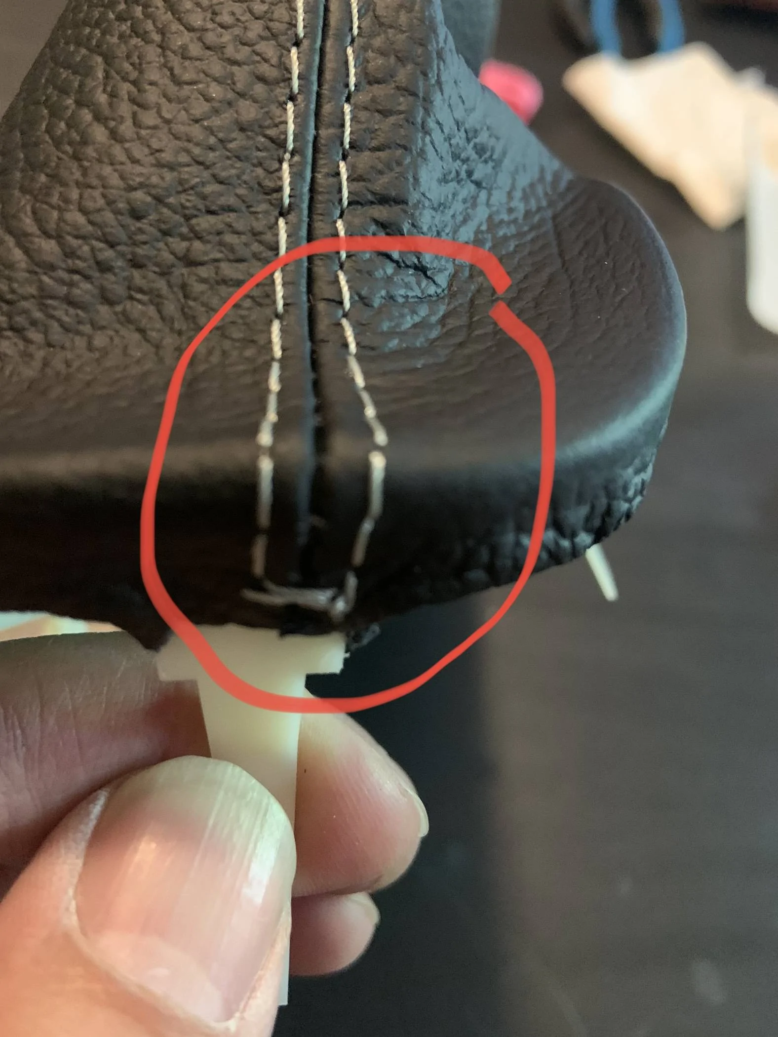

Yes. Most definitely will. I went with regular post so it might take a while -I was too cheap to get the quick delivery so it will be quite a few weeks away. But got the e6000 glue another member suggested- already to go just need the boot!
Update - got the boot way earlier than expected - by several weeks. I guess Poland post is better than Canada post for speediness. ?
On my 21 - ford decided to use staples to attach the boot on so it took a little bit more prying to get it off.
Overall the boot is pretty good. Took a little more effort than expected to stretch the leather and glue it. My only concern was on the single seam side at the bottom -it stretched a little more than I expected and was concerned the thread would give away in the future. So I added a bit more e6000 and glued it to the top edge of the frame (the horizontal part) to keep the seam splitting in the future. Never used e6000 but this stuff is pretty tough. Not sure if the picture is clear enough to show the gap.
But at the end it turned out pretty good. I am happy with it. It was a worthwhile purchase.
