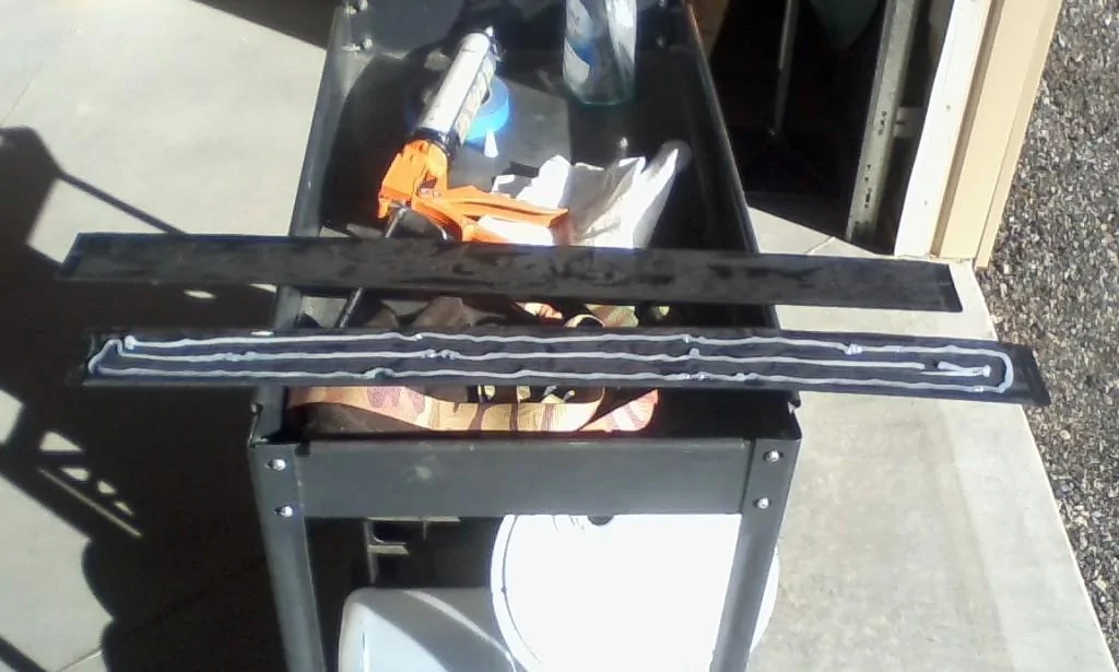

Use 100% Silicone....

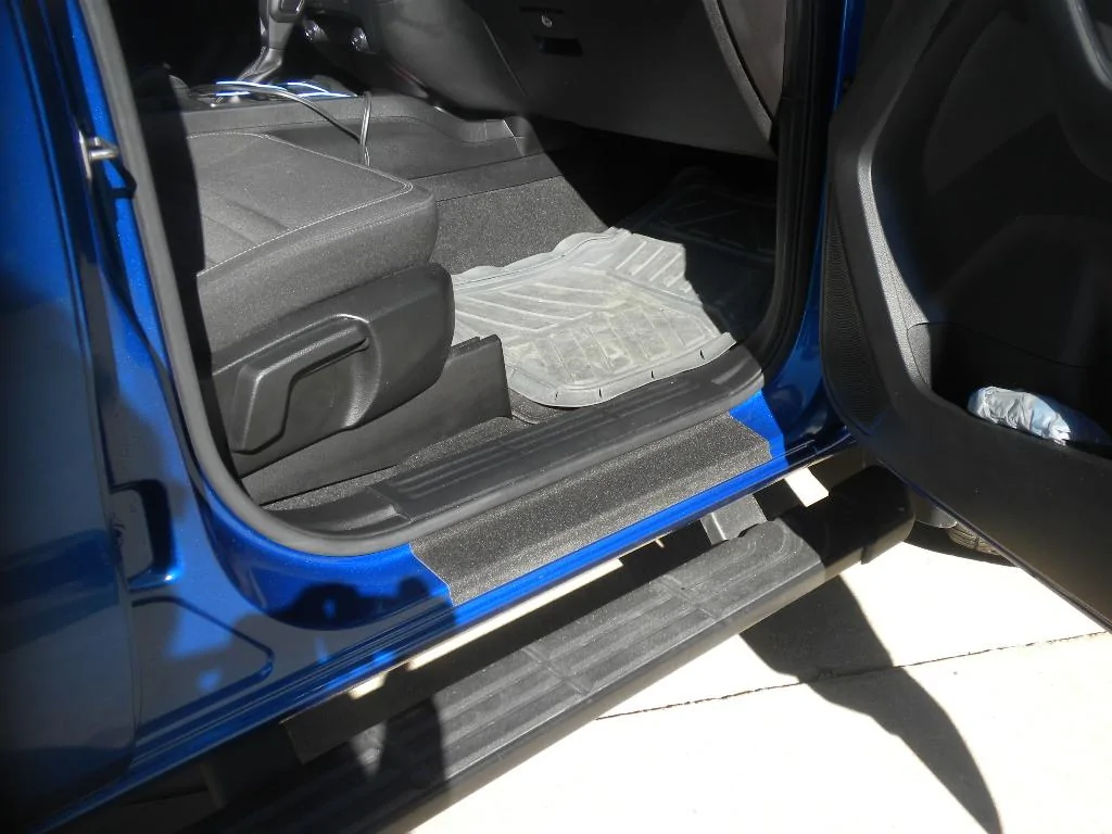

And ... they have vanished. Simply disappeared. The Gorilla tape is still there but the protectors are ... just ... gone
That truly sucks. If you decide to give it another try, scuff up the back of the sill plate and use Silicone Sealant.
My body shop buddy also suggested putting some sheet metal screws at each corner. I didn't, but it would guarantee the scuff plates won't head for freedom.

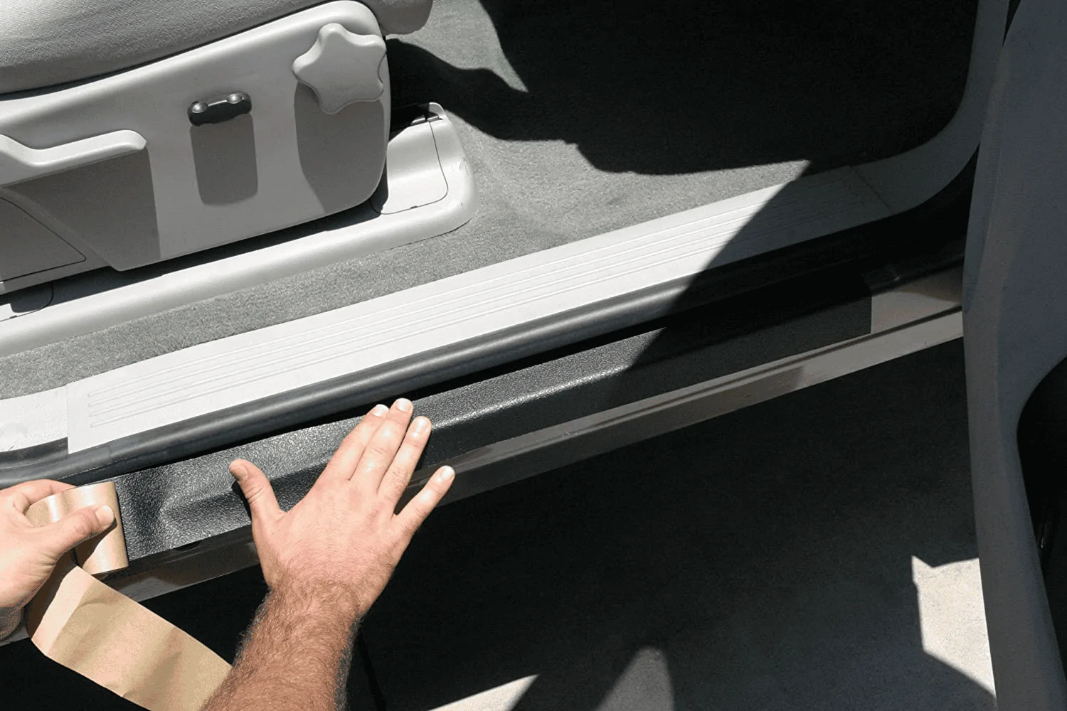

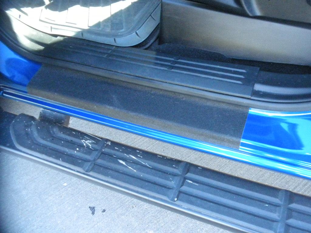

Mine have not come off yet. 3M anti slip step tape. Works for me. :)

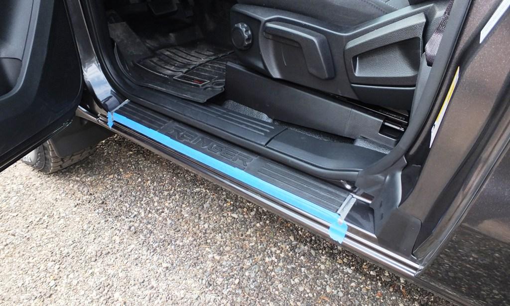

I use 3m tape with adhesion promotor to attach my old school Ranger sill plates and they are as tight as can be . Bret

I did the "old" Ranger scuff plates with 3M tape almost 18 months ago and they are still holding strong.

Getting ready to install these on my ranger.. Thinking of running a bead of silicone around the outer edge and maybe taking them off every couple years to inspect..
