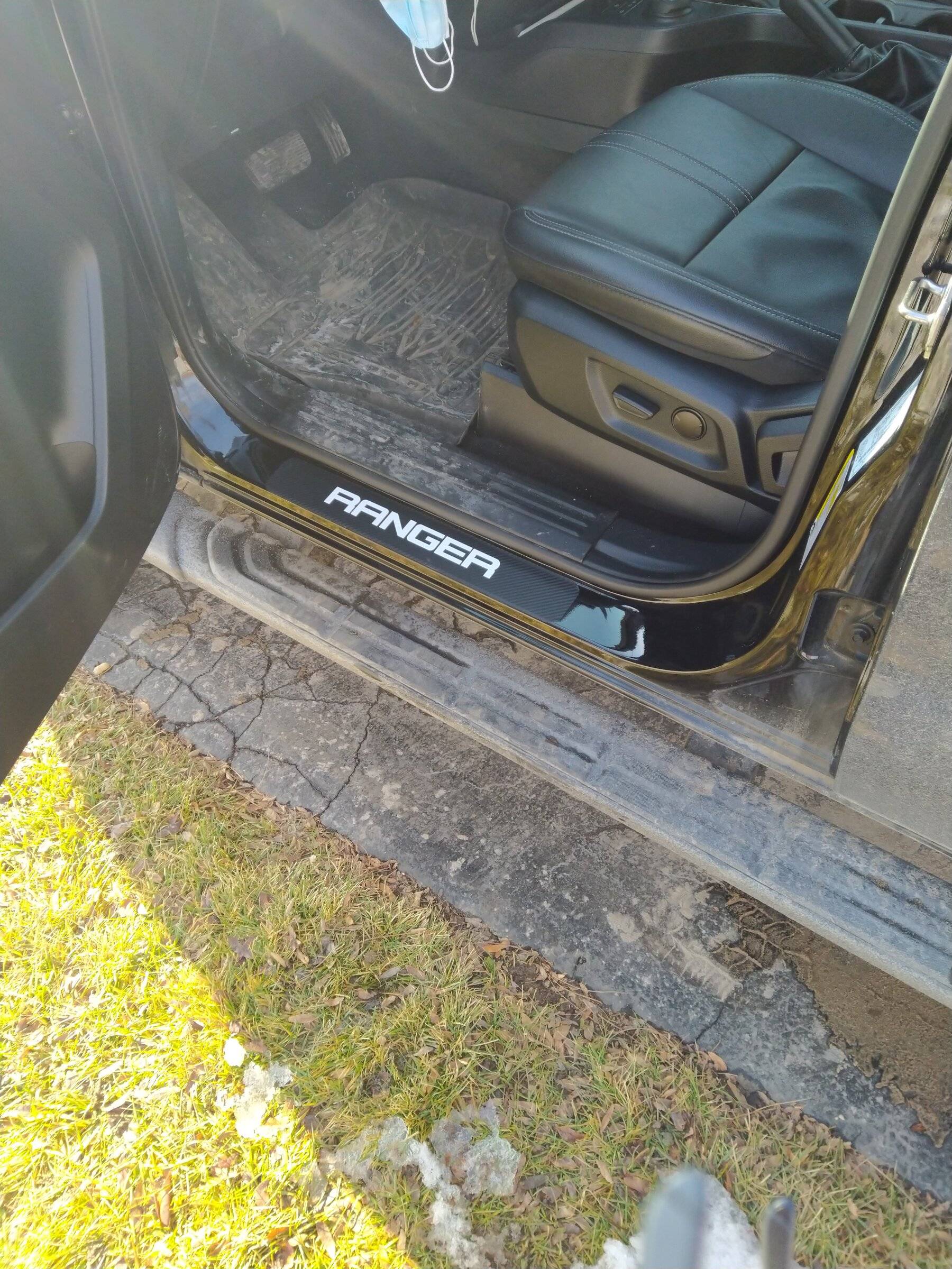

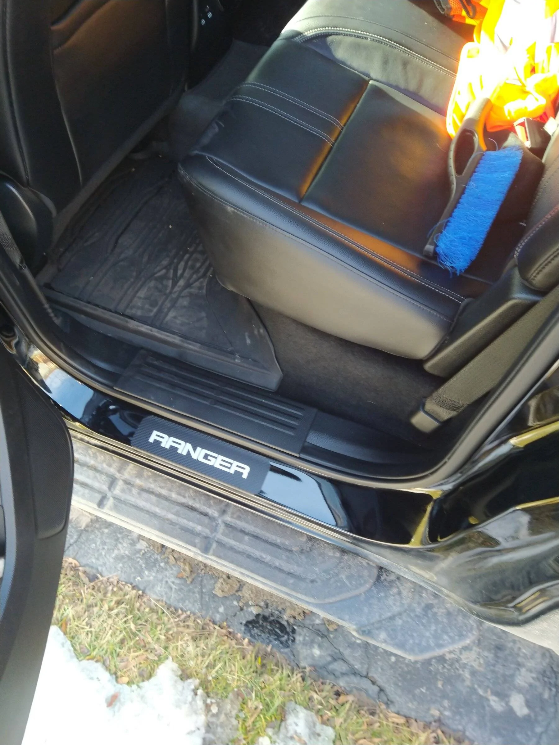

Did these today. From somewhere deep in the Amazon. Worst part was, since it's cold but not too cold today I thought a little extra warm air on the metal would help adhesion and wouldn't ya know I blew up my wife's hair dryer doing the last one, now I gotta get her a new one.
$20 mod, my ass lol

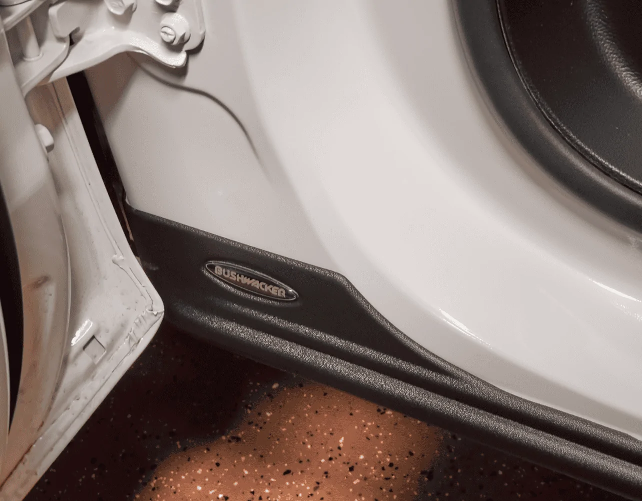

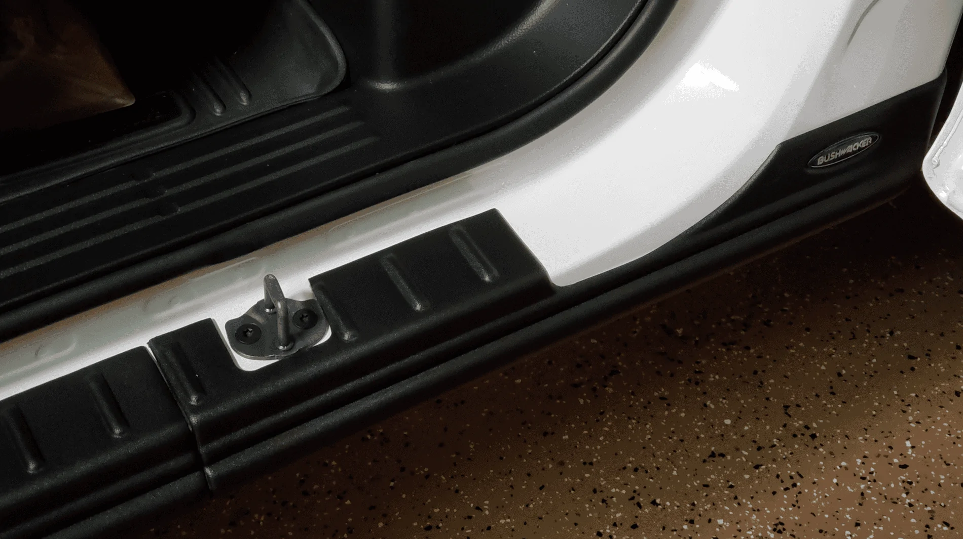

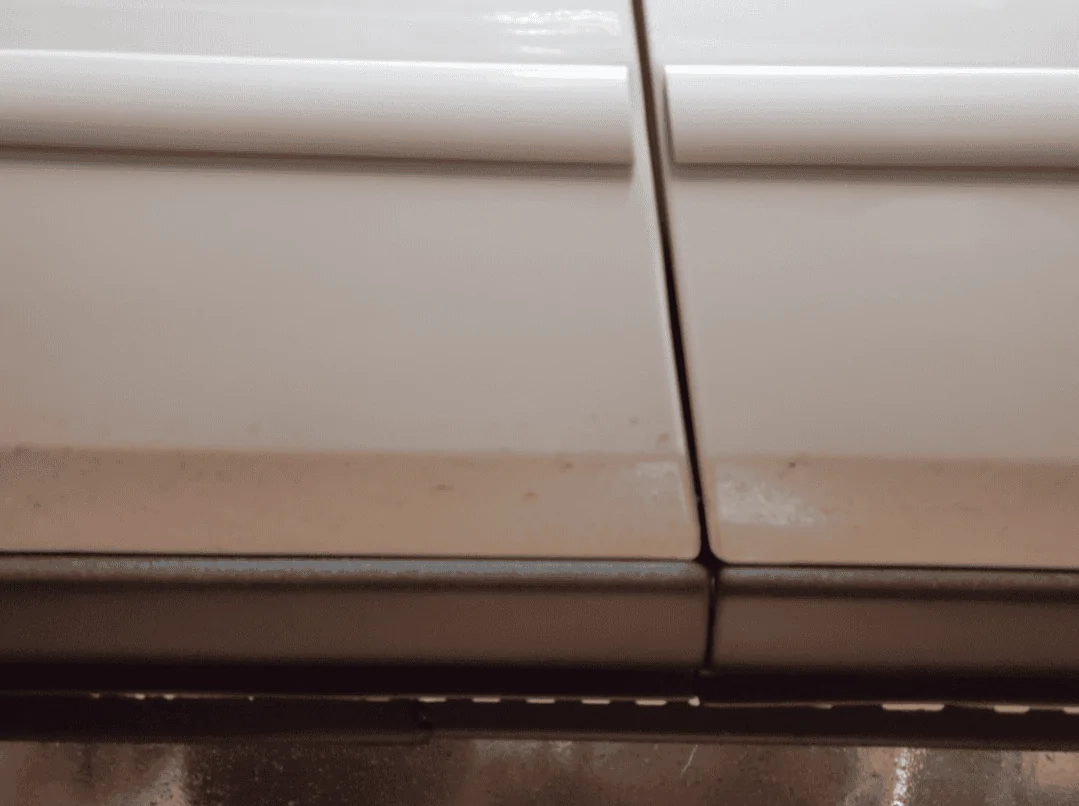

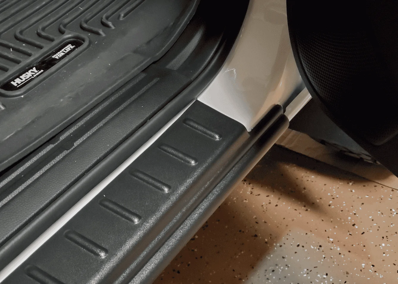

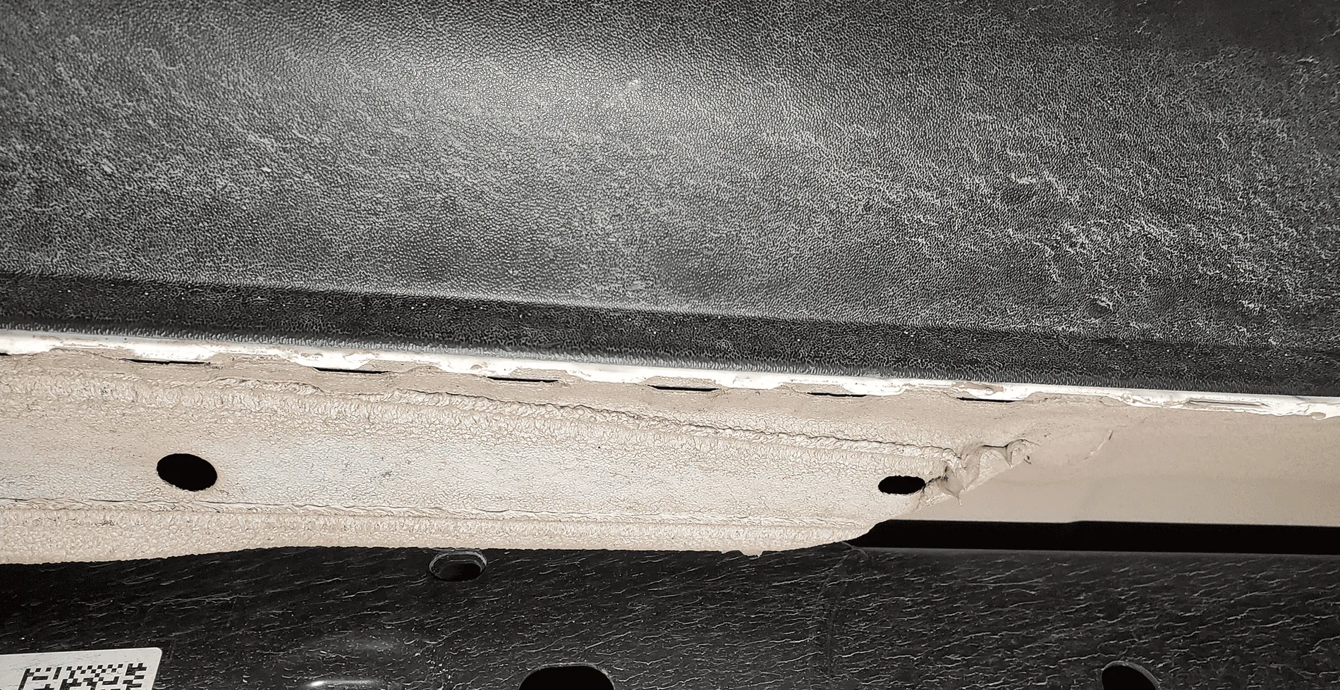

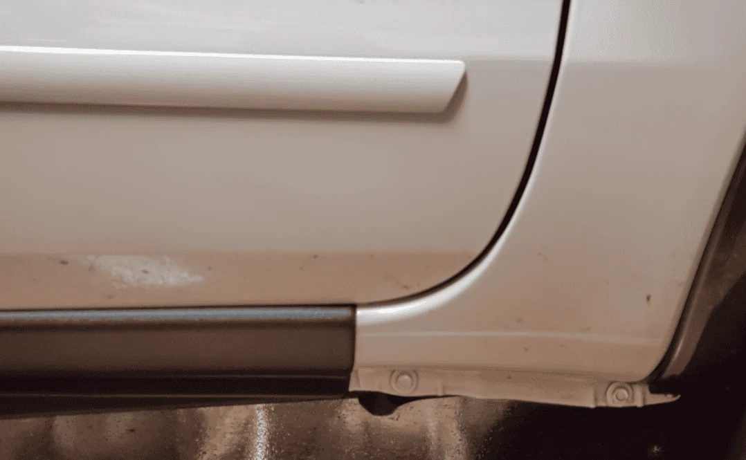

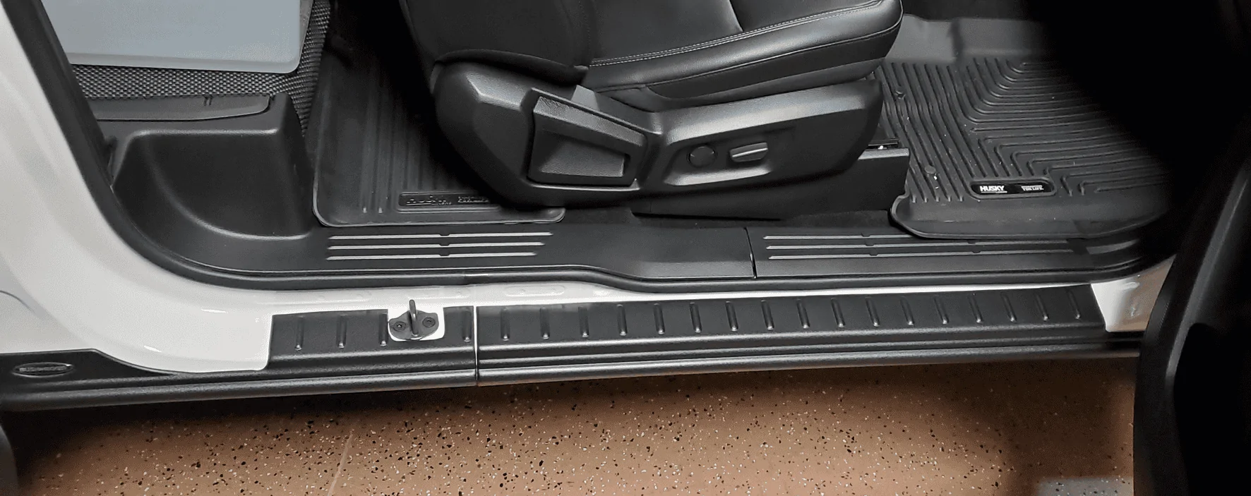

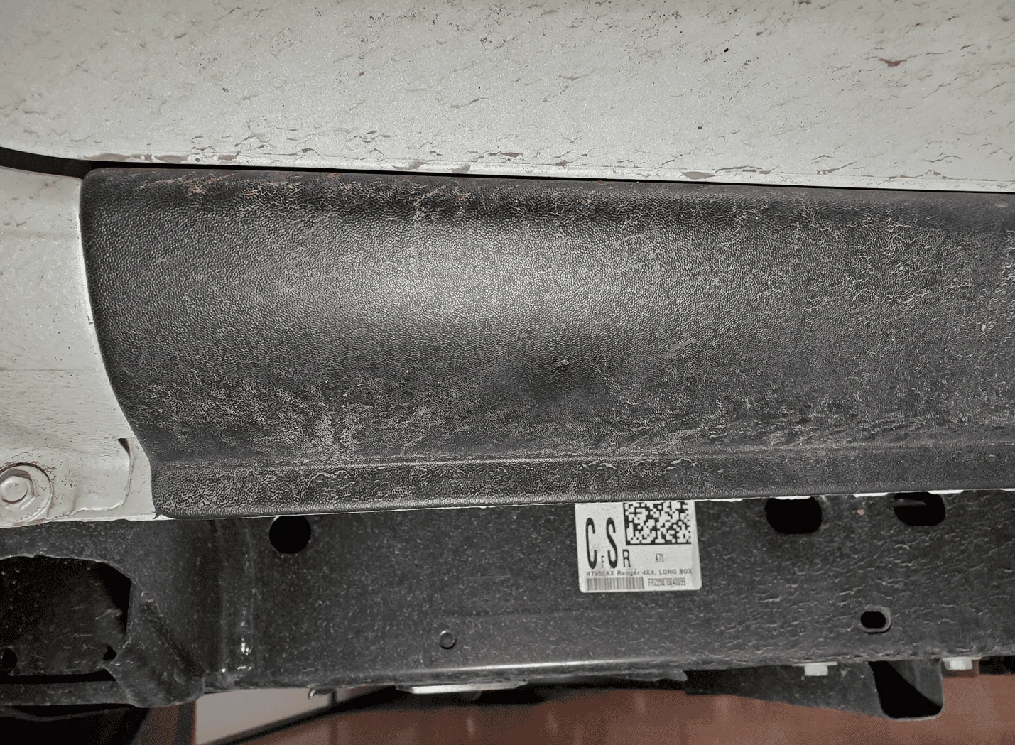

Pics of my Bushwacker Trail Armor I installed on my SCab July 2020. We track in rocks, gravel, and mud while off-roading and hiking. Not even a scratch on these. Material is thick and very durable. Together with our Husky X-act Contour floor liners we don't even hesitate jumping in and out because everything is protected. Rockers are protected down to the bottom of the pinch weld. I installed the front sections reversed (opposite sides) to close the gap between the front and rear. Two of the best mods I've added. Much easier than reminding my wife to be careful when she jumps in and out !
Purchased from Amazon HERE.

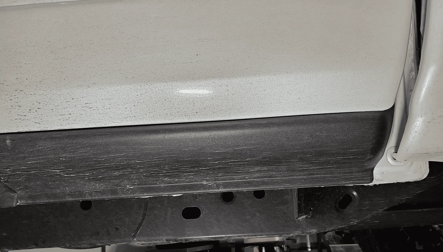

Driver side pinch weld coverage . . .
Last pic is looking up at the pinch weld.

How is this product fastened to the door sills and rocker panels?

For those of you who have the Bushwhacker type. Does the tape “seal” all the perimeter? Or can crap ( re: road salt/spray) get in behind them?

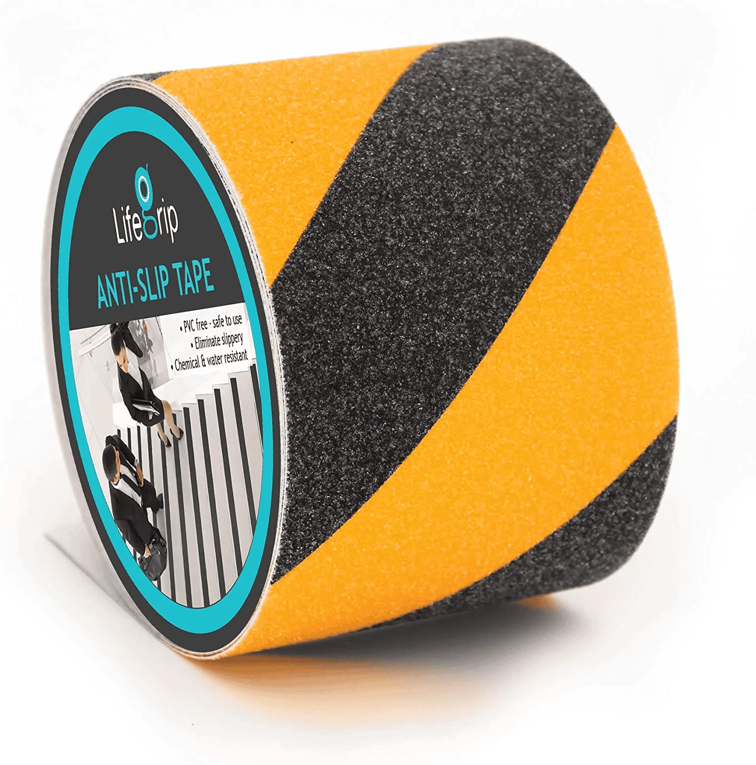

I like the rough 3M anti slip tape...just remember to check that its waterproof adhesive/material. Some of these Amazon knock offs are really cheap and won't last long, especially after getting wet. A shop I worked at before used to apply a "LineX" knock off type paint. We would tape off the area, expose area to be painted and either rolled it on with a roller or sprayed it on. Either application didn't matter as the paint would level off (no brush marks). Took edging tape off and let sit til dry. I'm sure those that are planning a spray-in bed liner could get the shop to spray the door sills as well. I've seen that done too. Just throwing out some of my random thoughts on the idea :fingerscrossed:

I do not have this sill protector (nor do I have a Ranger...yet), but I do have experience with detailing these types of protectors.
Usually they are held in with double sided tape. Depends how far the tape was installed on the edge will determine how much crud will get caught between the protector piece and the actual truck body. Water and little rocks or grains of sand WILL get caught in between!! Step on one that's been on for a while...you will hear the crunch of all the crud between the plastic and the sill :oops:
Unless you literally glue the entire piece down, stuff will get behind there. For most people there fine with it as its easier to clean and dress up the plastic piece vs cleaning an exposed sill with scuff marks. I would rather clean up those everyday marks and keep a nice coat of wax/sealant on there. My second choice would be to have that area taped off and apply a "lineX" type paint which would be tough to remove vs a "sticker" or double sided plate/plastic protector. Those tend to not last as long and trap dirt and water on the edges. Again, MY preference :wink: But I don't plan on using my vehicles for any real rough stuff too. I have also seen people get the entire lower rocker painted with the lineX type product because they do a lot of off road driving and it protects the underside a bit. Might even cost less than the Bushwhacker/FORD ones too?? Just something to think about.
