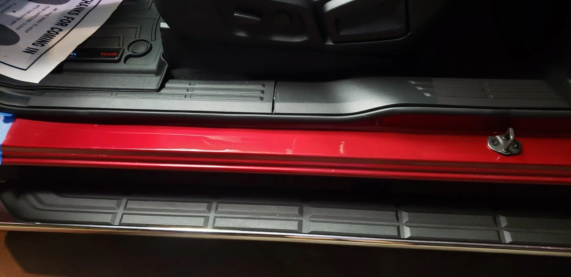

Thanks Bret,
Got any pics of your install?
That part number is for 4th. gen regular cab, curious to see how far back it goes on your 2019 S/Cab door sill.
Thanks again bud

Fabulous idea bud, that looks better than factory!:like:
The sill plates on my week old 2020 S/Cab are just begging to get scuffed up and I intend to pirate your idea.
I'll probably have to order the 4 door version of the 4G models, as my truck is a SuperCab, my 2000 S/Cab had these in place and they did well to protect the sill.
How's the double-sided tape holding up for you, have you had to replace them yet? No issues with interference with the door itself?
They are holding up very well. No problems so far. But then I'm retired so they don't get much traffic on them. Truck is 8 months old and only 5700 miles.

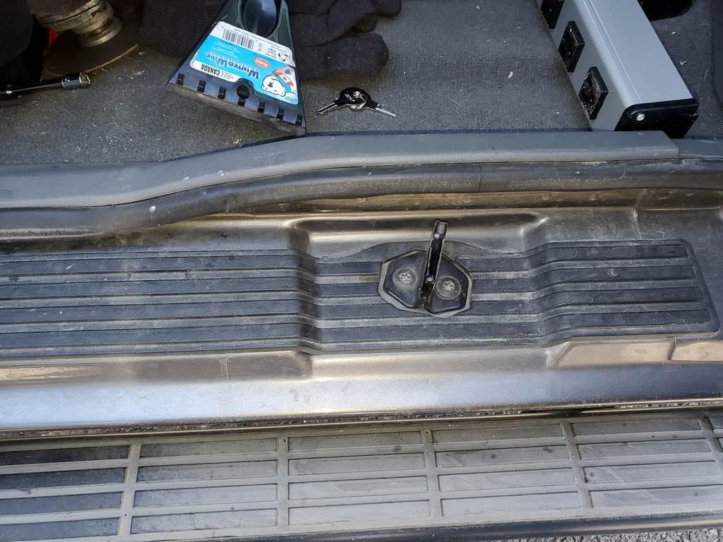

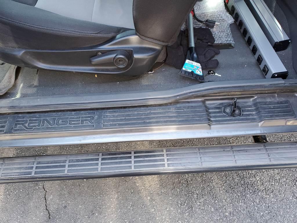

Hi Jeff,
OK, the measurement from the front of the door sill guard to the clam shell door is the same as what you have.. 38 inches.
As you can see there is a depression in the 2008 door sill where that latch is, which is not on your 2019 Ranger.
I forgot to measure how wide the dip is and how far beyond the latch the guard went.
From the looks of the diagram on the Tasca Ford parts page, it looks like the dip is molded into the plastic. Unk if you could flatten it out or not with some type of heat press.
Maybe you might be just happy with cutting off that portion and just covering the first 38 inches.
Of course you will still need to cut off the back tabs and use either the 2 sided tape or silicone glue and one of the owners has shown.
Good luck, Mike

Thanks so very much Mike for taking the pics, much appreciated!
I will take your advice and cut the sill plates just forward of the depression.
Not concerned with the sill aft of the striker, no living creature will be inhabiting that area.
I've already ordered the plates from Tasca.

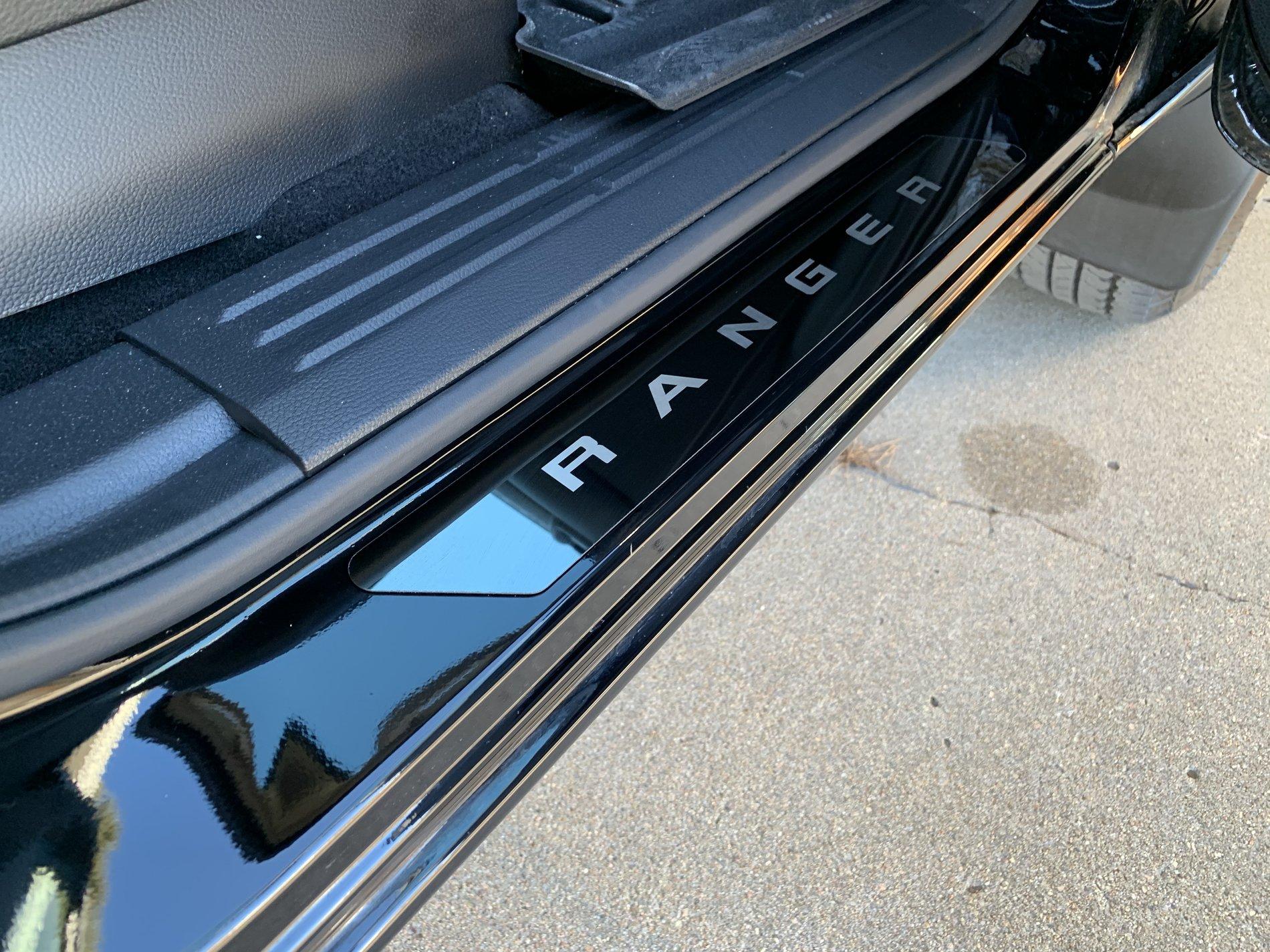

I'm going with a plain carbon fiber look. Too many Ranger logos already on the truck; grill, tailgate, floor mats, dash, front seats, tonneau, bed mat. I think everyone will know its a Ranger. It can be overdone.
NEVER bruh even with all these logos idk if people are blind or straight oblivious I've been getting "compliments" on the color idk if I should even take these "compliments" as they think it's a tacoma or colorado, hell I've even been mistaken for a tundra once, my face went blank as I turned around and walked away. :ontheloo:
