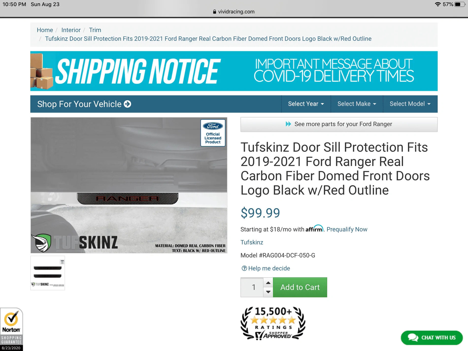

Ordered today from Tasca for about $33 total. The only other good option was Tufskinz, see picture, nice but 3x more expensive.
