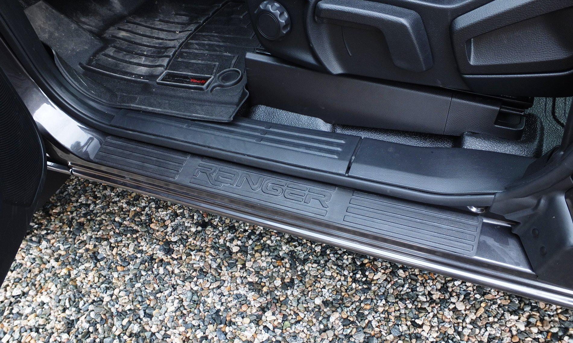

My solution to missing door sill scuff plates.
I found this forum before I ordered my 2019 Ranger.
Thanks to this forum I spent a lot of money before delivery on items posted in this forum.
But after delivery I also noticed that there were not any door sill scuff plates. I did not like the stainless steel factory jobs nor the aftermarket ones that go below the door sills.
Since I sold my 2008 Ranger for this 2019, I remembered that it had really cool sill scuff plates.
Looking up the part numbers on Ford Dealer parts pages the part numbers never matched the parts pictures displayed.
I found the scuff plates here. https://www.tascaparts.com/oem-parts/ford-scuff-plate-f37z1013260a
Part Number F37Z-1013260-A. They fit either right or left.
The material is pretty close to the Weather Tech mat material. Some type of vinyl rubber/plastic.
My 2008 Ranger was a 4 door extra cab so the scuff plate was close to 4 feet long which is too long for the super crew 2019. So I ordered the scuff plate for the 2008 Ranger 2-Door. The scuff plate was about 33 inches long.
I used a table saw to trim the width, about 1/8" on each side, and cut off each end to make the length about 21 inches. I used a belt grinder to remove the 6 tabs off the back that were obviously for securing it to the door sill on the 2008 Ranger.
From the parts diagram on Tasca Parts you can see a facsimile of the tabs.
Once done, I mounted the scuff plates with double sided tape. The foam style, not the thin stuff. Hopefully this will hold up for several years. If not, renewing the tape will be easy.
The picture shown here is the front drivers side. I'll get two more of them for the back doors. The rear doors are smaller so I'll need to trim even more off the plates.

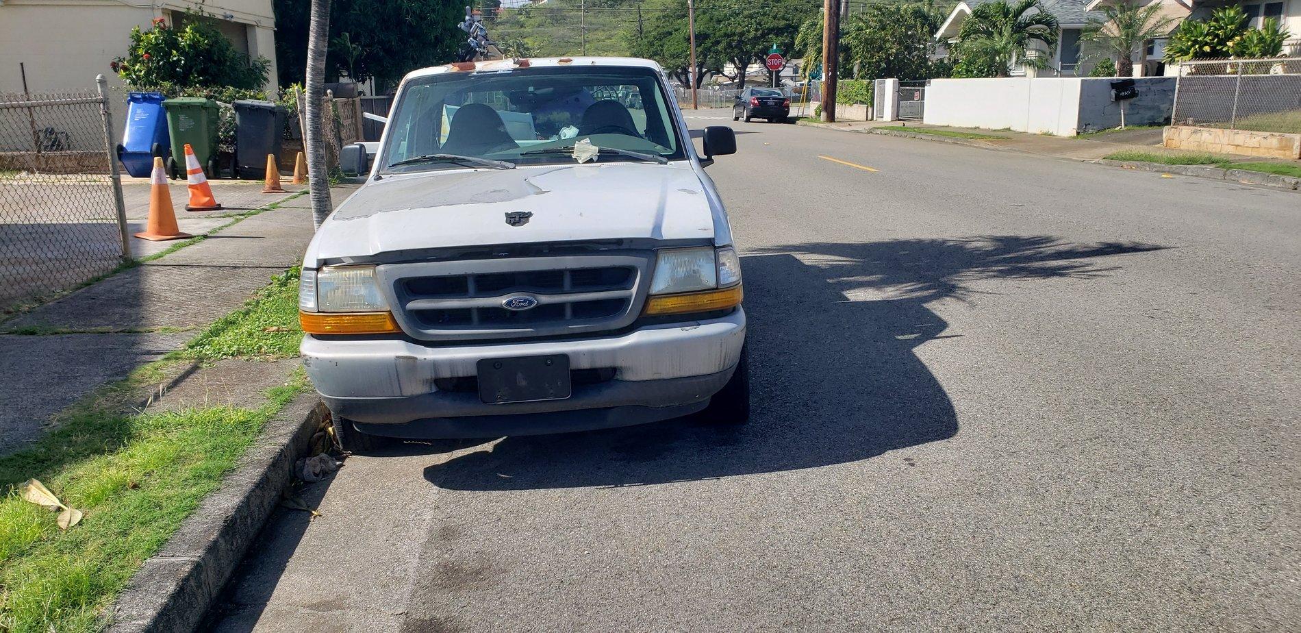

Hmmm,
There's an abandoned '99 regular cab just 3 doors away, thinking about helping myself to these sill plates just for sizing...
