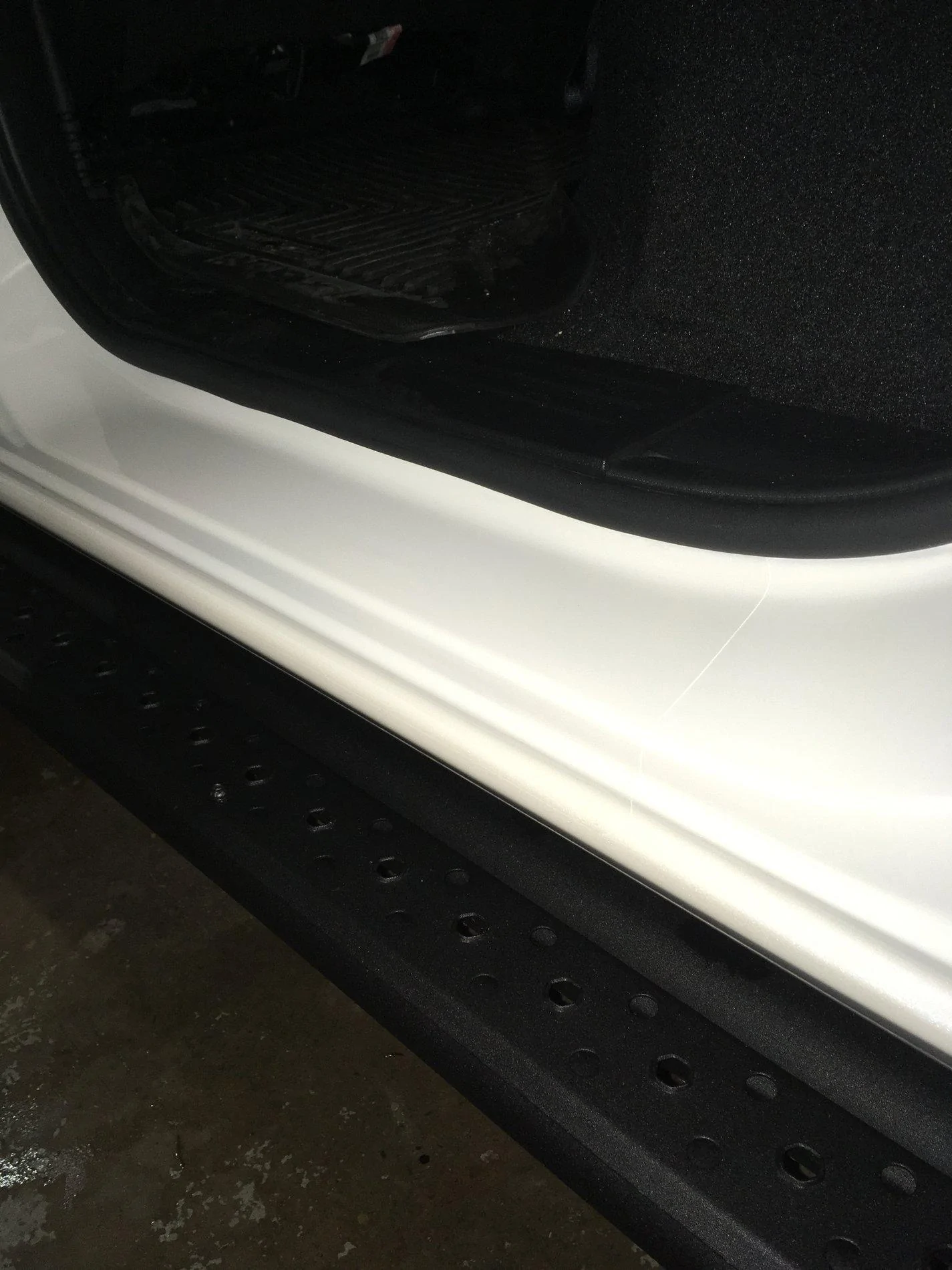

I appreciate you guys adding the door sills and think they look pretty good. I felt the need for more painted edge protection when I step on the running boards and applied some 3M paint protection film. It is hard to see, but a little dirt helps.

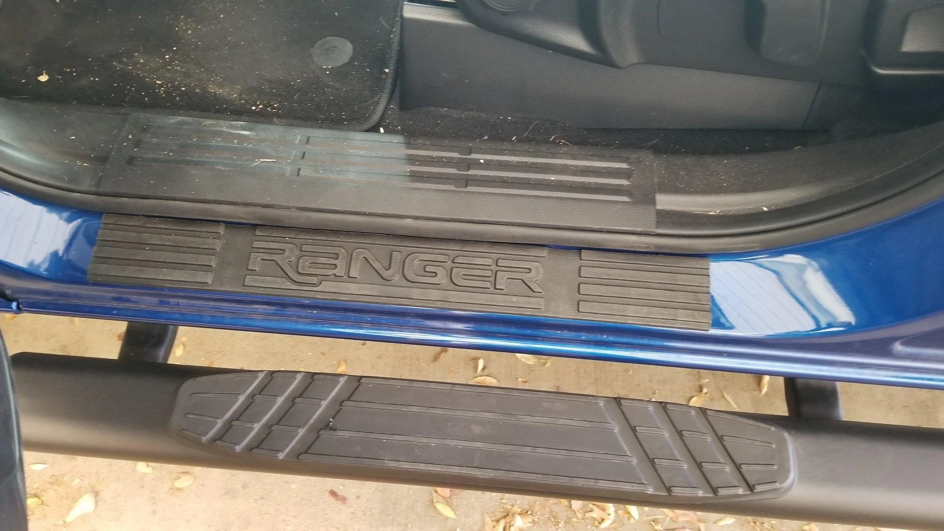

I have the OEM black platinum door sill which I believe are made by Putco. They look very nice but scratch very easily.

I went with the 3M PPF too. First time using it and I’m pretty happy with how it turned out. I bought 6” wide and trimmed to 5”, but I wish I left it wider to go all the way around to the gravel guarded area.

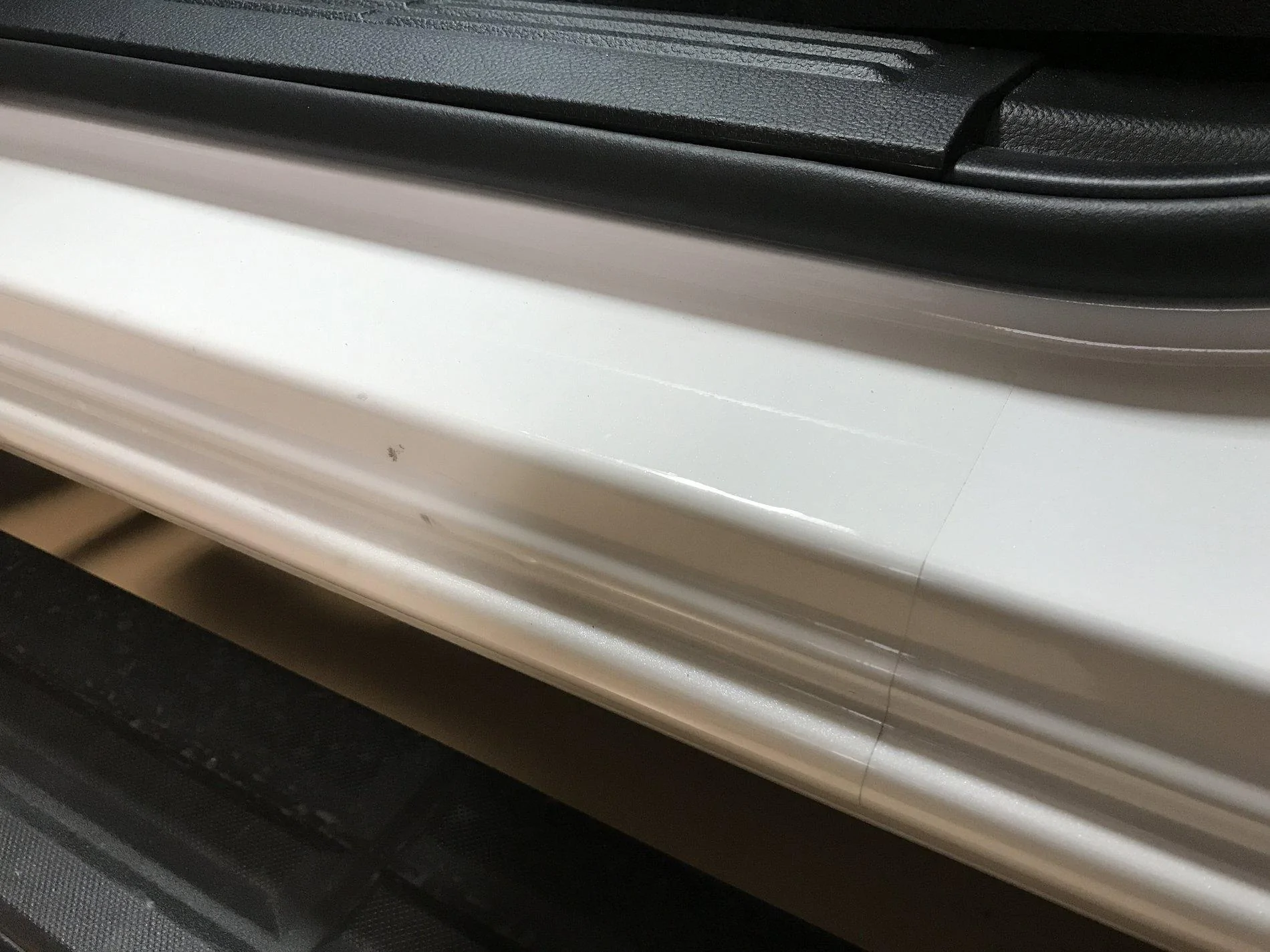

Looks good and Xpel is good quality but is 2.75” wide enough? I’d rather get a 6” width and cut it down a bit to cover the entire area.
Have any pictures?
See pix, It's wide enough to wrap the first lip by about 1/4". I did all four door thresholds with [2] rolls. I cleaned with alcohol, warmed with hair dryer and used a plastic spreader to work it down. I only had one with a slight bubble, took care of that with a couple pin holes and worked them out. I suppose if you could find wider material and wanted to run even further down the side thats an option. I just did not feel the need to over think/spend on it.

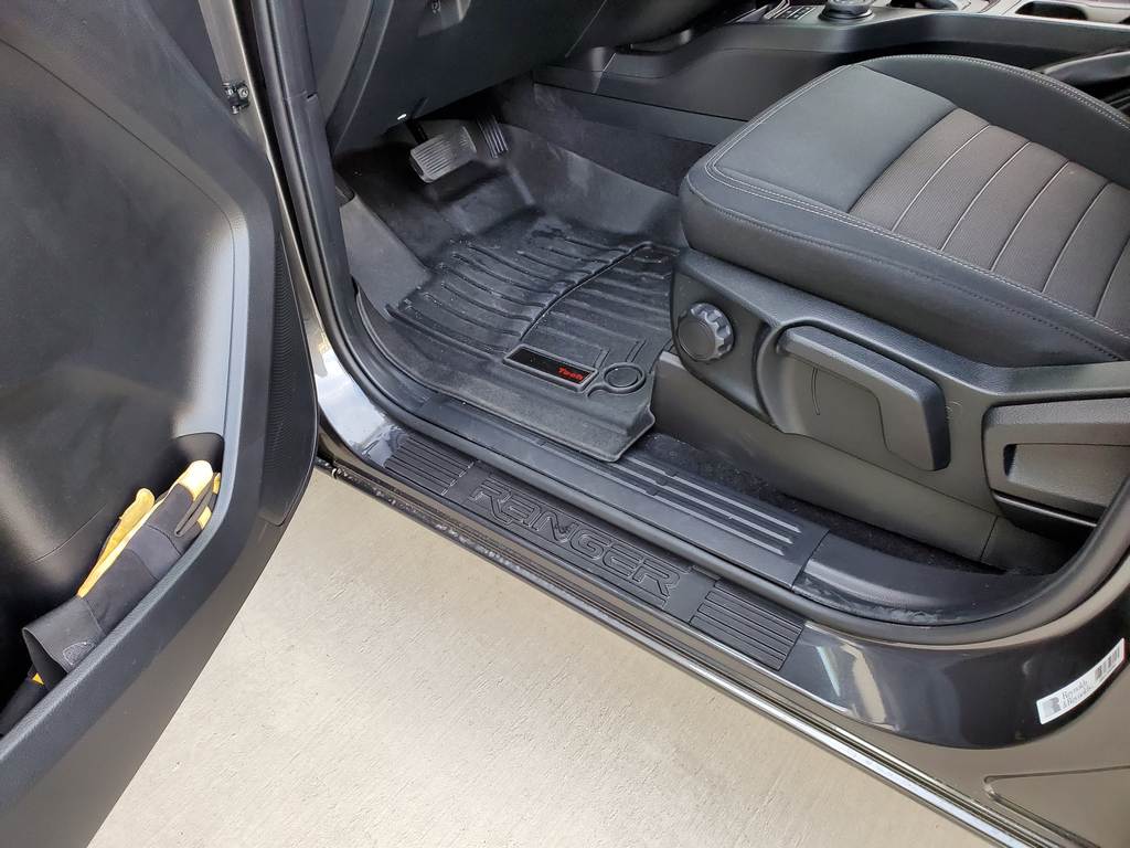

Here is what mine came out looking like. I'm pretty happy with how they look - almost factory I think. For $30 or so and a few minutes of cutting, I think they turned out well. I think they will be more durable than the stick on kind and they are cheaper than the metal ones.
Thank you for posting this! I'm not sure if I will do the rears as well (don't have too many people get in the back seat), but I'm really glad the front sills are now protected.
Just ordered the scuff plates. I have the $80 plates installed but they scratch to easily and I don't want to deal with not scratching them when I enter the truck sooooo...Getting real scuff plates.
