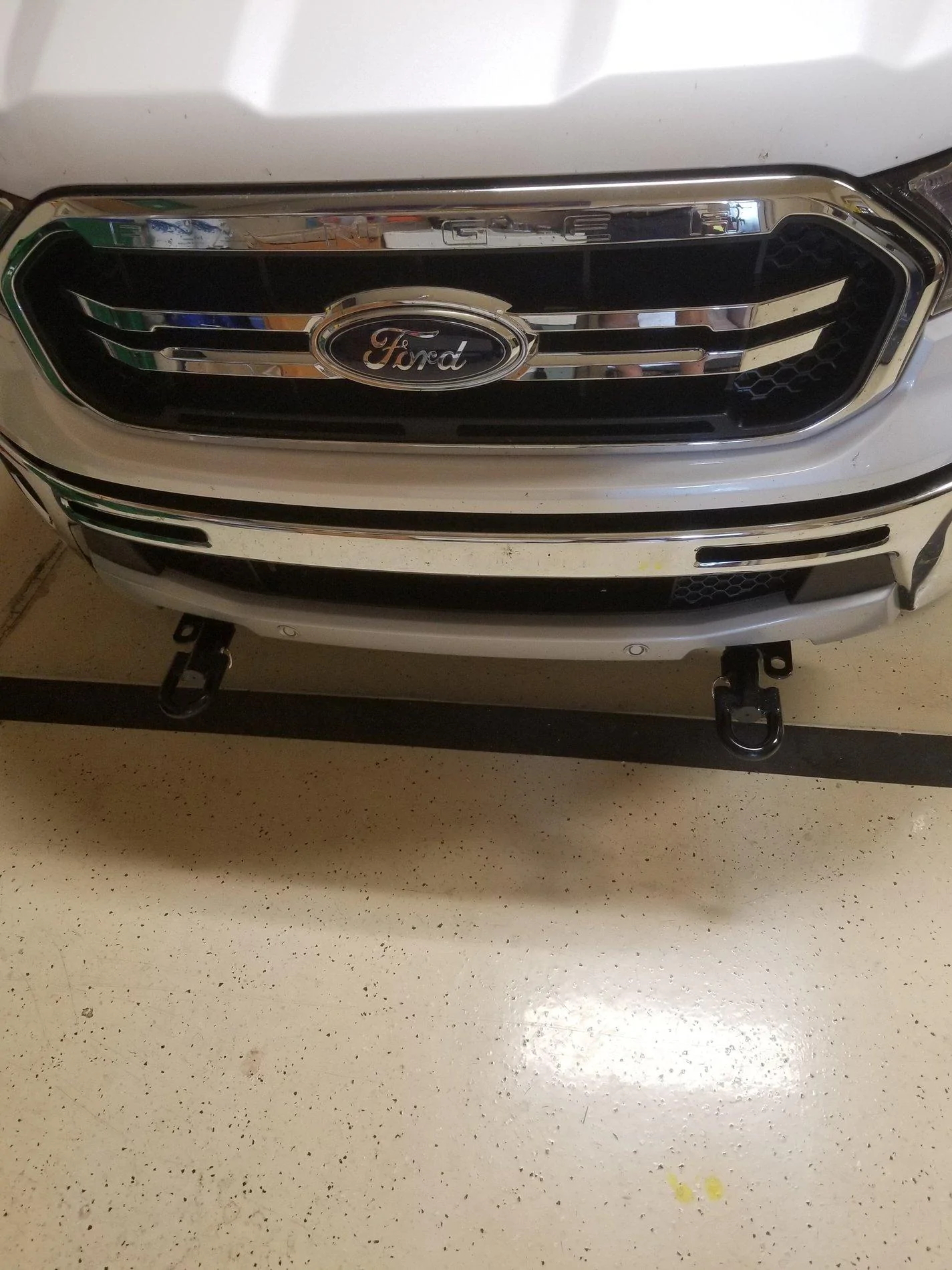

Hi Folks,
I am so impressed with the appearance mods people create for their Ranger. many make their vehicle unique! Kudos!!!!
I will keep mine as delivered but for the Replacement tow hooks, which I fabricated as I like the look
These twist in to my tow bar base plate brackets from Roadmaster in place of the OEM brackets. Love the lathe and welding results. My hobbies after RETIREMENT,
Bbest,

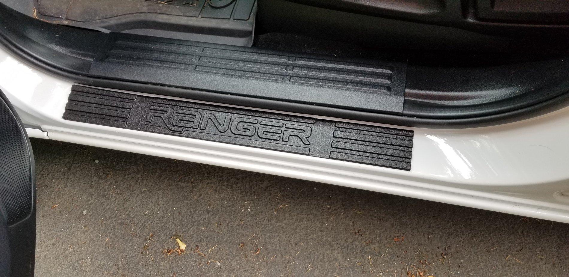

My solution to missing door sill scuff plates.
I found this forum before I ordered my 2019 Ranger.
Thanks to this forum I spent a lot of money before delivery on items posted in this forum.
But after delivery I also noticed that there were not any door sill scuff plates. I did not like the stainless steel factory jobs nor the aftermarket ones that go below the door sills.
Since I sold my 2008 Ranger for this 2019, I remembered that it had really cool sill scuff plates.
Looking up the part numbers on Ford Dealer parts pages the part numbers never matched the parts pictures displayed.
I found the scuff plates here. https://www.tascaparts.com/oem-parts/ford-scuff-plate-f37z1013260a
Part Number F37Z-1013260-A. They fit either right or left.
The material is pretty close to the Weather Tech mat material. Some type of vinyl rubber/plastic.
My 2008 Ranger was a 4 door extra cab so the scuff plate was close to 4 feet long which is too long for the super crew 2019. So I ordered the scuff plate for the 2008 Ranger 2-Door. The scuff plate was about 33 inches long.
I used a table saw to trim the width, about 1/8" on each side, and cut off each end to make the length about 21 inches. I used a belt grinder to remove the 6 tabs off the back that were obviously for securing it to the door sill on the 2008 Ranger.
From the parts diagram on Tasca Parts you can see a facsimile of the tabs.
Once done, I mounted the scuff plates with double sided tape. The foam style, not the thin stuff. Hopefully this will hold up for several years. If not, renewing the tape will be easy.
The picture shown here is the front drivers side. I'll get two more of them for the back doors. The rear doors are smaller so I'll need to trim even more off the plates.

Now that’s a quality scuff plate!. They certainly don't make things like they did in the old days. Now we get “Putco” aftermarket scuff plates and battery operated keypads. WHY Ford!
But a very ingenious idea, looks more factory. I may have to borrow this idea from you. Thanks for sharing. :like:

It is a very ingenious idea - I was skeptical as to how the cut edges would look, but they really cleaned up well I think. I'm very happy with this solution. Thanks @PJVet !!!

Very nice! They look pretty thick too I’m surprised you didn’t have any clearance issues. Did you cut yours a little longer? Looks like it goes further in towards the door. Both great Jobs!
And btw, Tasca Ford is one of the best online places to buy Ford parts. Ive been buying from them probably 15 years now, they have the best customer service, prices, fast shipping and I never received a screwed up order.
I'd guess the pieces are 1/8" thick or so - no clearance issues at all. I don't know if cut mine longer or not - I just kind of gauged by the flat spot of the sill. I think I cut something like 3 3/4" off each end and then about 1/8" off each side.
