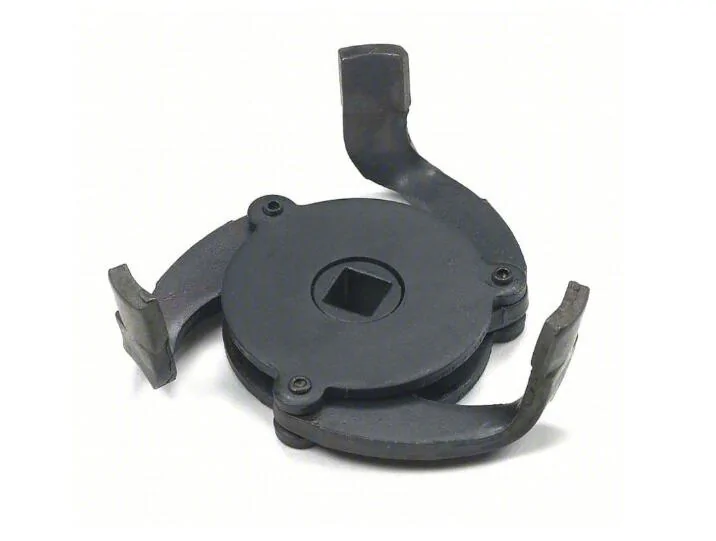

I ran into this on the first oil change on the ranger. I picked up the 3 arm one from harbor freight. Walmart here carries them too.

That linked socket filter adapter is what wasn't working for me, either. It was rounding the filter's edge. Using this 3 pronged adapter with an extension worked perfectly.
That's what I use, never had an issue. The factory one was tight like most people have said. Been doing this for a while, always clean the mating surface throughly and oil the seal well. Tighten hand tight, never ever use a wrench to tighten the filter.

This! I just went through the same thing a few weeks ago. I normally do oil changes with the truck on the ground, but needed to jack up the left front tire to get enough leverage to get it off. I used a 12" extension with the 3 arm universal oil filter adapter. Worked like a charm! I was sure not to over tighten it this time. :)
