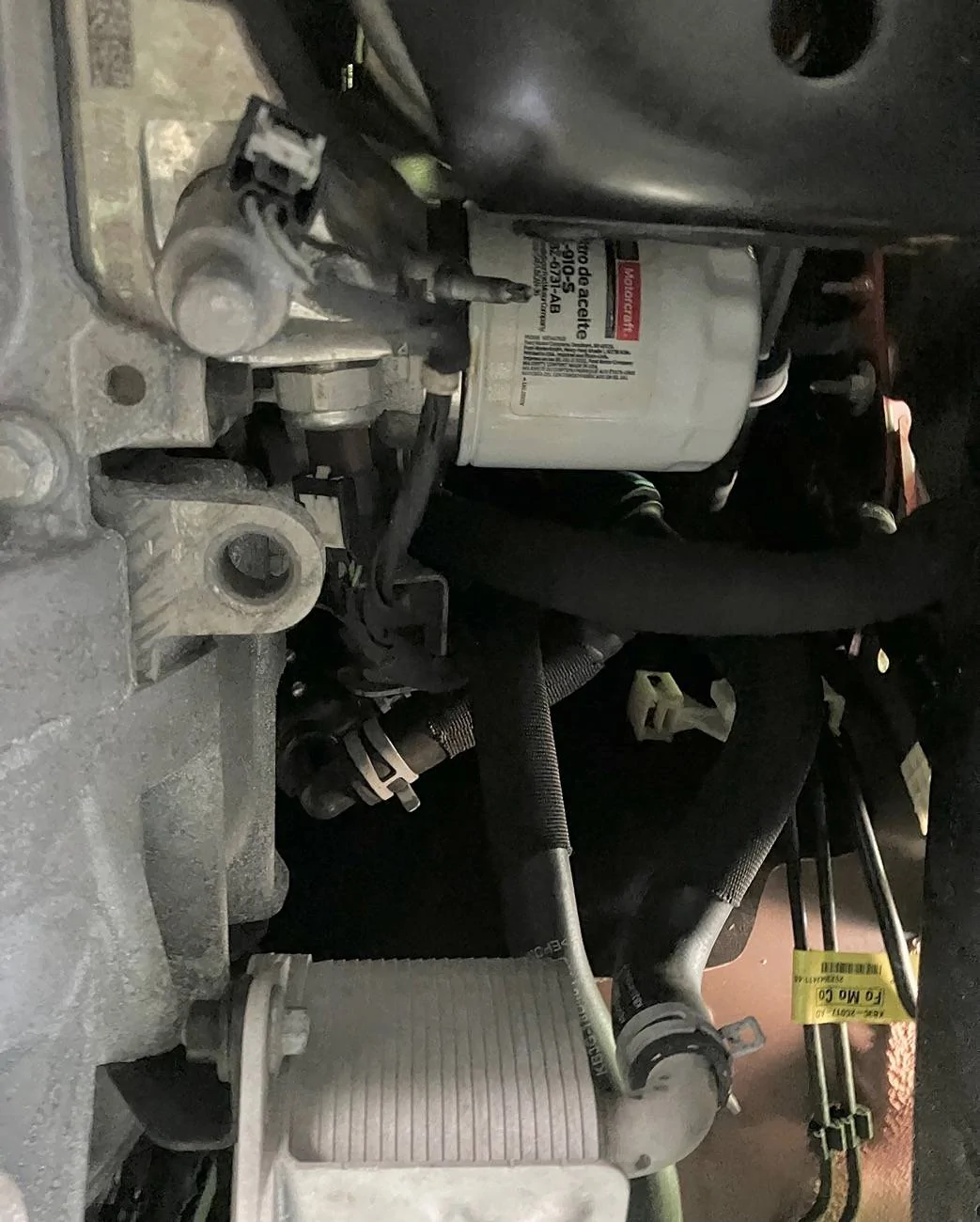

My wife's Chrysler Pacifica has a filter like that. It's easy to change but the thing is not to overtighten it and crack the housing. The trick to being neat with it, and I don't know if the diesel Ranger is the same, is loosen the cap that holds the filter cartridge, pull it out of the housing slightly, and let it drain while you drain the oil. Then it doesn't drip much when you remove it.
Yes that's pretty much what I do because it mounts in a similar position to the one on your Ecoboost ie sideways behind the flap and angled down about 40 degrees, so it drains naturally when you loosen it. Yes when screwing it back on you need to remember it's the O ring at the end of the thread that makes the seal, not a flat seal that you can tighten further, when it stops - it's up!

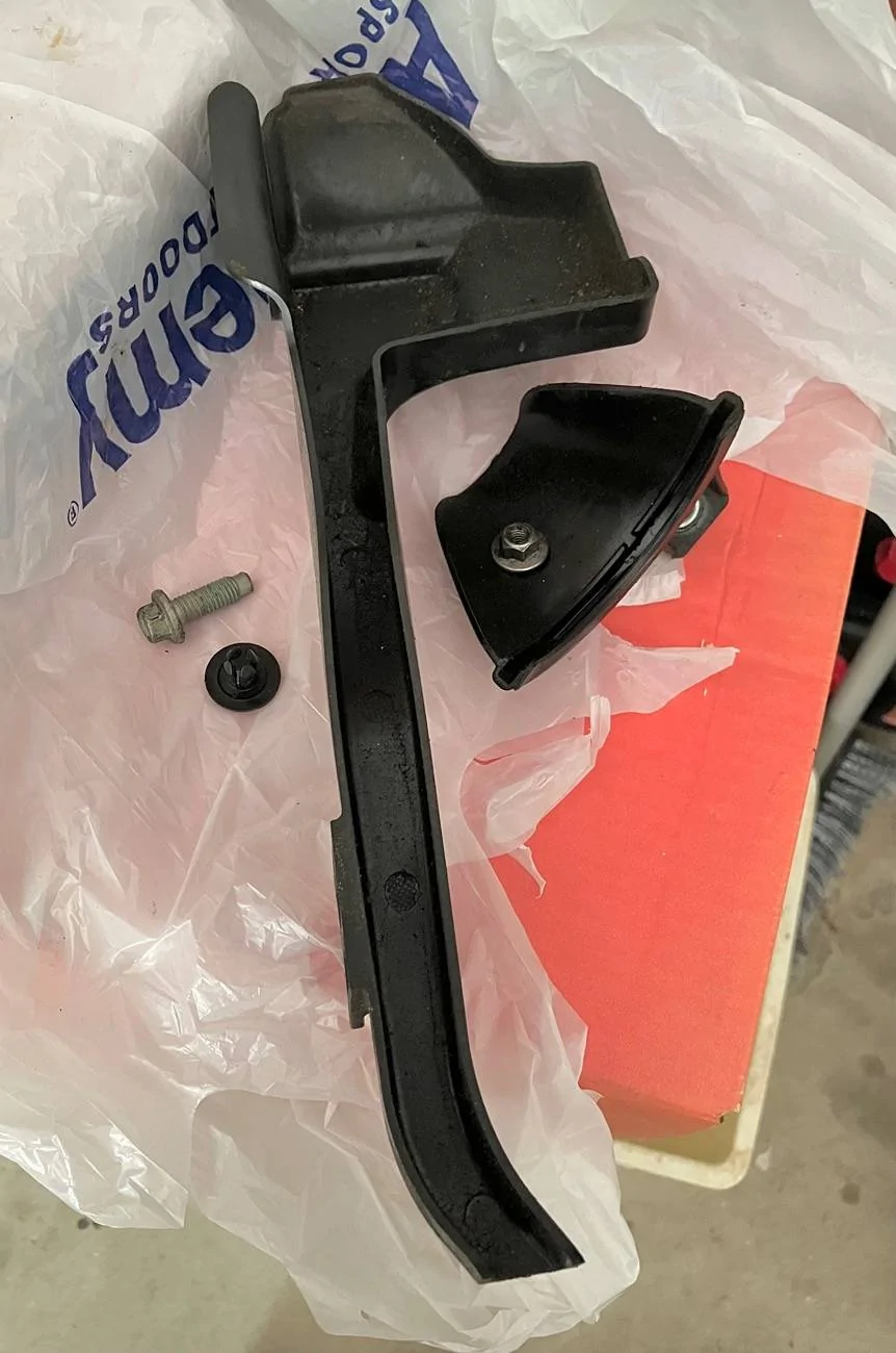

I removed the two drip trays. Good in theory but bad in reality.

Exactly. I find reaching over the tire to be pretty easy.
Yeah I don't get it. Ford actually put a channel to catch the oil and not make a mess. I remove the flap, and seconds later I got my filter out. It's one of the easiest oil changes I've done.

Why didn't you have clear access from behind the driver side wheel?
Required removal of a splash shield. And the angle is more favorable for a filter wrench from below, than from the side. Some oil spills on the crossmember, minor annoyance. Actually had cars that made a much bigger mess when removing the oil filter.
Splash shield is pretty simple to remove and my filter wrench fits right in. No oil spilling on the frame, drains right into my container and no minor annoyances.
You do what makes you happy but I'll still say many of you make a big deal out of it.
