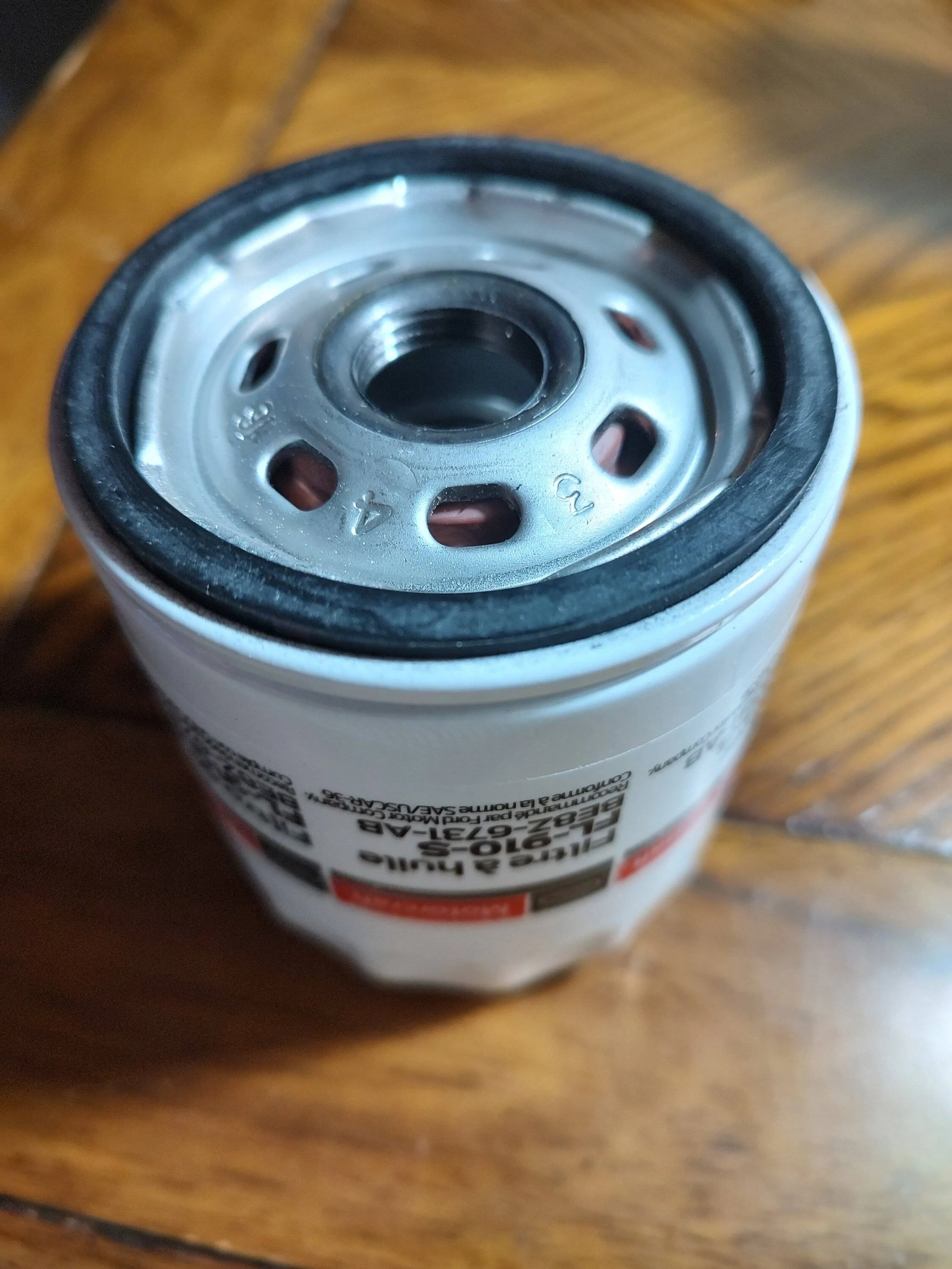

The factory filter on my MY19 Ranger was not marked as FL-910S. But could not tell you if it was different. I use a three jaw expandle jaw filter wrench with a long extention, that I bought at Harbor Freight. Works great going in through the wheel well. Doesn’t care diameter or flutes.
I have had five Ford's that all specified the FL-910S filter. None of the factory filters were marked FL-910S, they all had a much longer Ford part number. Also, the Motorcraft FL-910S is made by Purolator. They have a distinctive oval hole in the end plate. The factory filters had round holes. If I were to guess I would say the factory filter was made by Champion Labs.
A tidbit of history. The FL-910S filter is not even a Ford design. It was first spec'd in 1982 on the then new 2.2 Mopar 4cyl.

I've read that the FL-400S will fit and it's a bit longer although I've not tried it myself. I don't know that an extra couple ounces of oil and an inch of filter media would matter but it might make it easier to reach.
It definitely does fit. I used the FL-400S on my 2.3 Ecoboost Mustangs.
Another interesting tidbit. The 2.4 4cyl in the PT Cruiser spec'd the FL-910S when naturally aspirated and the FL-400S when turbo charged.
Thanks. Have you used it on the Ranger and do you think it's easier to reach?
I have not and likely won't. I have a 1" thick sandwich adapter between the filter and the block so I would have a place for the sensor for my auxiliary oil pressure gauge. The longer filter too would put the end out at the frame.
I don't see how a longer filter would make reaching the filter any easier. It is very easy to get at to remove/install with an oil filter socket and long extension.

I miss the old Motorcraft FL-1A. Nice beefy filter. Probably held a quart of oil by itself. Sigh...
Fl-1a, 910 and 400 all have same thread and gasket size.
