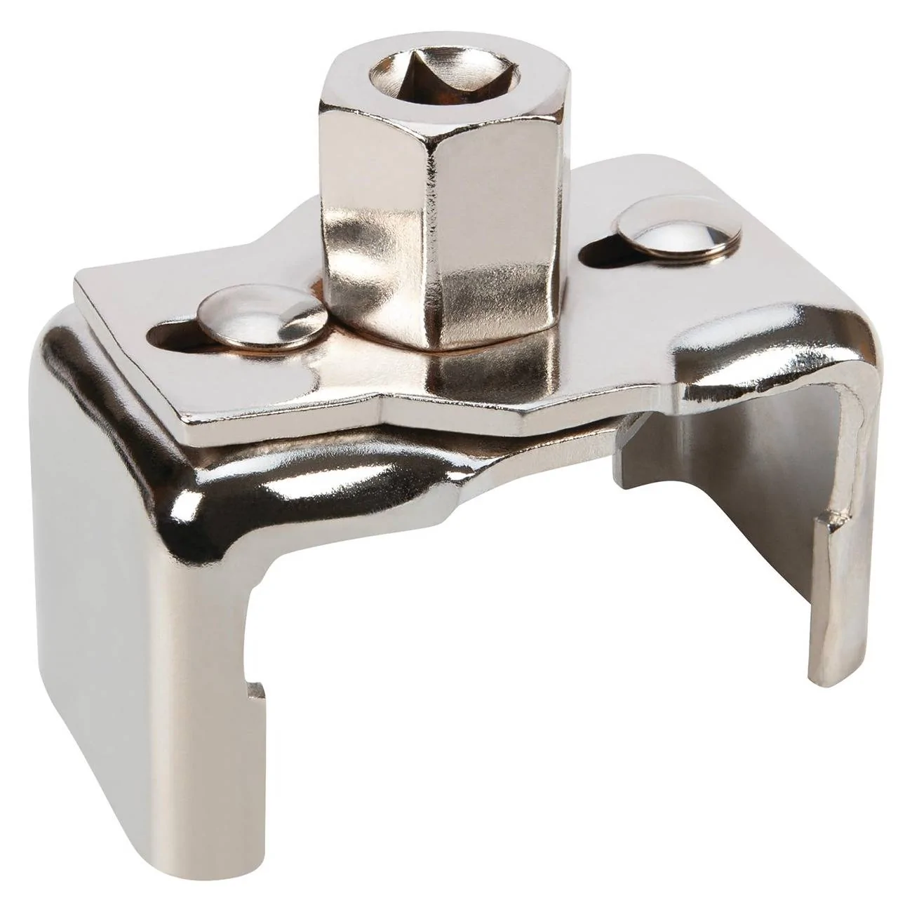

I have not used the 3-Jaw style, but this style I have had for years and works wonders for the stubborn filters, I had to use this for the (First) filter change.
I had purchased a couple of other brands that should have worked, but their design sucked, and they just slipped due to the design and mainly they allowed the (extension) to hit the top of the filter, well with that design the socket wants to push off the filter.
So, I did some research and found this, and it is recommended by others on here as well.
I can confirm it fits perfectly and snug and the (PLUS) the extension drive does not allow the extension to hit the filter.

This looks like it would work well on most any size filter. I own a 3 arm model that works very well too, and it fits all the filters I use. It has the external socket stud for the extension as well.
I have seen several variations of the 3 arm style filter wrench, some with just a square hole in the center for the extension.
