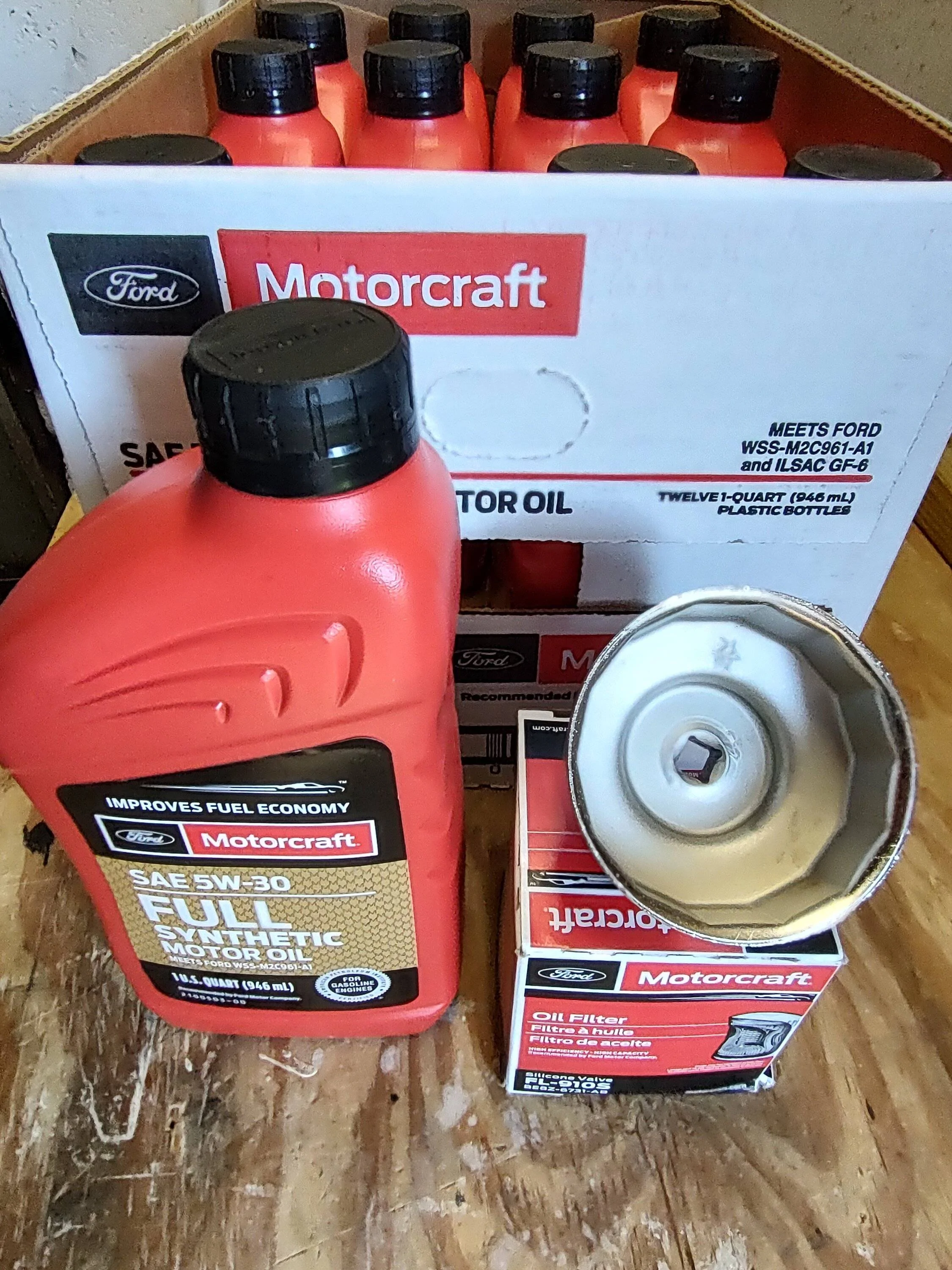

I’ll
Only at 1800 miles and getting things together so when the time comes -
I have what I need in the garage for the first oil change.
From what I seen on YouTube and reading forums it appears that the
...initial oil filter is a different size?...
Is this correct?
If so, what size is the filter that comes on the late model Ranger new?
Thanks for any help on the matter
