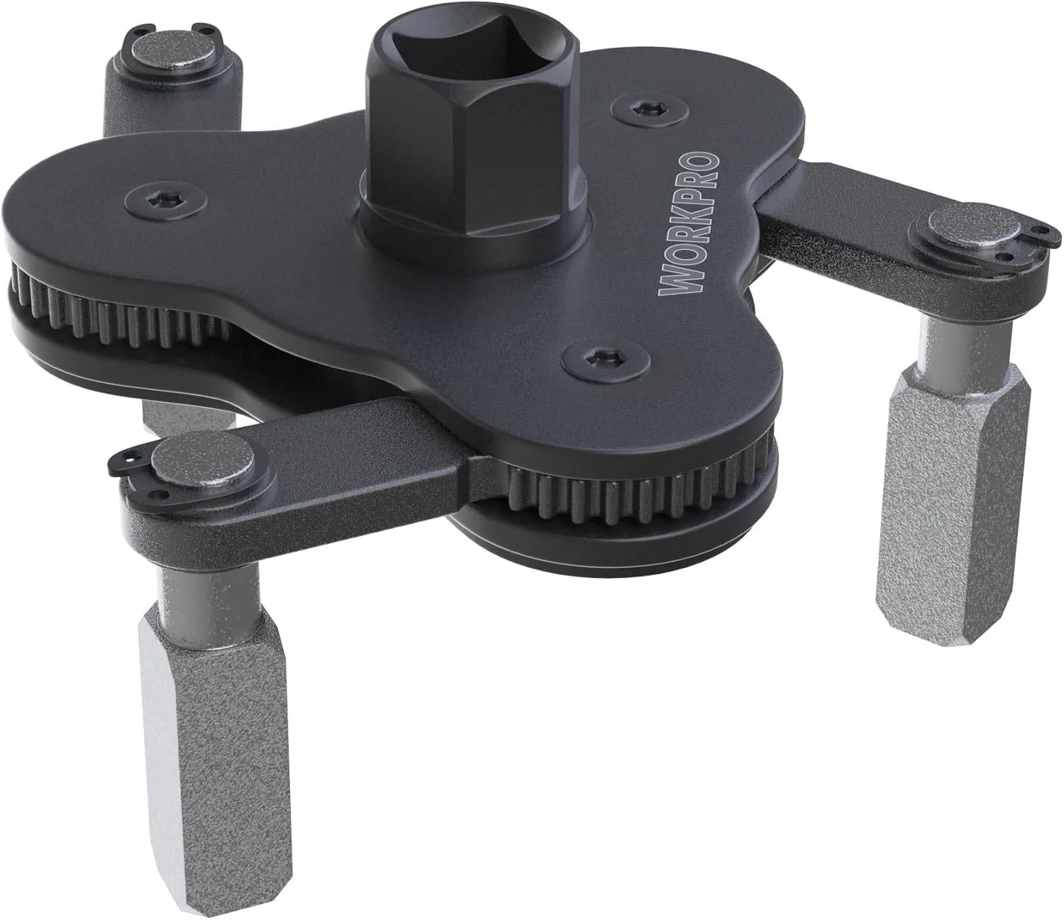

I had the same problem. Having enough room to torque any strap tool, or even a screwdriver poked through it is the problem. I found that the the three arm spider tool, and a ratchet and extension was the answer. Just oil and snug the new filter and you won't have the problem again.

https://a.co/d/96lK1Ku
Bought this a month before my truck arrived. Very well spent $12 or so. Put two extensions together and ratchet works beautifully.

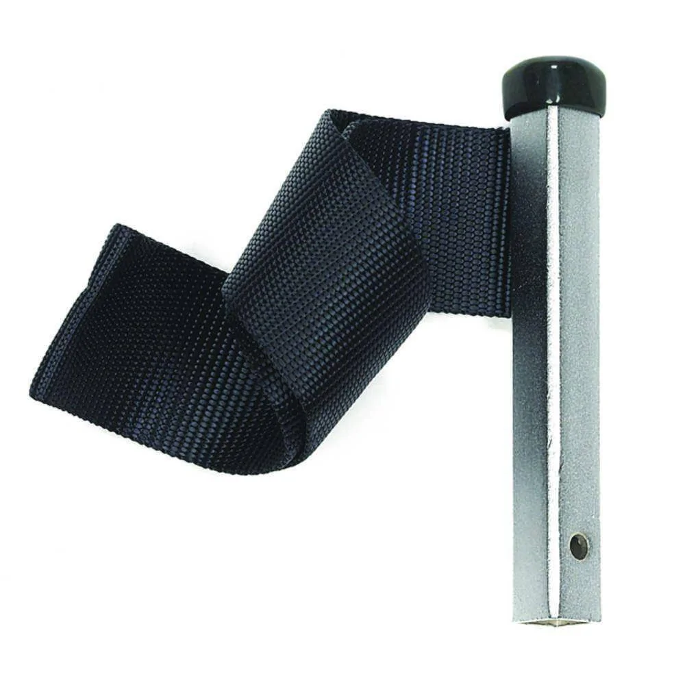

This usually works, but if it doesn't you're f****d, unless you have another car to drive to the shops for something better. I like these type myself https://www.supercheapauto.com.au/p...--rst219/528837.html?cgid=SCA01130507#start=3
But the three jawed ones mentioned in this thread are pretty good and have the added advantage of fitting most sizes.

I’ve destroyed a few filters for removal in my life. I’ve never had one I couldn’t remove - yet. If a filter wrench, including 3 arm and strap don’t work depending on the space you have to work, my most successful tool, even better than the screwdriver through the filter, is giant slip lock pliers. By the time you get there, the filter is already ruined and must come off. If you rip it apart, a chisel or small rotary tool can carefully get the rest. Then just reinstall properly, and you’ll be good.

BTW, I didn’t think my factory filter would come off, but enough extensions to get past the fender and a piece of pipe on the ratchet, with a 3 arm wrench, and it came off. It was a bit bent, so I’m not sure what robot installs those, but some programmer could back off the torque.
