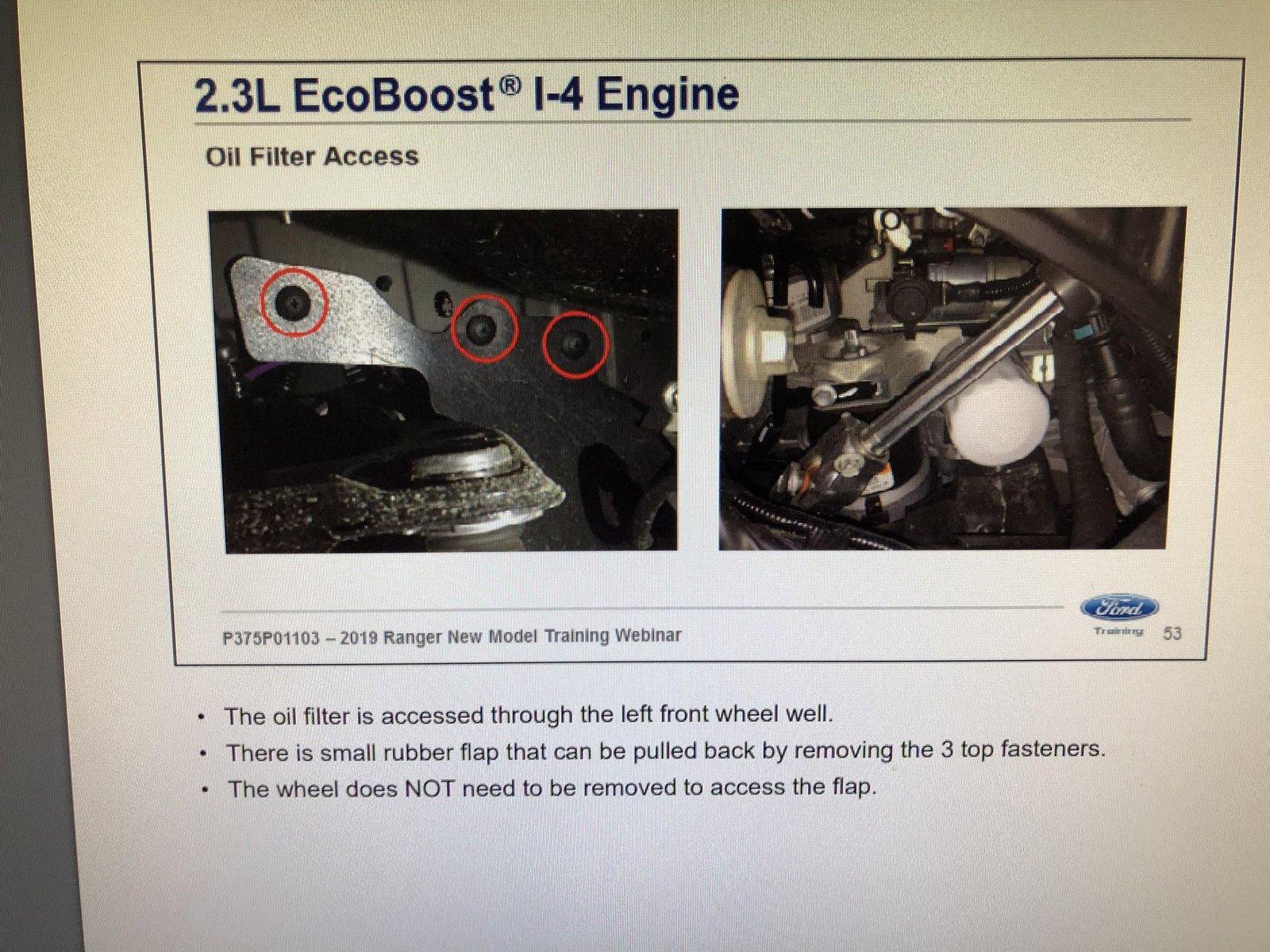

Changing your 2019 Ford Ranger's oil? You better be ready for a few extra steps
By Kyle Hyatt
Updated 1/7/2019 11:13 A.M
Changing your own oil is one of the simplest and most approachable bits of maintenance that you can do for your vehicle -- unless of course, the manufacturer for some reason decides to make the process more of a pain than it needs to be.
According to a report published Thursday by The Truth About Cars, Ford was said to have made the new Ranger's oil filter nearly impossible to get at without removing one of the car's wheels. However, a Ford service training webinar made available to Roadshow states that removing the wheel isn't necessary, though removing three trim clips and pulling back a rubber flap in the vehicle's wheel well is.
The 2.3-liter EcoBoost engine found in the Ranger is slightly different from the one found in other applications. The Ranger's enlarged oil cooler means that there isn't room for the filter to live down by the oil pan, and instead, it was relocated up and into the side of the engine block, protruding at a right angle. This means that removing it is a little less simple than sliding underneath the truck with a pair of slip-joint pliers (please, don't do this) and a can-do attitude.
But things don't stop there. To get to the oil drain plug, there is another panel in the vehicle's underbody tray that has four fasteners that need to be removed. Granted, having to access a drain plug through an access panel in an underbody tray isn't all that weird on a modern vehicle, but when added to the rest of the rigamarole, it's just annoying.
Clearly, this kind of inconvenience isn't the end of the world. And thankfully, it's not nearly as bad as we originally thought.

You have to remove plastic trim rivets. How many times will you be able to do that before you have to replace them? Then there's a panel flapping in the way. And that's after cranking the wheel one direction to make space.
No, that doesn't sound awful, but it is a pain in the ass and it's totally unnecessary. My wife's 2018 Jeep Cherokee is the same way. It has TWO panels that need to be moved to do the oil change, and the oil filter is in such a funky position that it's hard to do on your back in the driveway without slicing your wrist. No reason for it to be designed like that whatsoever!
Compare that to the 3.6L engine in the JL....I can literally change my oil and filter in 3 minutes start to finish.

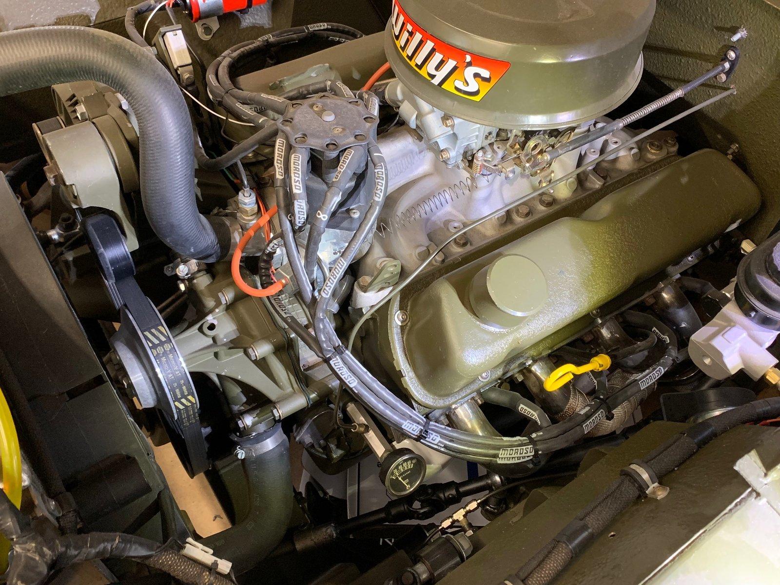

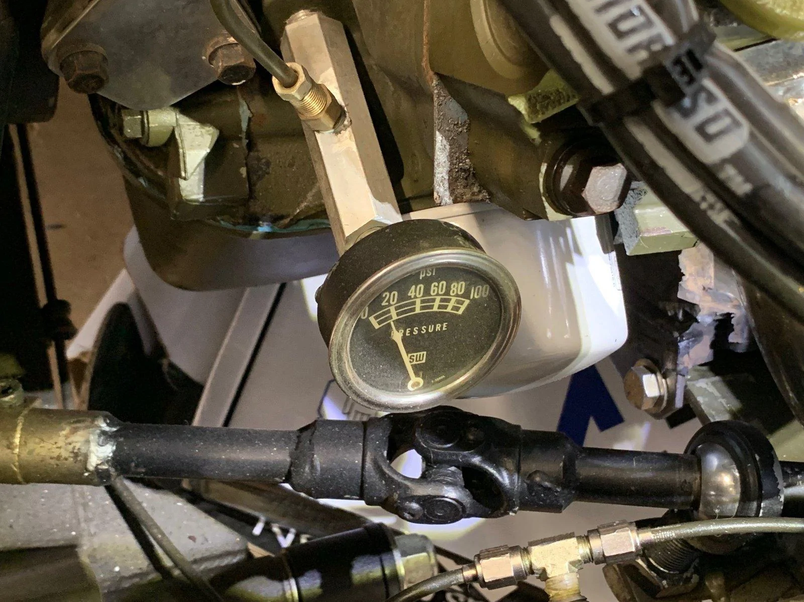

I'm in the group of "WGAS", I'm used to it. My Jeep has to have the steering shaft disconnected and moved to remove the filter. I had it remote but didn't care for where It was mounted.

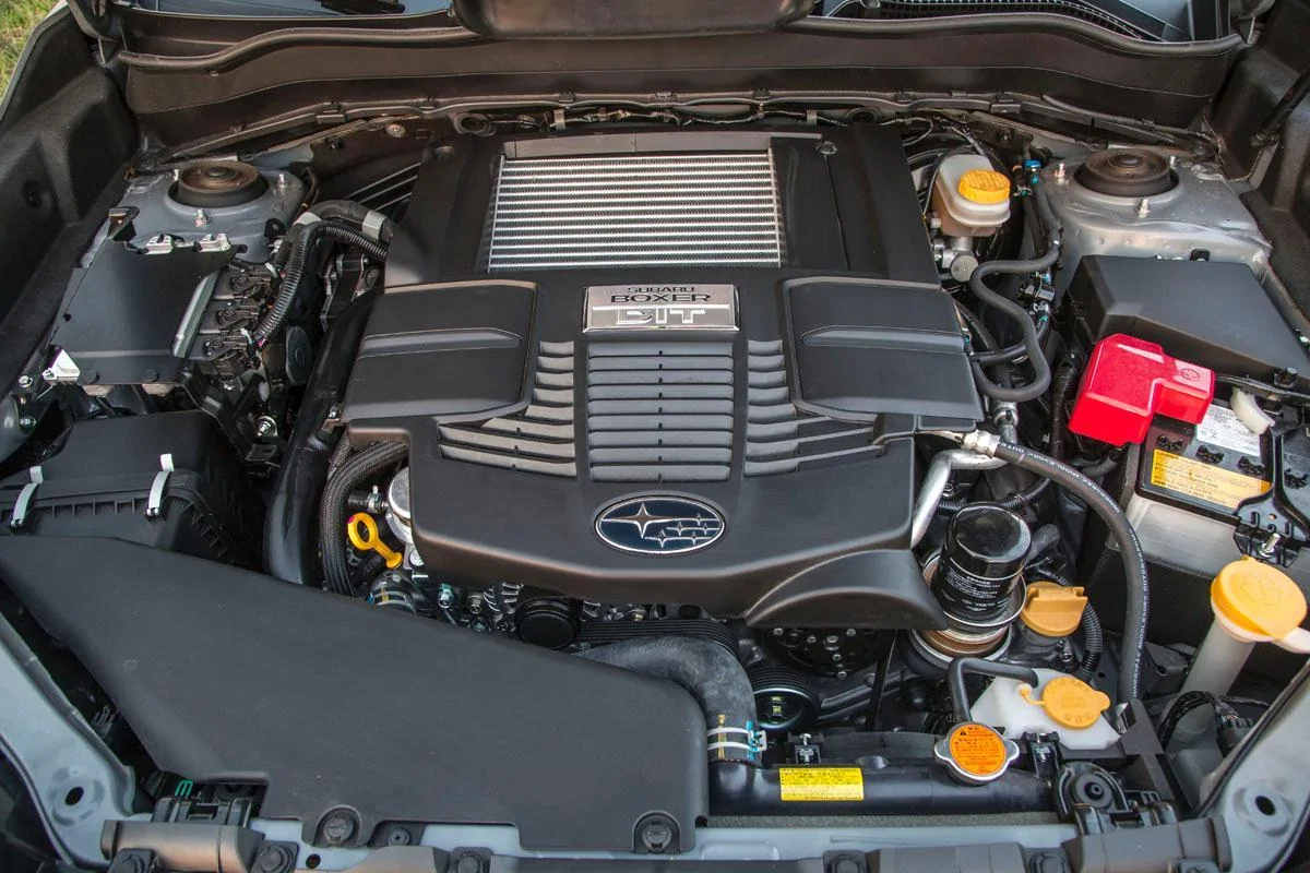

I'm trading in a Subaru Forester for my new Ranger (I need more towing capacity). One thing I will miss is that Subaru puts the oil filter ON TOP of the engine with a handy drip tray that returns spilled oil to the pan.

That's a great spot for easy removal. I don't understand why engineers put oil filters in the most difficult locations to replace especially when designing engines from scratch?

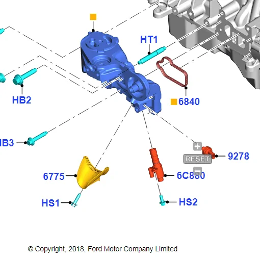

What does this diagram show?
