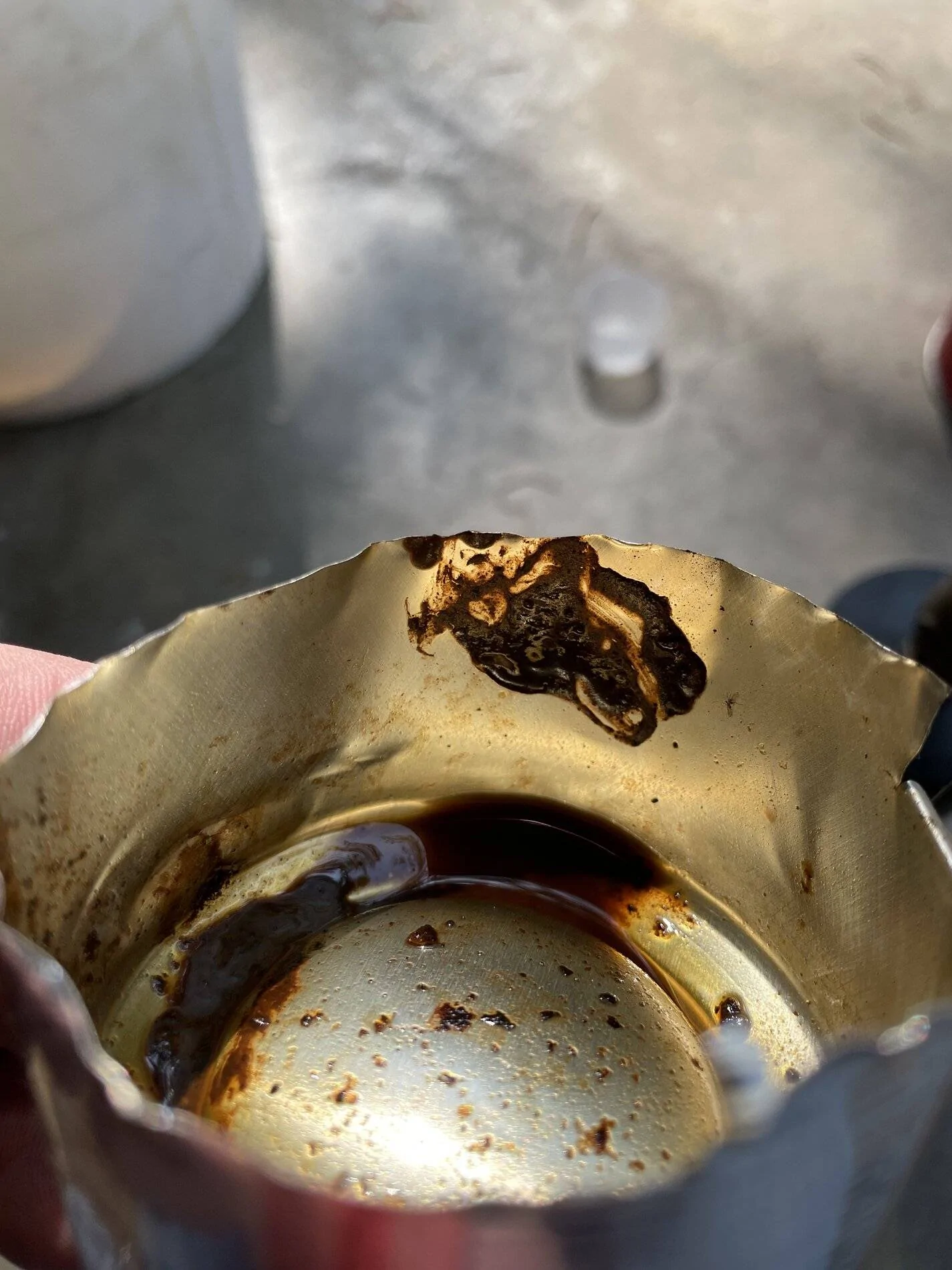

So two weeks ago I went to drain the catch can and nothing came out. Thought oh it’s been dry out here probably not a whole lot of built up fluid. I was wrong. Took off the can today and it was completely gummed up with crap. Took it apart and cleaned the hell out of with with my trusty carb cleaner. The picture is of the chunk of crap that dropped out of the drain once I broke it free. Just reinforcing why I’m glad I installed a catch can
