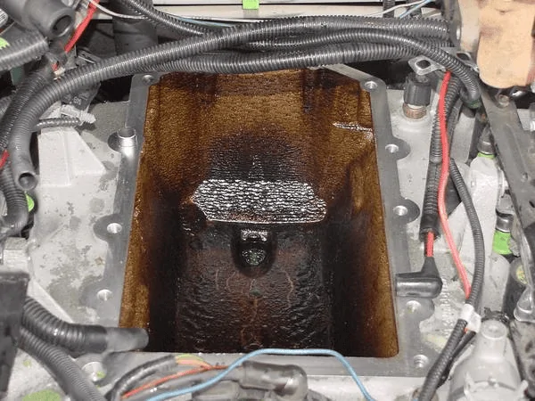

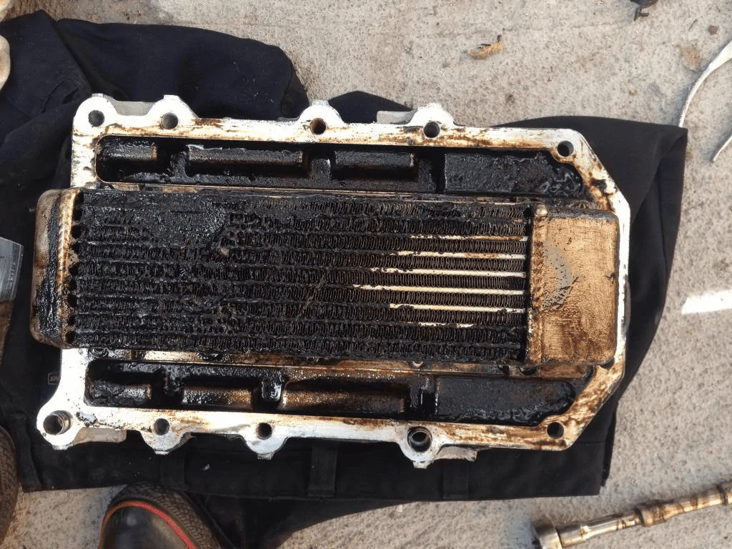

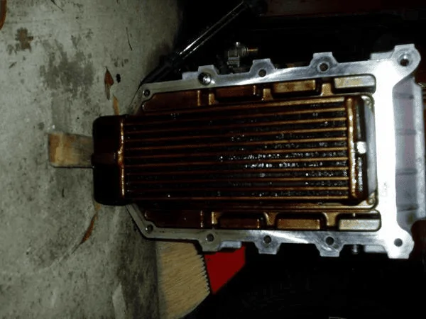

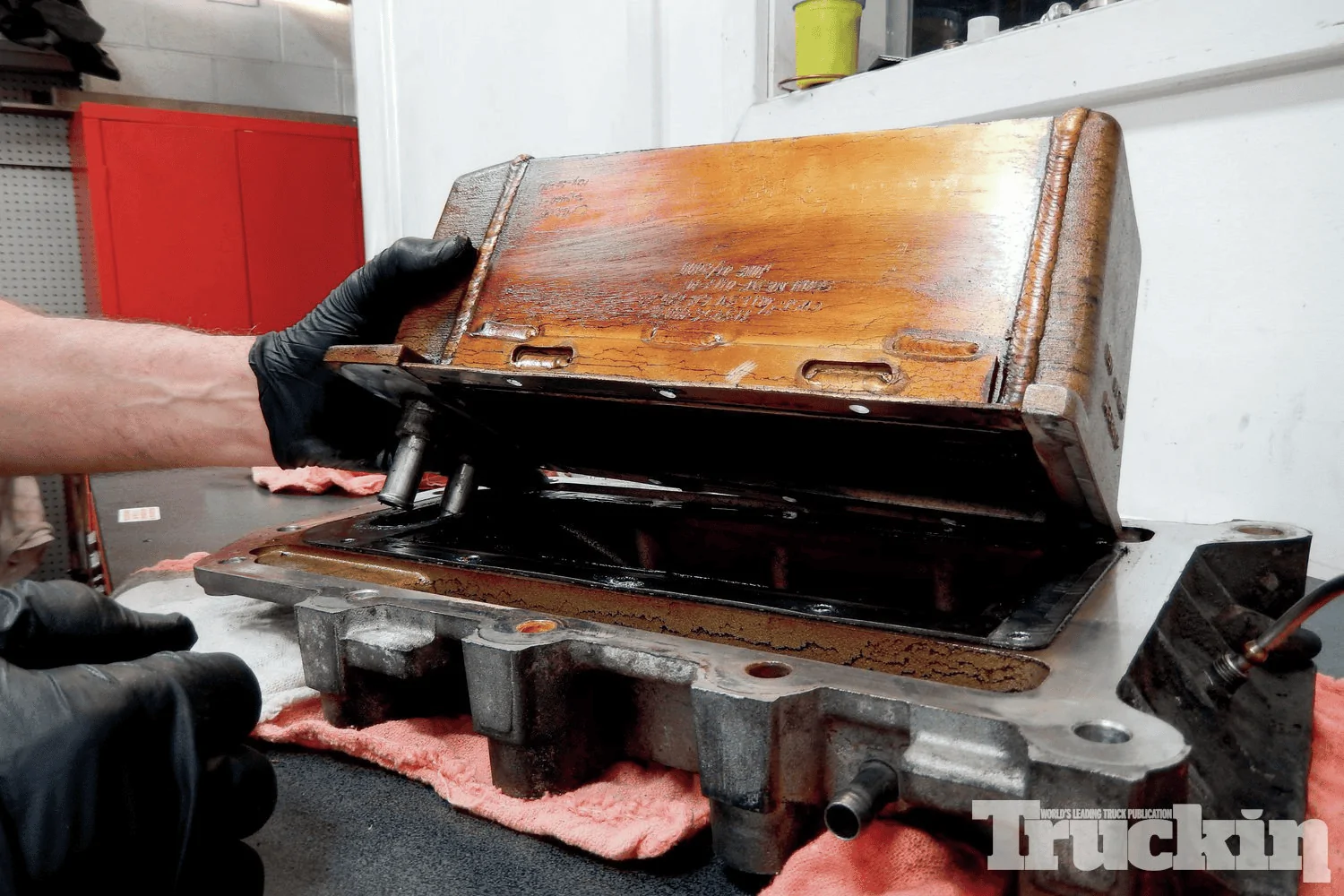

For instance, the old supercharged F-150 Lightnings were bad about the intake filling full of oil below the intercooler which would allow the oil to go into your intake ports and dilute the combustion mixture. It was A LOT of oil. I know, I owned a 2000 model and took the supercharger and IC out to clean it before I installed a better PCV valve and a catch can system that would allow me to drain it off before it entered the intake. It was a large pool of oil that collected over time. By the same logic as a full catch can dumping into the intake and wrecking an engine, this should have done the same, but it did not. Even with the supercharger sitting right over it and plenty of boost (16lbs in my case) pushing it. Now did it dilute the intake charge with oil and create the possibility for detonation. Of course it did. That is why us Lighting owners installed a system to mitigate that possibility as much as possible.
Some examples that have been left too long and the oil started to coke up. Mine was still clean and liquid because I believe in changing my oil often and Blackstone can suck it.
