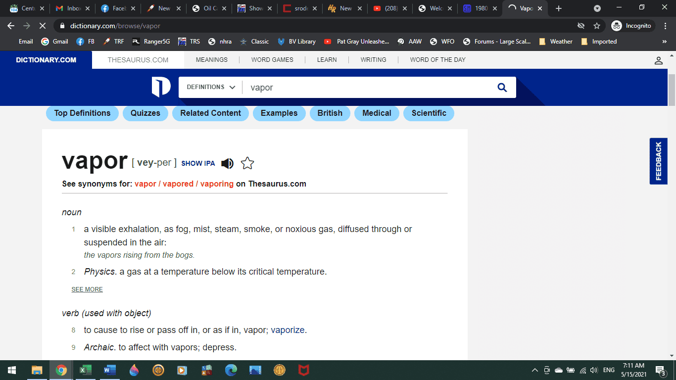

But the question should be is the catch can making vapor into liquid or is there truly liquid going back into the engine?
Of course the can is condensing / separating vapors into liquids. How else do you think the liquids got into the can?
Of course there are liquids going into the engine... that's what vapor is.. fine droplets of a substance and air.

Not exactly what I was asking. I understand that vapor is liquid in a gas state. The point I was trying to make, is the catch can creating a need where there is not a need? If the engine is designed to recycle the oil and gas, is the catch can doing more harm than good?
I do not think I would want to empty a catch can out multiple times a week (depending on driving habits). It would seem to be a poor design if the engine is not properly recycling the oil/fuel.
