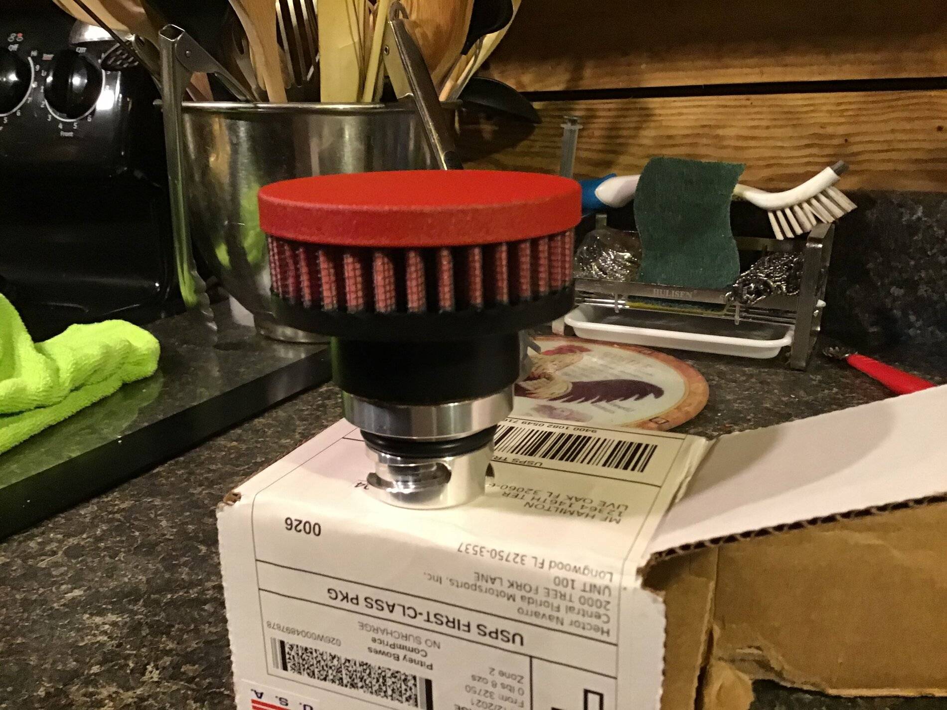

CFM Crankcase Breather
It’s function is to remove the positive pressure that can build up in your crankcase as a result of blowby.
What part # is this? What benefit in using it?
it's function is to remove the positive pressurethat can build up in your crankcase as a result of blowby.
There website shows no application specifically for the '19-'21 2.3 Ranger,
only for '2012-2016 EXPLORER ECOBOOST 2.0 & 2.3.'
Do you have knowledge that it fits our trucks?
This one fits or I guess you can use their “universal”
CFM BAFFLED BILLET VALVE COVER BREATHER KIT FOR 2015-2016 MUSTANG ECOBOOST

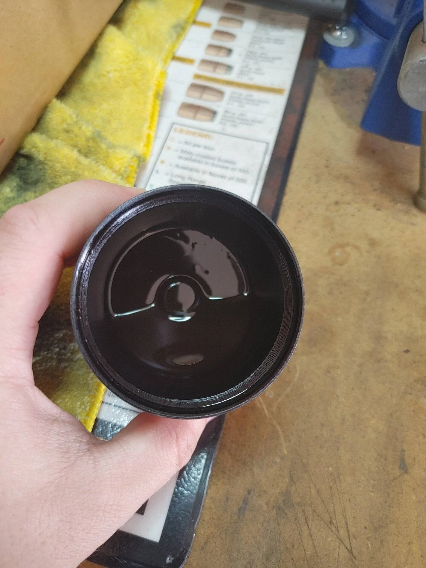

I have the mishimoto catch can have had it on for about 3k miles now. Checked it after 500 miles and not a drop. Checked it today and got about 6.5ml. No fuel smell at all. Glad to see its doing its job.
Since you live in Arizona where it is warm and dry most of the year you shouldn't see much in your CC. I've had the Mishimoto can on for about 40K. I catch almost zero oil/fuel vapor in the warm months and ALOT when it gets cold and snowy in the winter. When I say ALOT I mean I have to empty the can at every refuel. It gets to be a hassle so I'm going to install the drain valve kit they sell so I don't have to unscrew the can....It gets hard to remove when it's cold, even with a little oil lube on the threads. I definitely believe in catch can's on these motors. When I think about how much vapor my engine has captured over time....WOW!

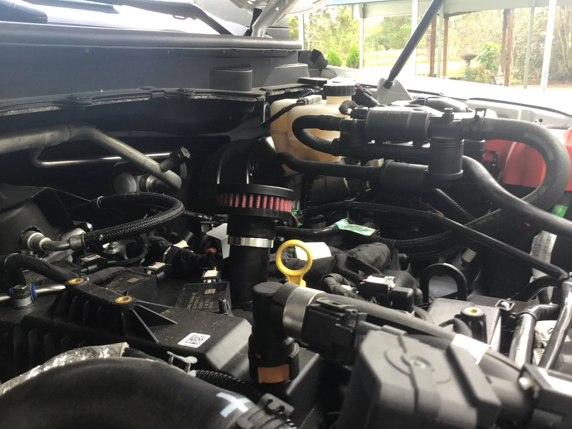

Hi @Doc , when you installed that did you change anything else about the system? The reason I ask is because I tried something like that a few years ago, though it was a smaller vent. I had a catch can on the PCV return path but no can on the crankcase/turbo inlet side, so I tried disconnecting the turbo inlet return path, capping off the turbo inlet port, and adding a vent like you show, although a smaller one.
It worked for a a while until I was heading up a long grade toward a mountain pass, when the system threw an error and disabled the turbo, putting me in 'reduced power mode' or something like that. I can only assume that the crankcase pressure was too high. I pulled over, reconnected the normal crankcase path, restarted the engine and everything was OK. After that, I added a second can on the crankcase turbo return path instead of the vent. It seemed like just venting the crankcase wasn't good enough. If this has worked for you, maybe the size of the vent matters and mine was too small?
No I just added it after my 1st Blackstone report with high fuel dilution. It is now less than 0.5 %.

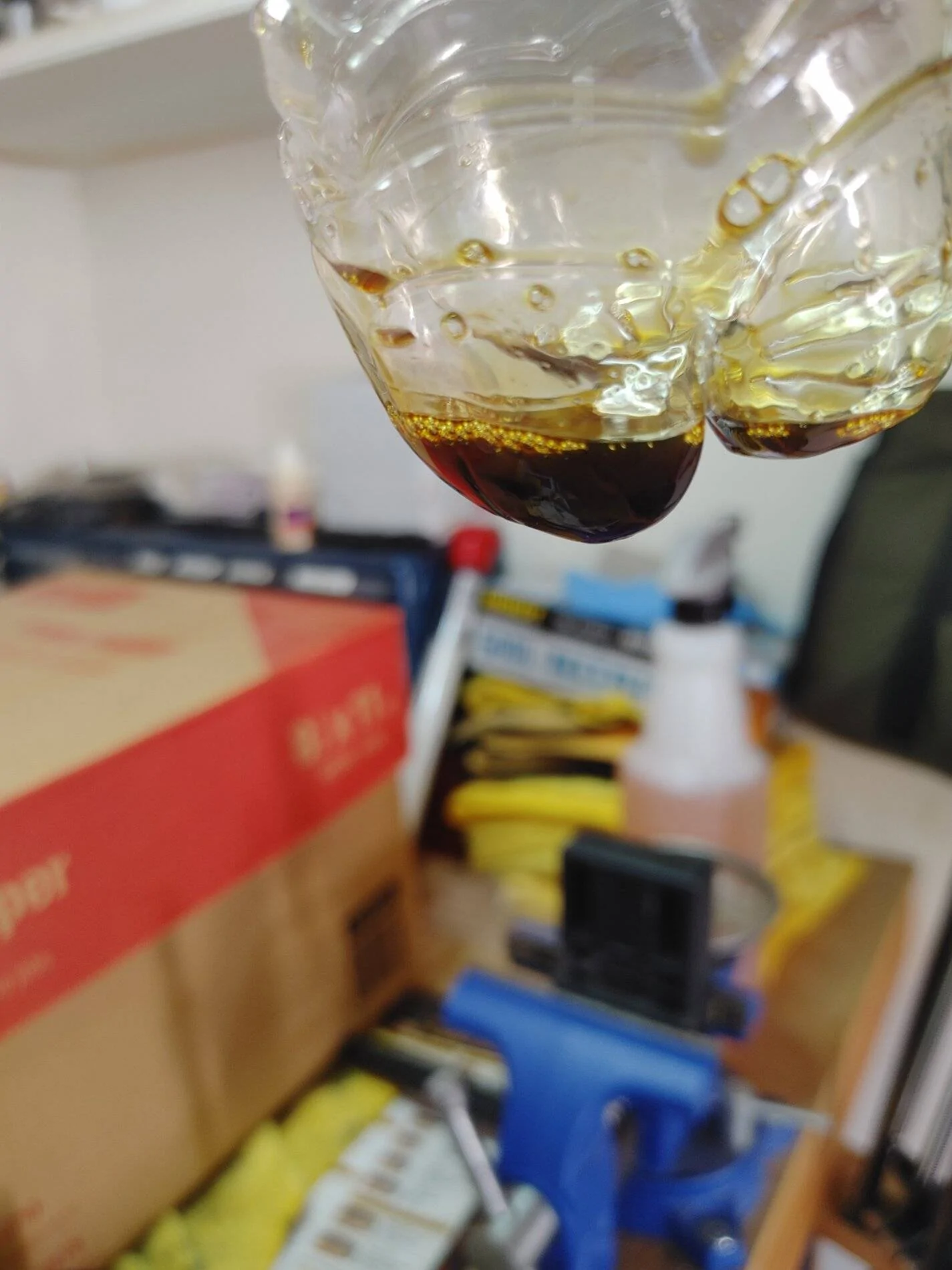

I've only had my UPR catch can on a few days so I didn't expect anything to come out of it
(or I'd have put a container under it to see how much was in it).
Opened the valve (drain hose comes out at the bottom edge of the air dam) and several ounces of watery oil/oily water came out onto the gravel.
Glad I have the can installed and that stuff isn't going into my intake !
