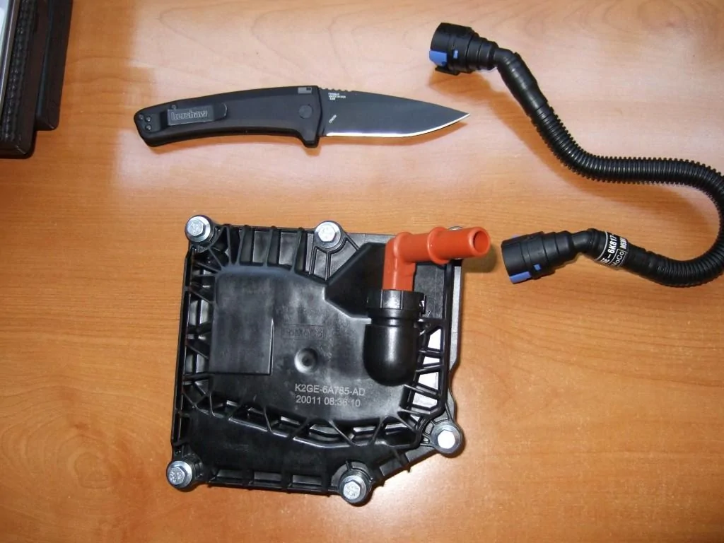

Any luck with that installation... I'm having problems getting my arm up there onto the crankcase side connector... the video sure makes it look a lot easier than its turning out to be.
The UPR instructions leave a lot to be desired. Watch the Mishimoto catch can install video to see how to best remove the hose.
It is a royal pain to get to them. This is from memory... Once you pull the flap, there is an electrical sensor that needs to be unplugged running parallel with the 1.5"-2" diameter water hose, next push the water hose from its attachment point and move the hose up about 4"-5". this will give you room to identify both the hose ends, but it is difficult to see them. On my engine the intake was yellow, and the PCV end was a 90 degree red elbow. It will pivot in it's mount. It was easier for me to get to it when I rotated it to point away from the block after I released the intake side.
Here is a picture of the oil separator on the Ford 2.3L GDI Turbo engine. And that is the hose you are removing. The short end goes to the intake, the longer section to the red connection below. The separator is tucked in under the intake manifold. The blade is 3.5" long to give you some perspective.

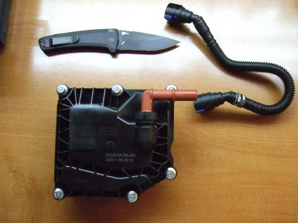

I rotated the nipple. When working on my truck I thought I had broke it when it moved and picked this up to validate all was well and I didn't need to use it. It wasn't very expensive but to install it the intake manifold has to be removed. So don't break it!

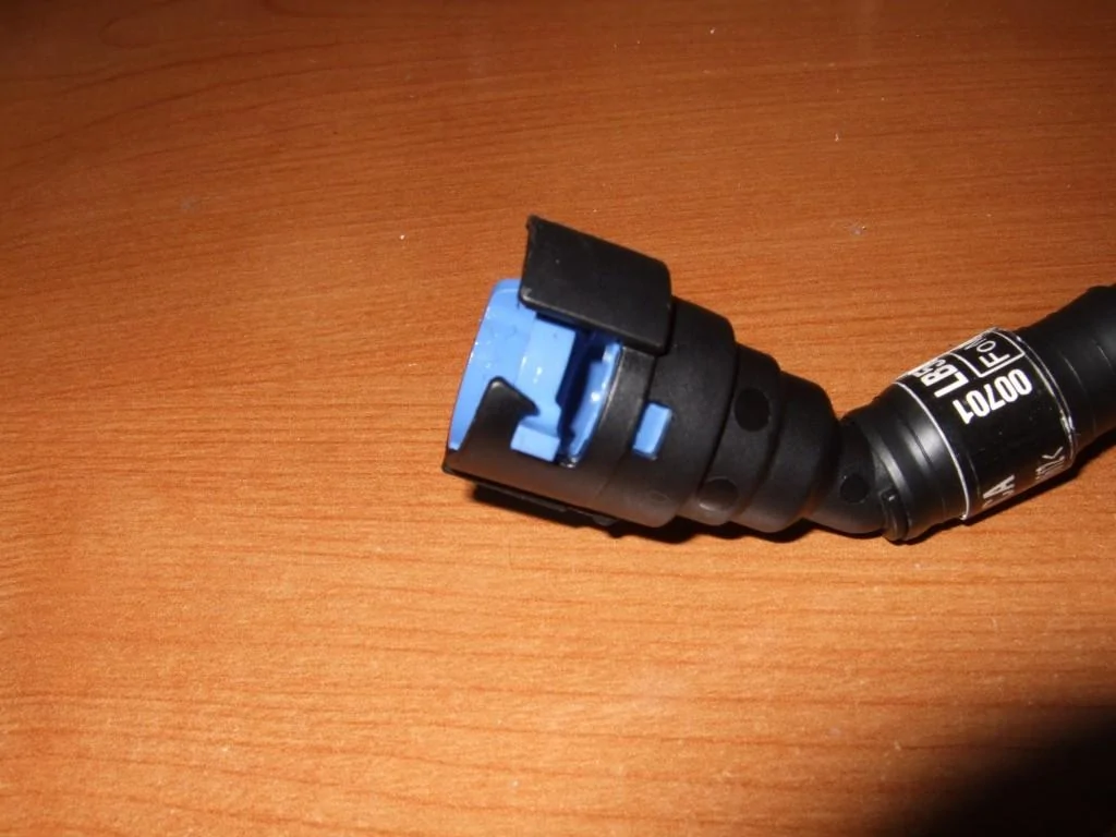

As I mentioned previously I pulled the intake end of the hose off first by moving the tab towards the hose and up counterclockwise. Here is a close up of the hose end. The tab to move is blue.
Once you remove the old hose be very careful to install the hoses to the correct ports. Do not get it wrong. Removing the new hoses are just as hard as removing the originals, and they may be harder to unlock the clip

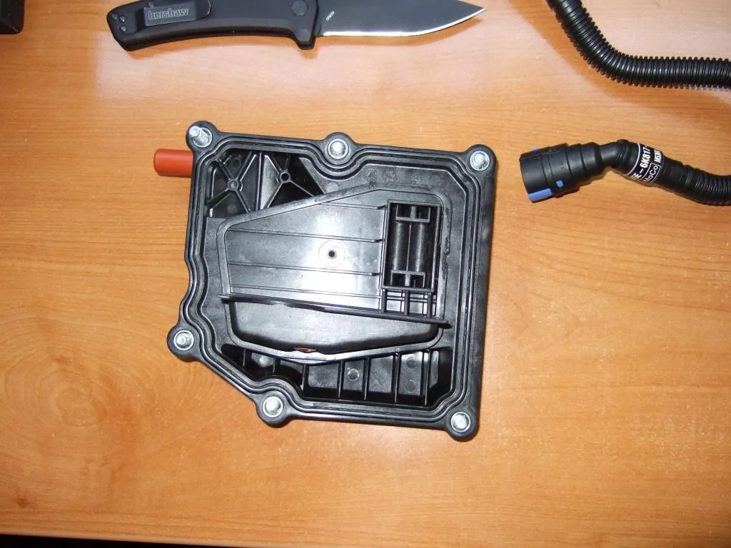

Just for kicks here is the business side of the oil separator. There is some serious engineering in this piece of plastic.
