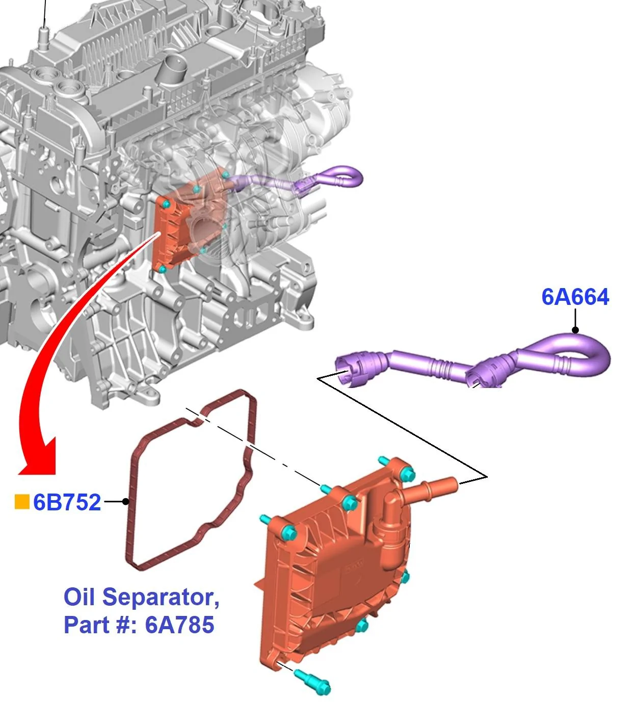

There's gotta be a reason Ford added the oil separator to every GDI Ranger.. I'm betting their in-house testing showed it worked good enough to get the motor through the warranty period without any coking issues.

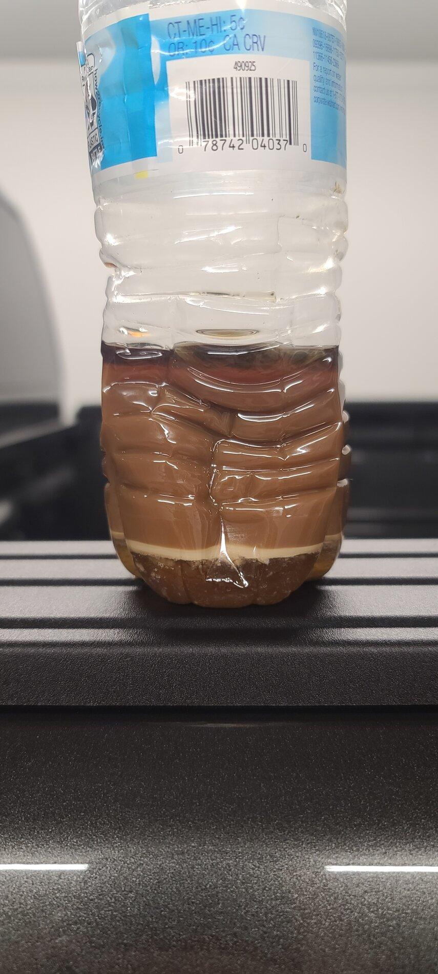

Just so everyone knows....I run Mobil 1 Extended 5w-30 with a Motorcraft 910S filter. Change it every 4k to 6k. I'm filling up with Sams Club 91 octane at $2.21/gal right now. I run approximately 110mi/day on the Interstate. I'm keeping track of how much liquid I am catching daily....more to come.

why not an air/oil separator? Then you could skip the maintenance. Initial cost and install would cost more though.
Do you know what system Ford uses to separate oil for PCV?
Oil Separator, Part #: 6A785. On the side of the motor, between block and Turbo

Transient
I have very similar results. Near as I can tell it is a water, fuel, and oil mixture. My Blackstone test came back fine so I am not going to fret over it. Truck runs fine.
My Blackstone test came back back very good, but the action of the catch can might be part of the reason for that.
I believe it is. I also believe it is mostly water (condensation) in my case. But everything we empty out of that catch can would be sent back through the system. I am glad I opted for the can.
