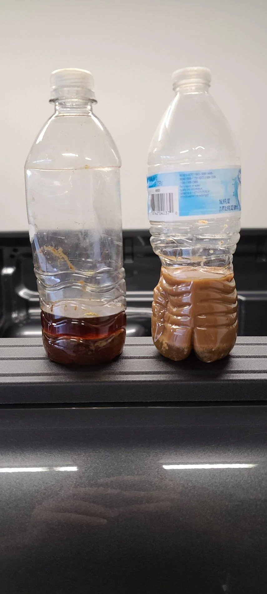

No the Mishimoto was not dual valve.
The lines, can and valves are very high quality on the UPR and with out a doubt will out perform and outlast the mishimoto.
The mishimoto during the winter was a pain because the can has so much less capacity I had to keep a close eye on it or it would completely fill with condensation and fuel.
You can see that the UPR on the right is catching alot of oil during the summer. While over 10k miles of winter driving the mishimoto on the left was catching alot of moisture and fuel with the little middle layer of oil.
The UPR water bottle on the right only has about 5k miles in it. View attachment 62612

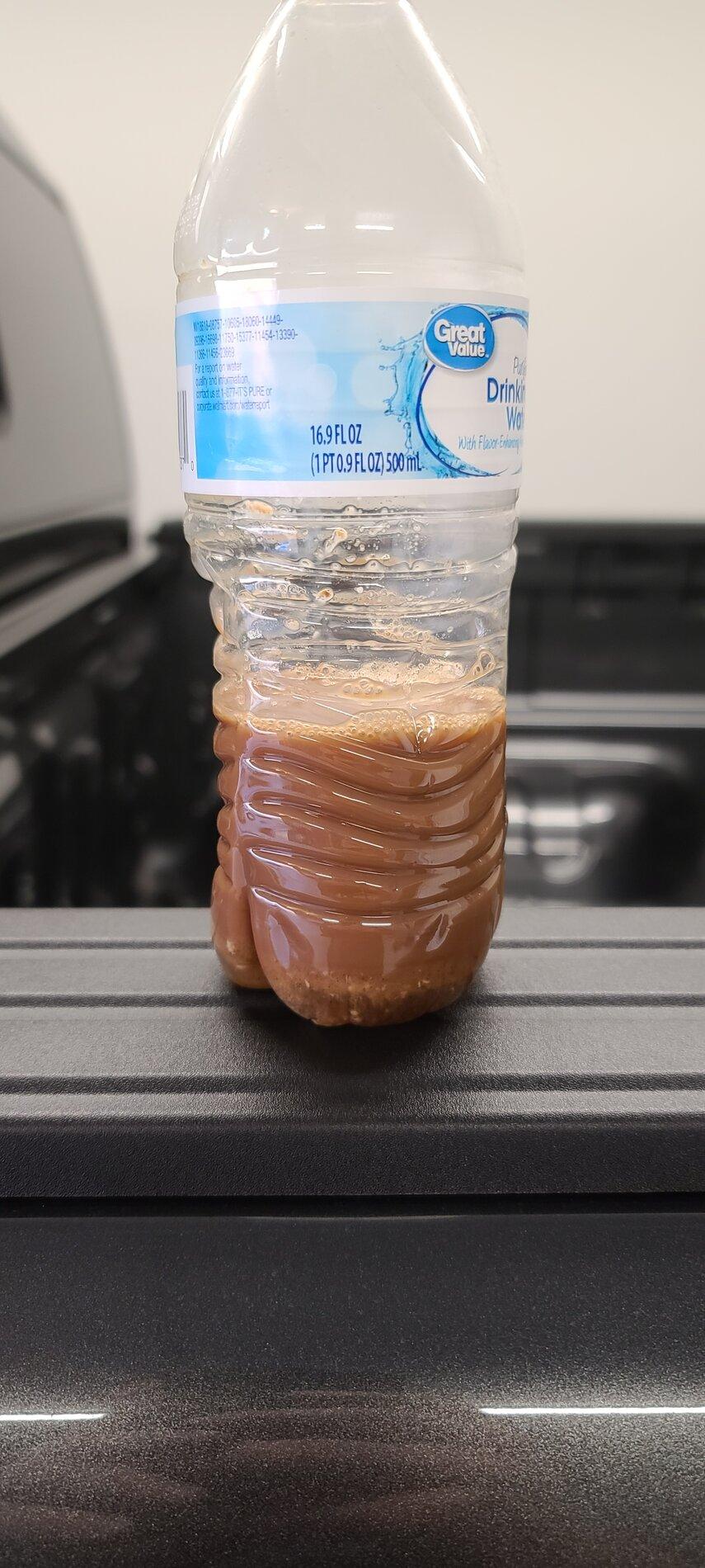

During the cold these cans fill up QUICK. I was emptying my mishimoto every 1-2k in the winter.
I just emptied my UPR for the first time in a month (its cooled off) and sure enough look at all that water.

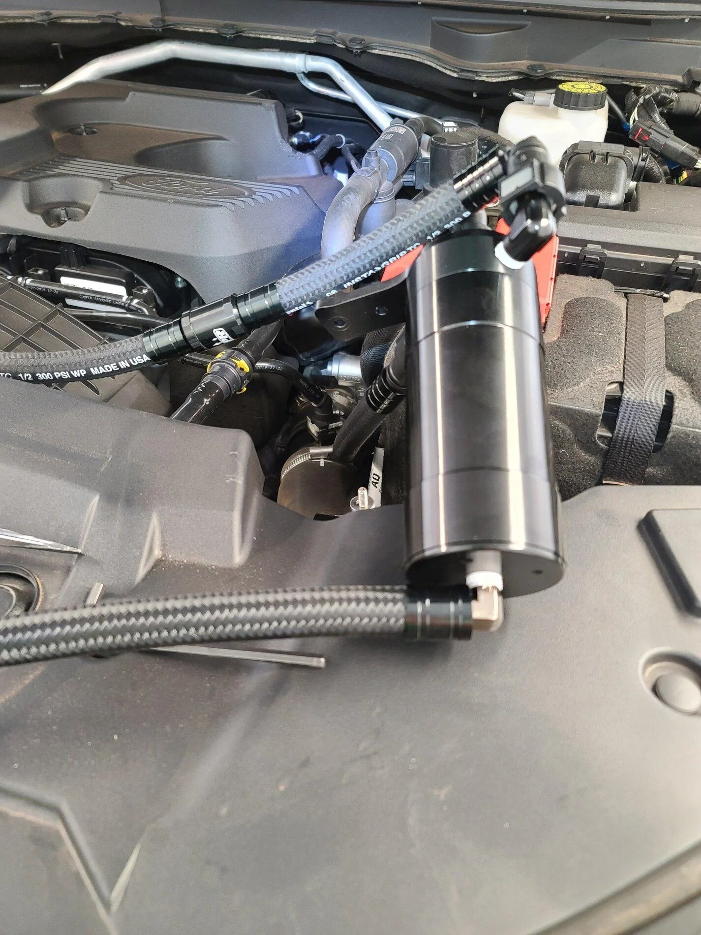

I installed the drain line that comes with the UPR if you option it. You can see the 90⁰ elbow in my catch can picture coming out of the bottom. I ran the drain to the wheel well so it's quick and easy if the wheel is turned all the way to the left.

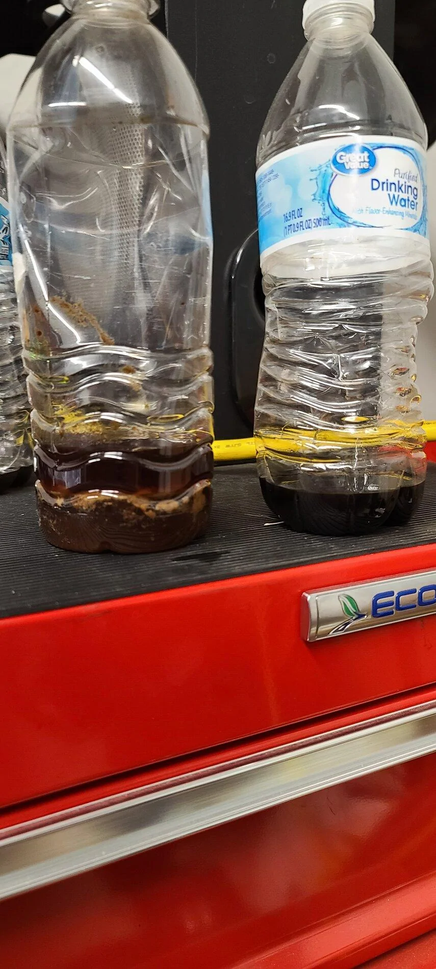

Here is Mishimoto (left) with 10k miles of mostly winter and UPR (right) with 7k miles of mostly summer. I just filled the UPR bottle, so it hasn't had time to separate like the Mishimoto sample.

Definitely smells like fuel...I’ll try to light it and see what happens.
I’m going to empty again tonight and see where I’m at. I’ve been tracking the mileage better this time.
So if it is indeed fuel, and it had run back into the intake (without a catch can) it would help to clean the gunk off the valves....

Its a mixture of fuel, water and oil. When we think of fuel cleaning intake valves we think of port injection, which this mixture oozing its way though your intake manifold and sitting on the valves is nothing close in comparison.
Even on port injected vehicles I ran catch cans for the benefits of keeping the oil out of the combustion process and to keep it from pooling in the intake manifold.
