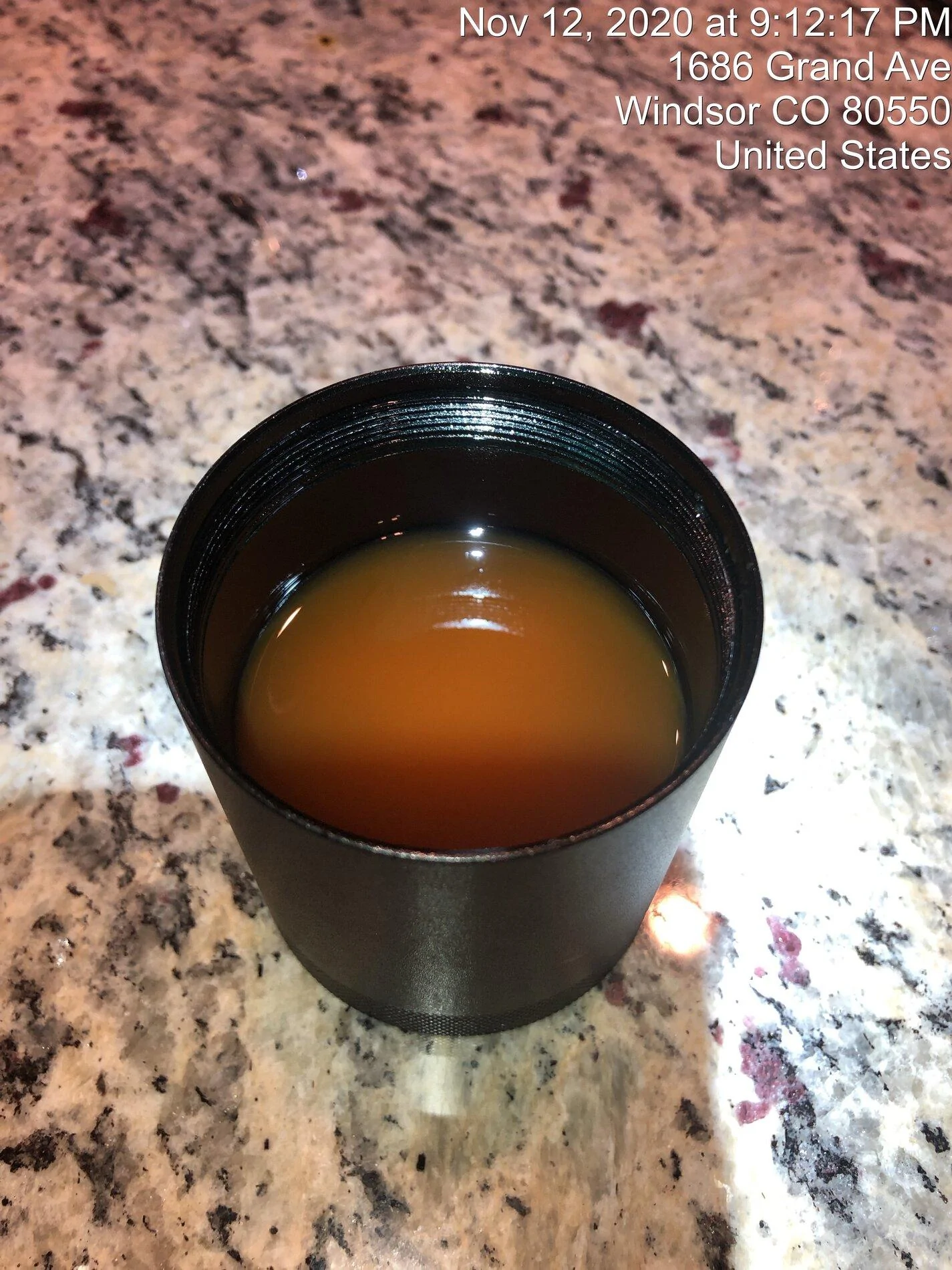

Based on what I just emptied out of my newly installed Mishimoto catch can...better get one on quick! Nasty stuff going back to your ecobeast...

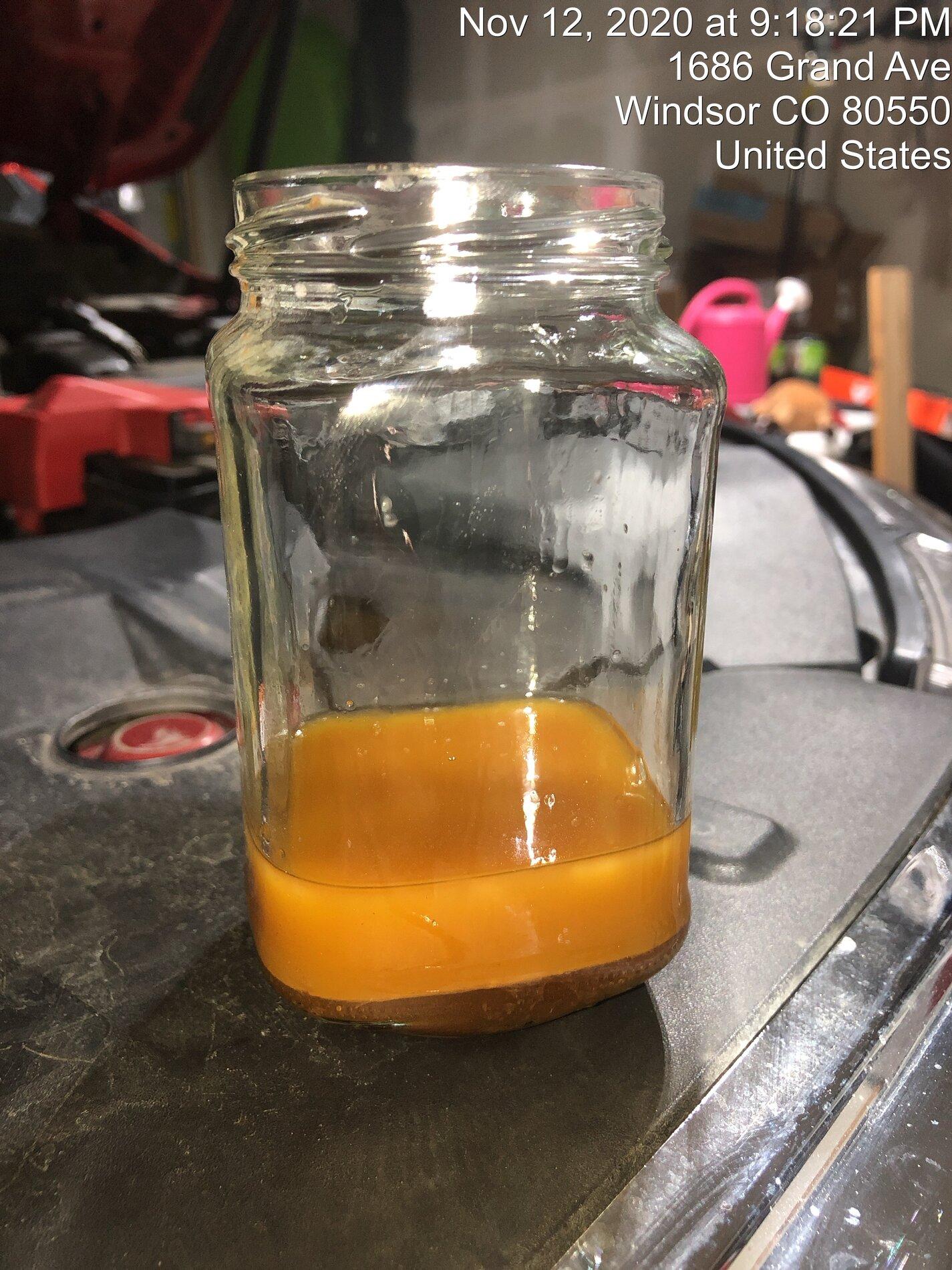

Check it out
That's a lot, no matter what it is. How many miles from the last time it was drained?

1st drain of the catch can. I'm guessing about 2000 on the mileage. To be honest, I wasn't really keeping track because I wasn't really expecting to see much in the can. I will be keeping track now. I commute about 106 miles a day (53 each way) so I will be checking it this evening when I get home and will post my results after 1 commute. That should tell me how often I need to empty.

That was a pretty dramatic fill you had in that catch can. I have never gotten even close to that with my Mazdaspeed. I know the Ecoboosts are bad about fuel dilution in the oil, I have even noticed some in my Ranger and thus change the oil more often, but have been holding out on a catch can in the hopes that more info would be available on its effectiveness in our platform. You see a lot of opinions on their usefulness in the 2.3 Ecoboost.
Questions... Do the contents smell like fuel? Have you tried to ignite it?
