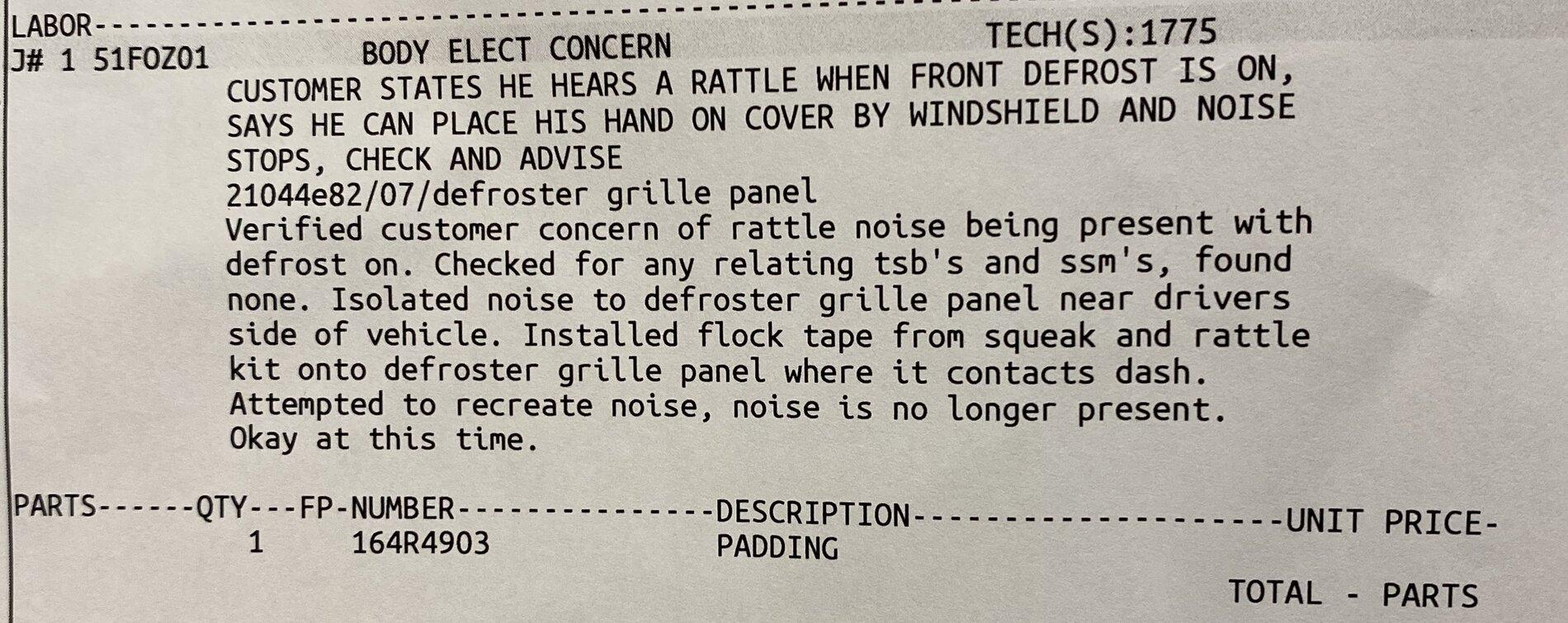

Got my Vehicle back from the Dealership last night. They said they noticed the rattle as well and said they put a piece of felt under the dash on the pin or something like that to stop the rattle. Not sure if that was just a good tech getting creative or not but it seemed to do the trick! My Driver seat was also loose and they were able to tighten that up as well. They also fixed the TSB about the Cold engine rough shifting and the Recall inspection. Overall I was very happy with the result and didn't have any of the BS that we sometimes get back from the Dealers!

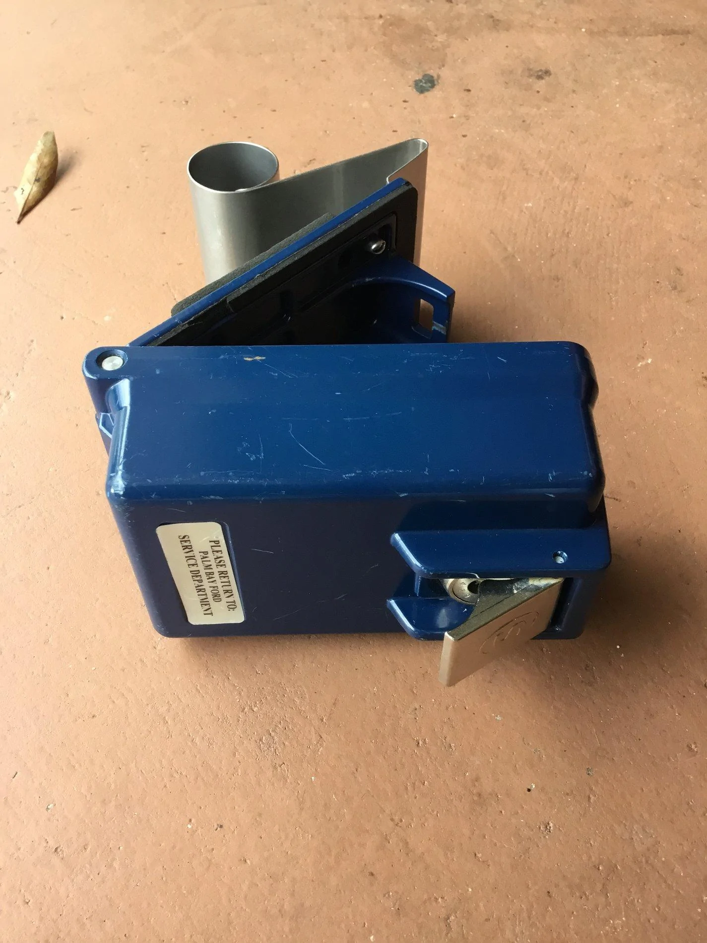

Just picked up 19 SCab and within only a few miles noticed a really nasty rattle. Had some time to poke around today and found this under the drivers seat! ;)
What the heck is that?

Key lock box.

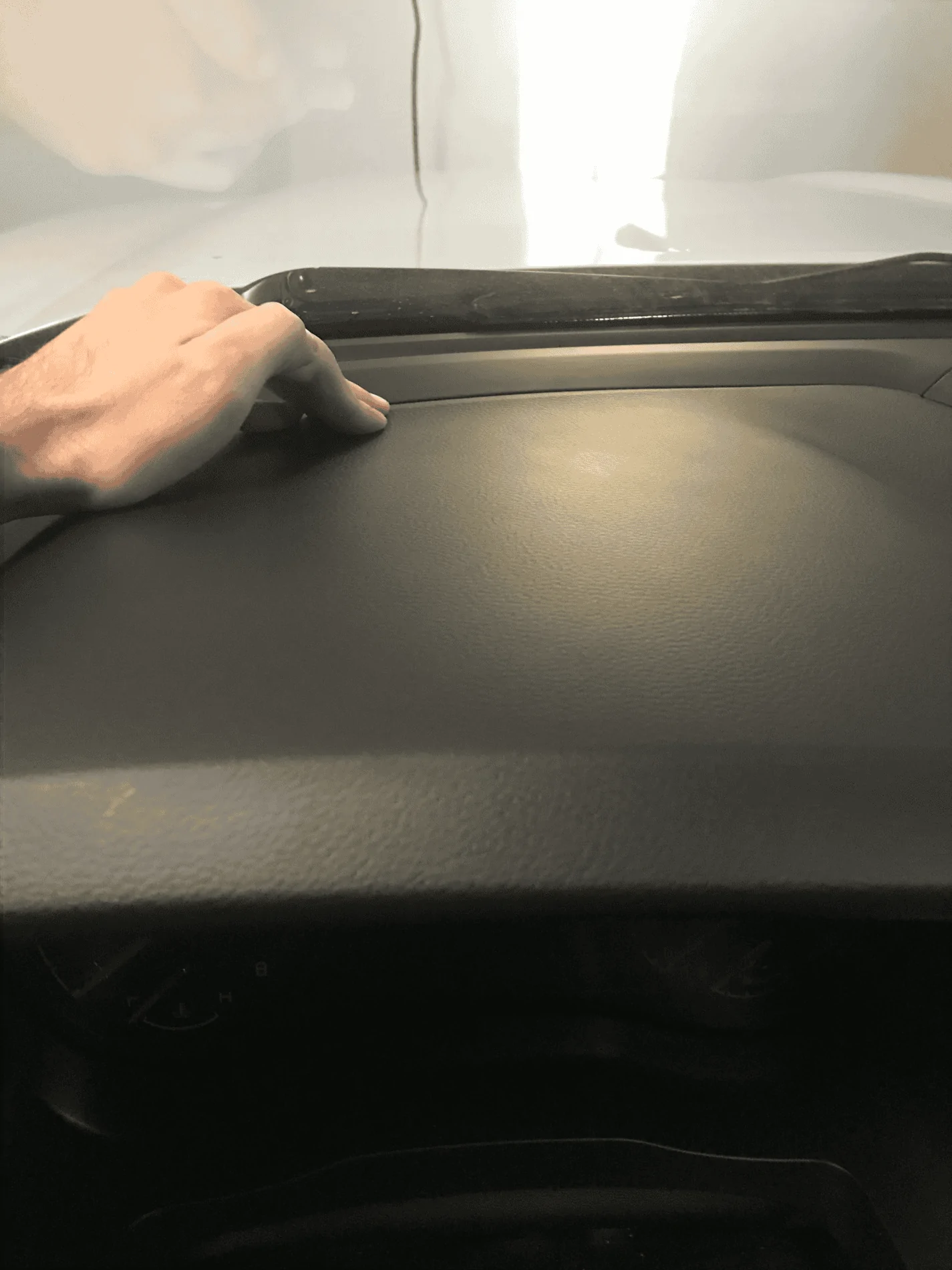

I just dropped my truck off tonight for this rattle. I was able to capture the sound. I can confirm pushing down on the very front panel coverIng the defroster vent stops this rattle immediately. Hope they can fix it.

This is the only rattle I have ever heard in mine….it has not come back since My dealer fixed it.

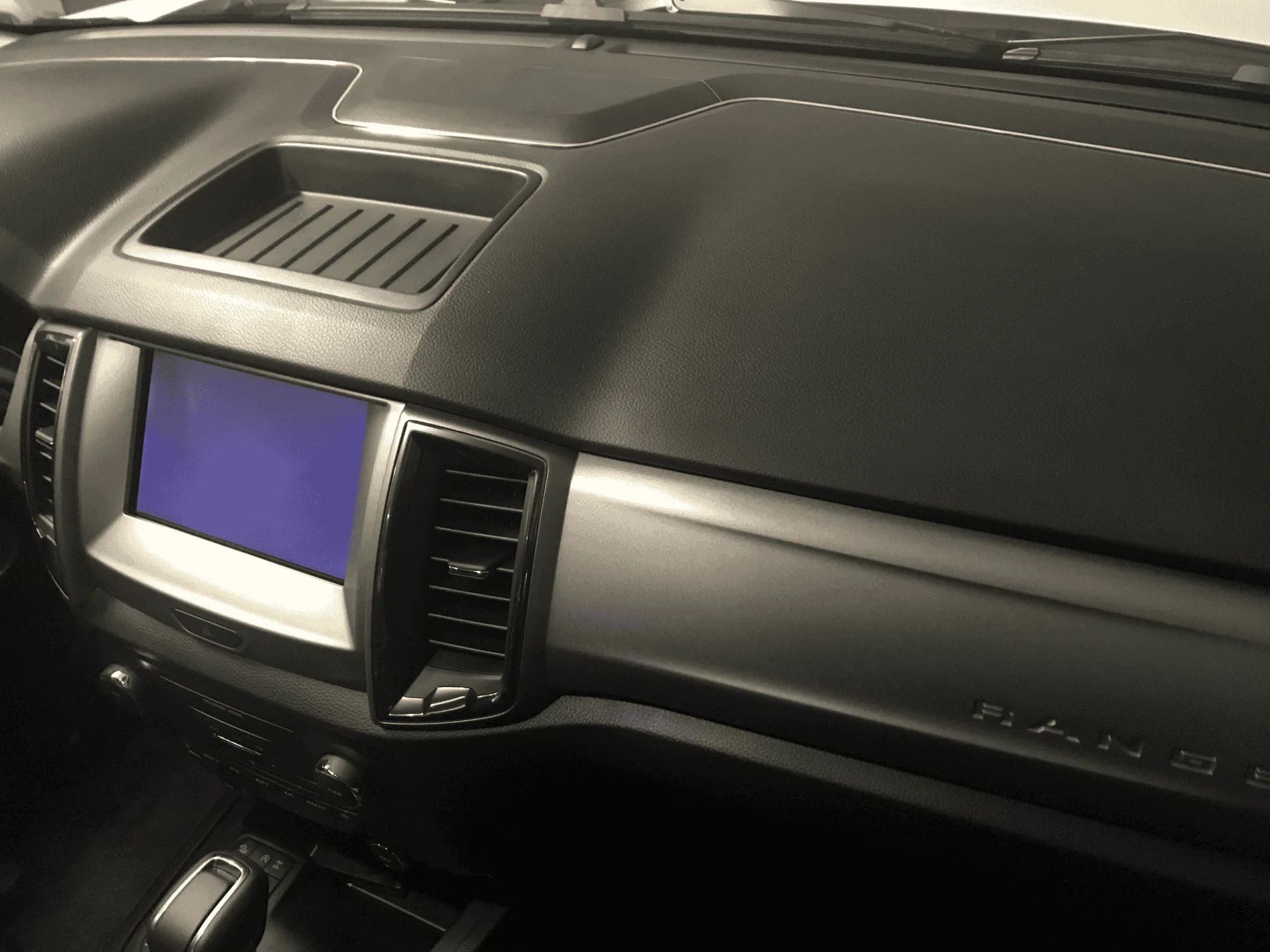

Same, my ranger has been great so far. Just the rattle is quite annoying especially on a new vehicle. I have added a second nine inch long cut of the one inch backer rod in front of the original one (since you get a good 10 feet per bag).
I have attached a very crude side view drawing of this change (sorry for spelling error :headbang:.)
It keeps the backer rod more secure since it has something to back up against, and keep it in place. I used one of those inspection cameras to see behind the dash to make sure i wouldn't break anything. i could see circuit boards and electronics a good 2.5 - 3 inches in the cavity, but before that there are two plastic standoffs/ramps that support the dash about three inches in from both sides of the nine inch baker. I am not too sure where everything lines up when the backer rod is in there since you can't get a ruler or camera back there to see.
I will add to this thread after a few days of driving with the extra backer in it. I will see if it quiets the rattle even more, or it damages anything.
The extra backer defiantly made the area over the gauges even more rigid, pushing down on the weak part of the dash over the gauge cluster required much more effort to see under the defrost bezel.
Thanks @Alex. I tried my own material using some large and small pieces of D shaped Rubber weatherstripping. I was glad to know that it is important to tuck some material under the dash as that is poorly supported. I put a piece of 1 inch or so weather stripping under the dash (left over from my tonneau cover) and used some smaller pieces (.649”h x .57”w) in front the Colliision LEDs along the trim piece. Also I used some Vinyl Butyl tape on the sides of the Collision Led to keep everything laying flat.
I test drove and now all I hear is the slightest creak which is unnoticeable with music playing.
