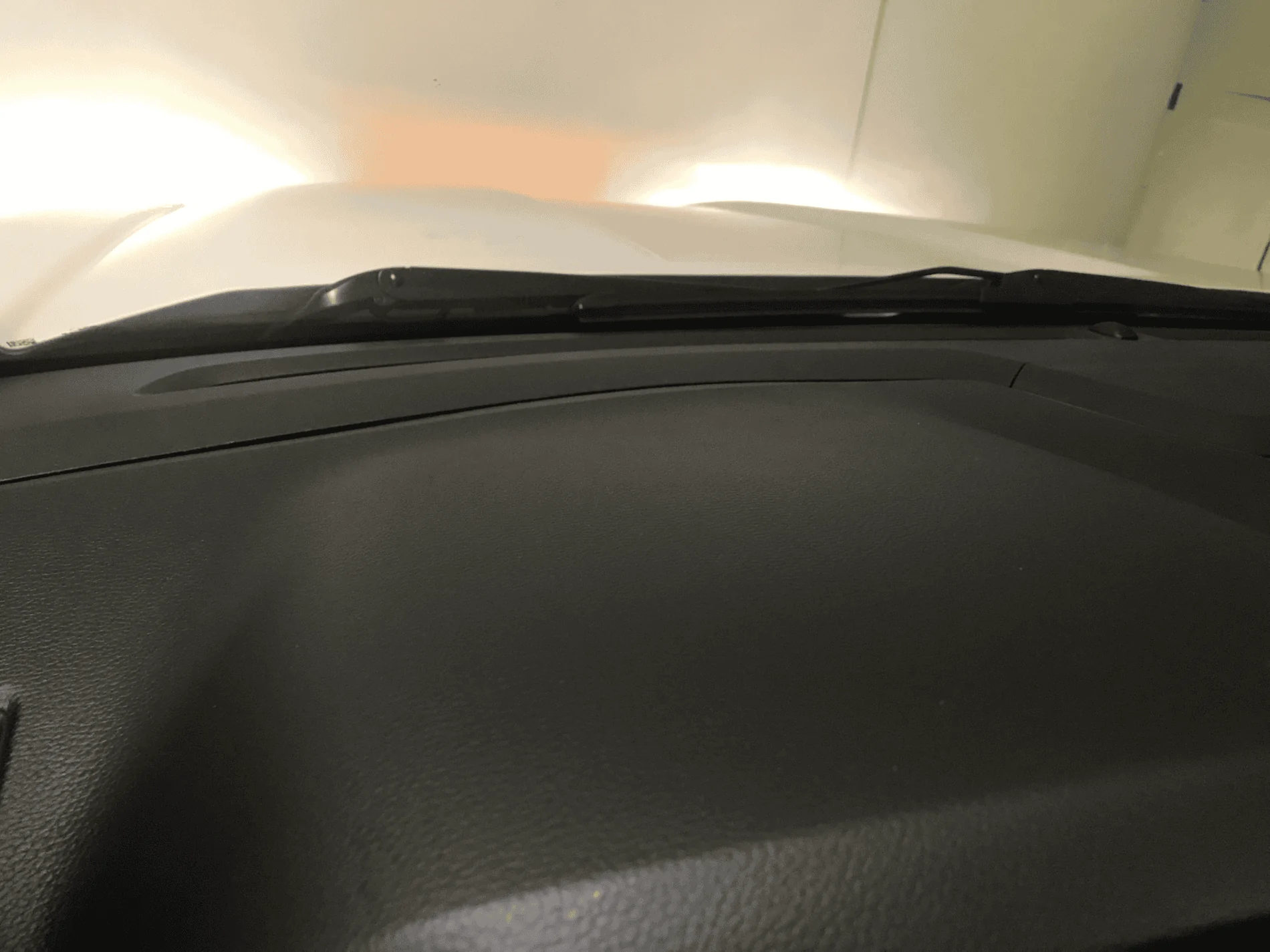

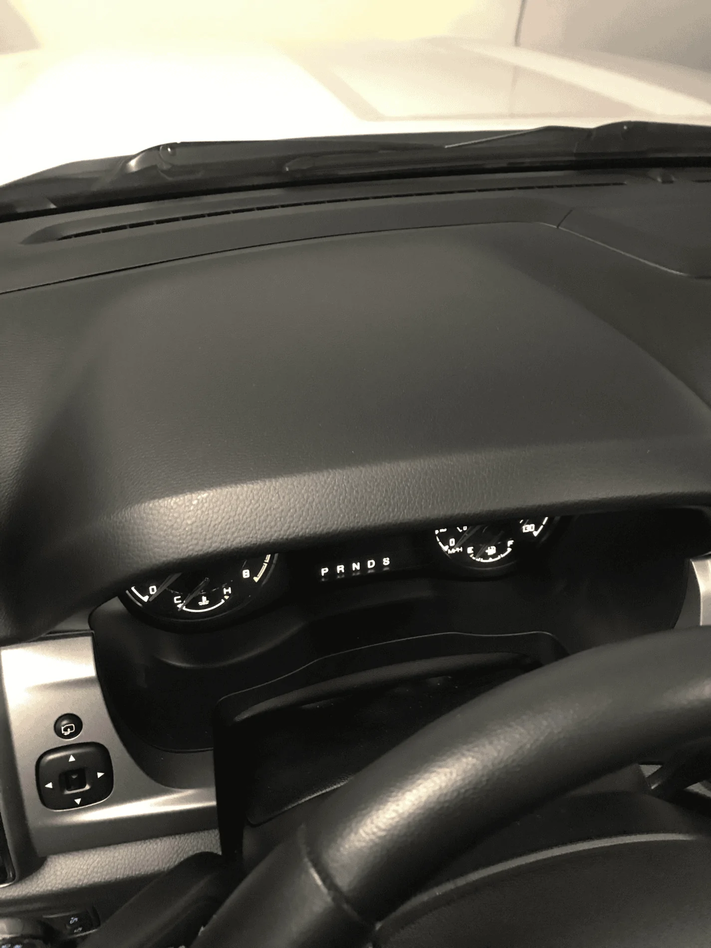

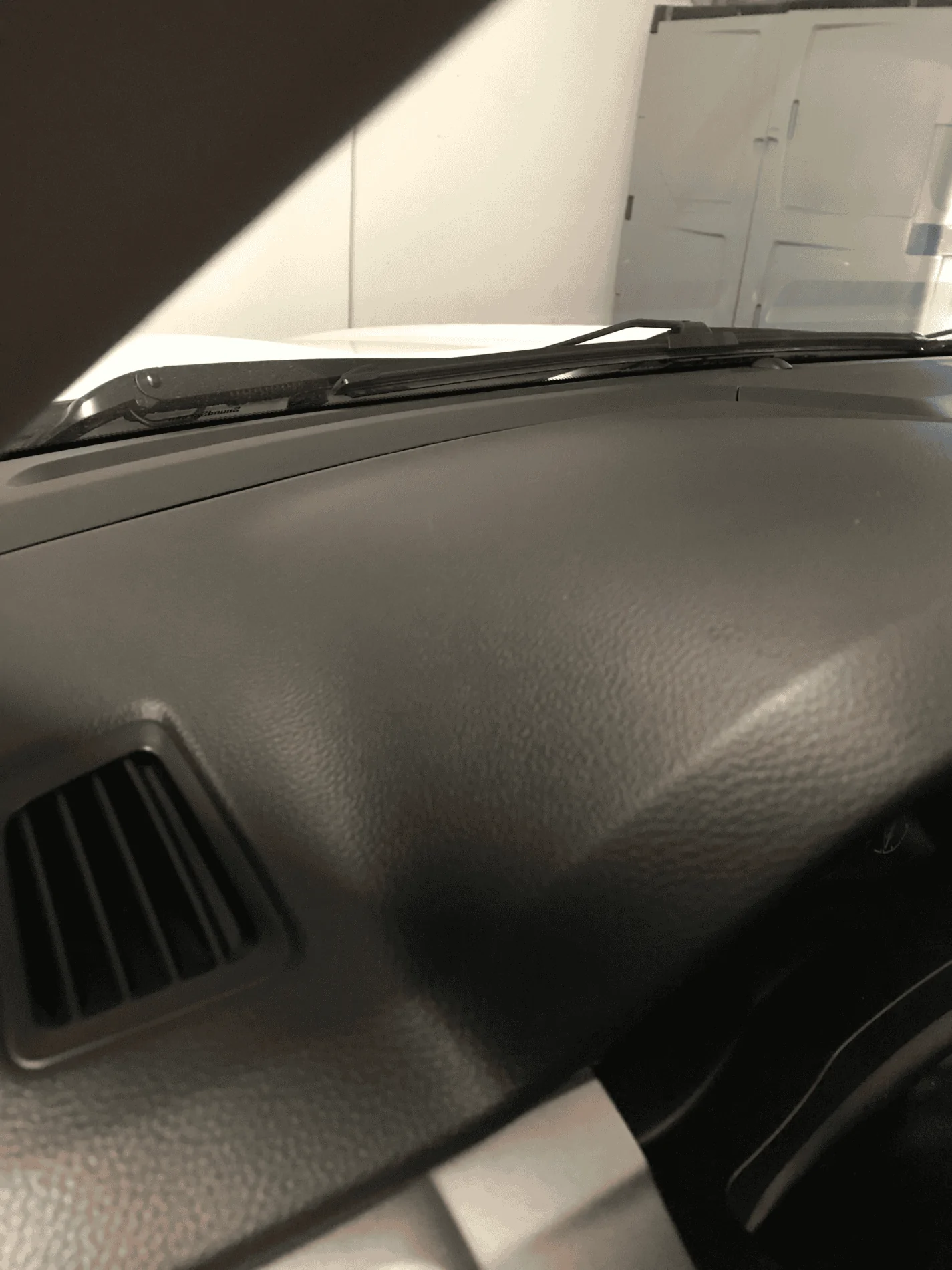

Sorry for the late reply, the two backer rods under the dash have worked great for me. I almost forgot about this thread since my dash has stopped rattling. The dash bulging happens if you put the backer rod under the defrost bezel. This causes the defrost bezel to rise up over the dash by an eighth to a quarter of an inch, but it also stops the rattle.
I took a few more pics of my dash. The two backer rods cause the dash over the gauge cluster to rise a little, but since the dash is curved it is hardly noticeable.
I undid the bezel clips one last time to make sure the backer rods are still in place. Nothing has shifted as of today.

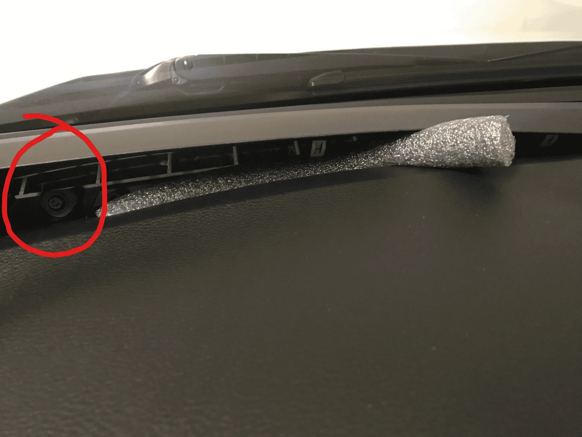

All 3 backer rods are one inch in diameter by nine inches long. The nine inches is ruffly the distance between the dash brackets.
I circled one of the dash brackets below, the other bracket is off to the right still covered by the bezel.
let us know what your dealer says. When i brought my Ranger to my Ford dealer, I disassembled the bezel to show them where and why it was rattling. They snapped the bezel back down drove it down the road, and said they couldn't get it to rattle. When I called back and said the dash was still rattling, they said they could try to double sided tape it down. I didn't want tape on my new dash so i went this route.
