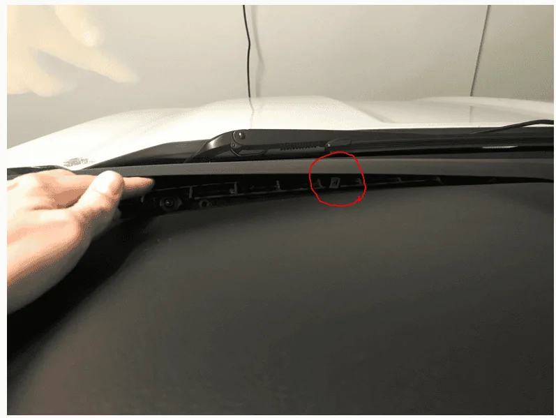

Hi Phil,
There seems to be a receptacle missing in the dash for one of the white clips on the defrost bezel located by gauge cluster. This seems to be causing the bezel to rattle on the dash when it is cold out, and you have the heat coming through the defrost vents. I'm not sure if it is only on the XLT models or if the Lariat models have this issue as well. It seems that the XL models have the emergency braking LED's in this location so I don't think they have this type of rattling issue.
I resolved this issue by using three, one inch diameter by nine inches long foam backer rods, and inserted the rods in the cavity under the dash. By doing this it raised the dash, and put more pressure on the bezel where the receptacle is missing (I think there might be an Autocad drawing a few posts back with more information on the location of the backer rods).
I tried to go through the managers at my dealer, and the most they could do was to try to add some double sided tape to keep the bezel from rattling. Through your experience at Ford Is there a better way to get out information on this issue, it seems the only way to fix this issue is to replace the dash with one that has been revised with a receptacle for the clip on the bezel.
Thanks for any information on this issue,

Sure thing. Does the bezel just pop up or do you hold it up with enough tension to slip the back rod below the dash?
I ended up undoing about 3 of the white clips, there are 2 close together near the A pillar on the driver side. Then you can slide past the one that is not connected and undo one more near the center of the dash. Don't go too far, there are two rectangular tabs on the bezel that go into the center dash speaker cover and they are a pain to get back in :angry:.
I attached a video on how I got it to work (hopefully the video comes in). Two backer rods should be enough to fix the rattling; you can use three if rattling is still persistent. I ended up using three to see what would happen as an experiment, and using three will bulge the dash but the dash is already curved so it isn't that noticeable. When you put the second rod in front of the first one, just have it slip under the dash (you should feel it slip right under the lip of the dash) don't push it back as far as it will go. The further back you push it into the dash the less effective it is at putting pressure on the bezel.
Disclaimer:
Once the backer rods are behind the dash, they are very difficult to get back out. (I know from experience). If for some reason you need to remove them, It is possible to get them out, but your knuckles won’t be happy.
