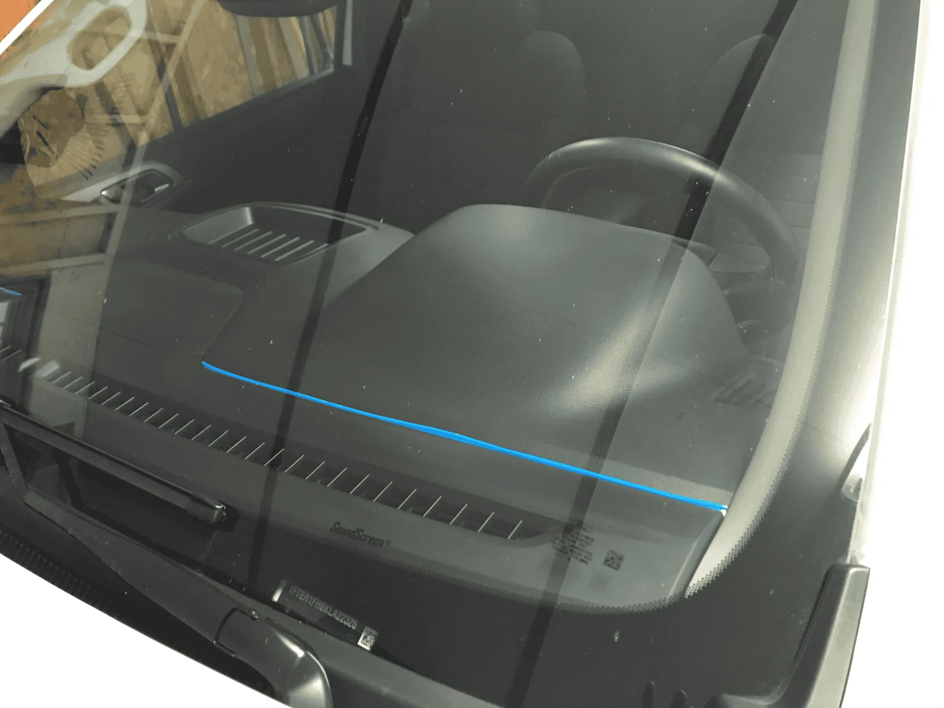

I have this same rattle as well; I tried a few different ways to fix it with no luck, so I ended up going to Autozone. I went down the "ricer" aisle and found an interior accent strip that slips in-between panels. It looks cheap, but the rattle stopped.

It looks like some generic flexible plastic. i will probably keep it as is until winter is over, then remove it since there is no adhesive holding it in. The vibration was only noticeable when it gets cold. There could be a black one out there; Autozone only had red or blue.
