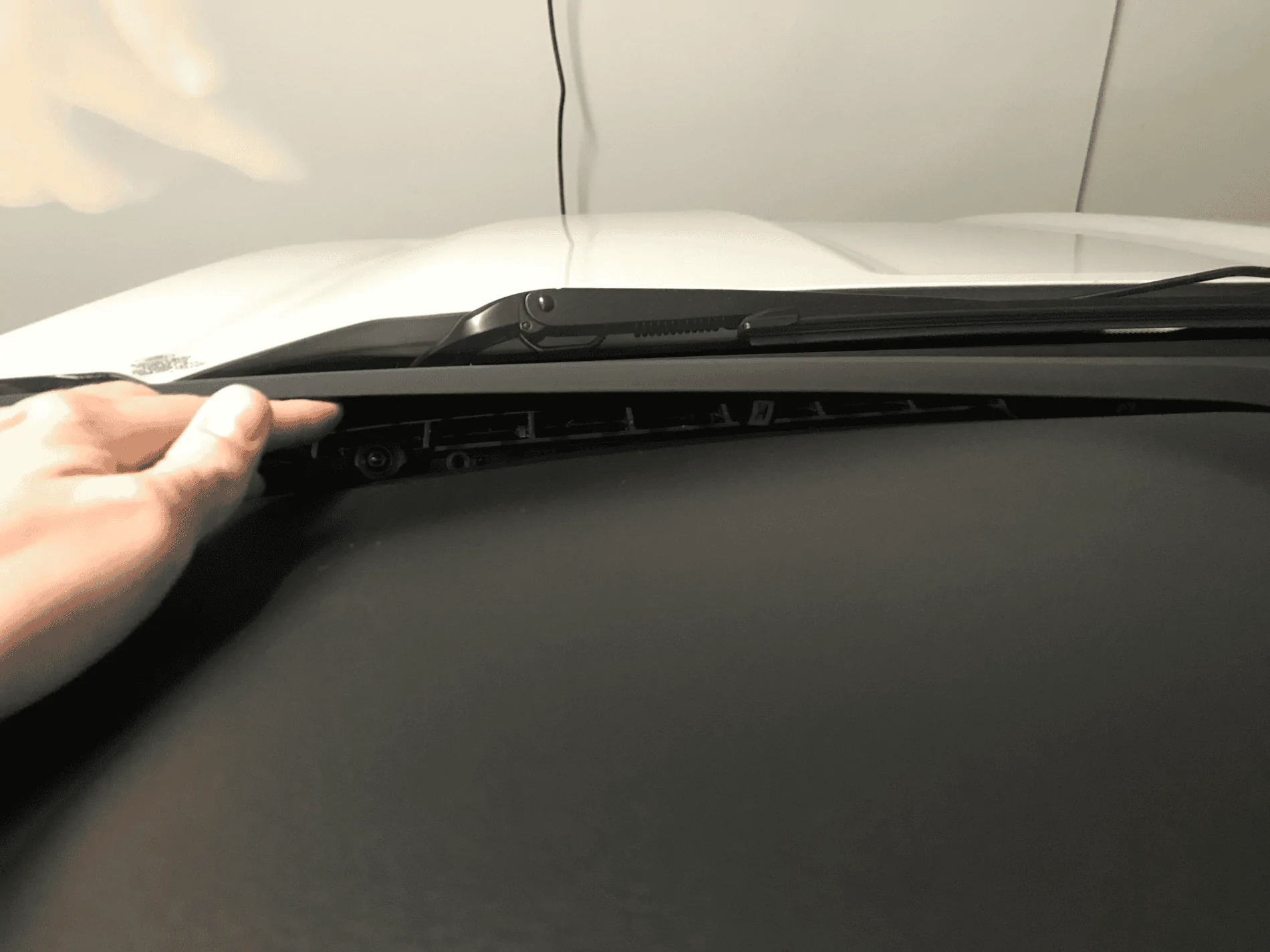

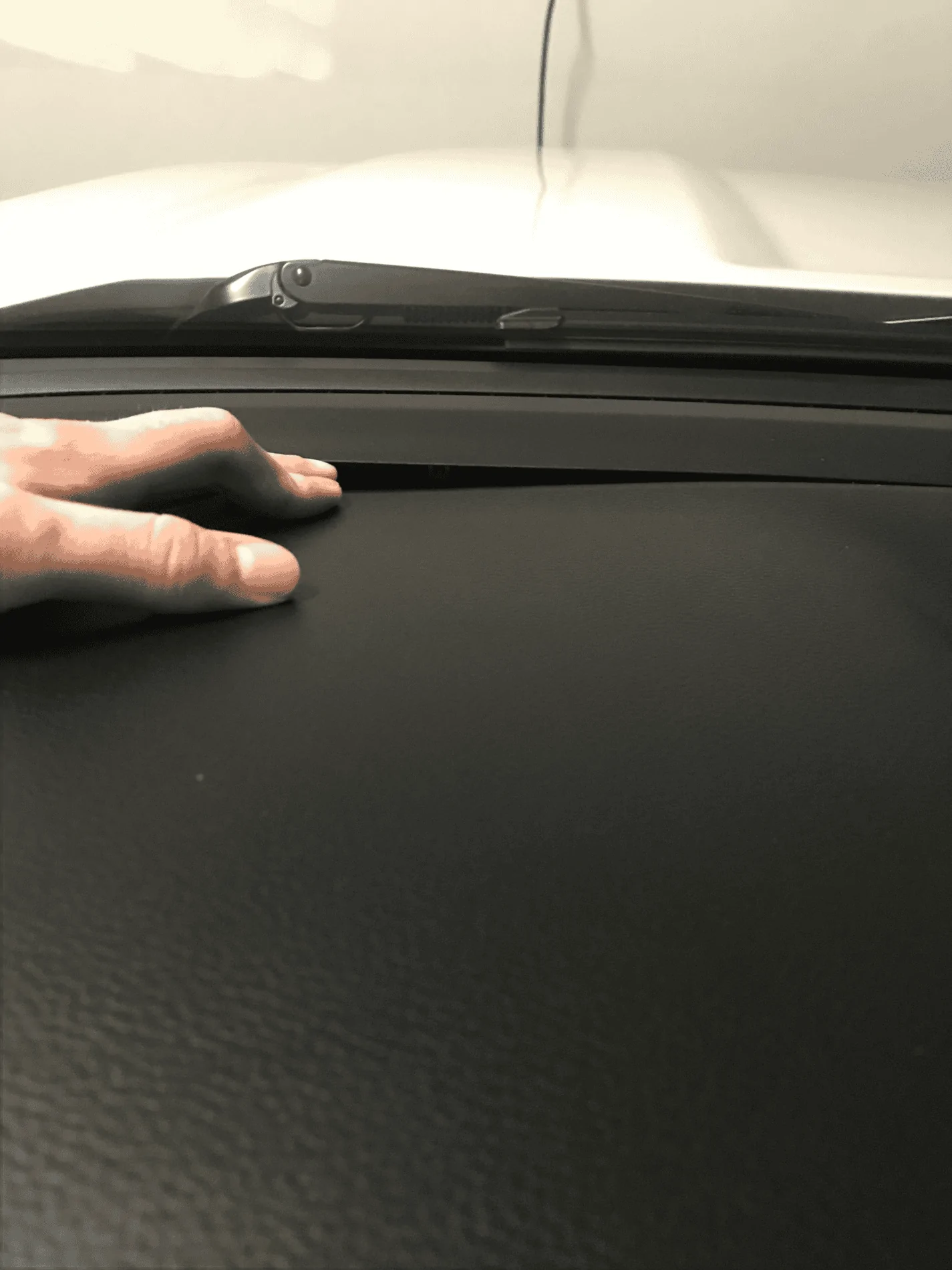

The rattle i have experienced is where the dash meets the defrost vents. If you push down on the dash right over the gauge cluster you can see underneath the defrost vent bezel and there is a clip there with no receptacle. i think that is causing the rattle for me.

I think I found a solution, it requires some 1" backer rod (you can find at your local hardware store).
Pull up on the defrost vent bezel until the clips detach.

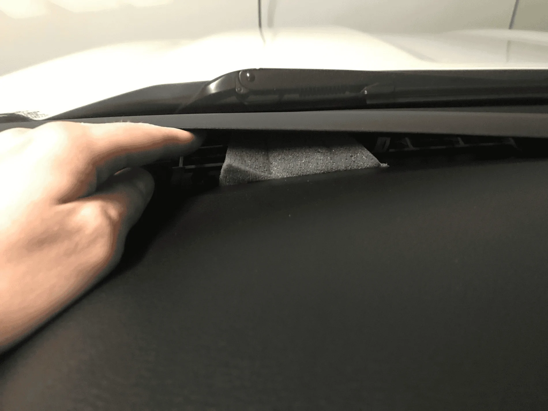

Then take 9" of the backer rod and tuck in just underneath the dash cavity over the gauge cluster (where rattle occurs) ... WARNING... try to keep the backer rod as close to the edge of the dash as you can, it should tuck nicely under the lip of the dash no need to push it farther back. If you push it further back your will still be OK there are two blocks under the dash that will keep it from going too far and hitting circuit boards. The further towards the gauge cluster you go the less effective it is in stopping the rattle, and it becomes very difficult to get back out.
I have tried a few different types of foam, the backer rod seems to work the best at raising the dash and tightening the gap between the defrost bezel and dash
(different type of foam)
So far it has stopped the rattle and leaves no evidence of modification. Only taken it on a few drives i will update if it continues to work.

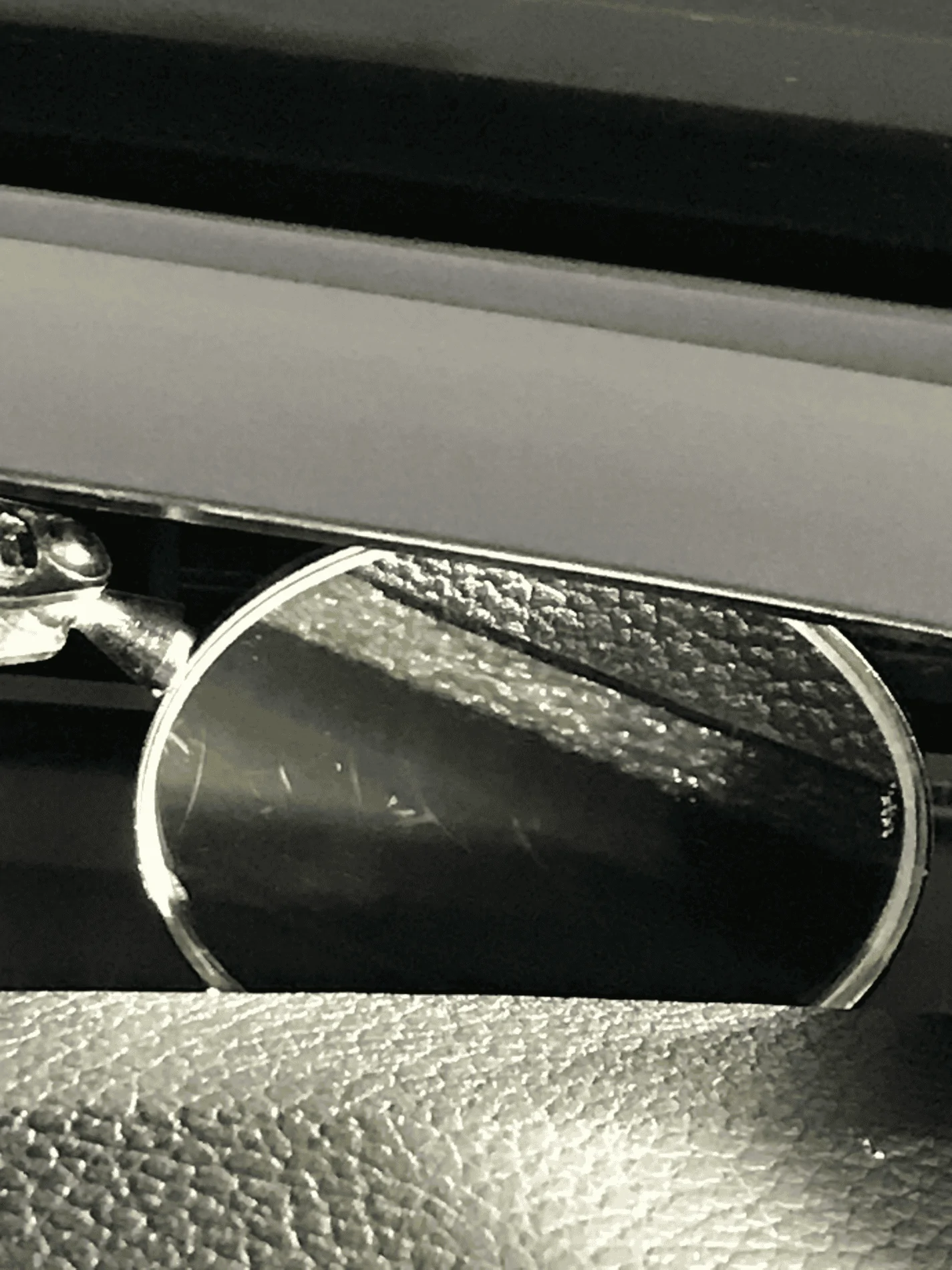

Tried to take one more picture of the backer rod behind the dash, you can kind of see where it tucks under the dash in the mirror.
