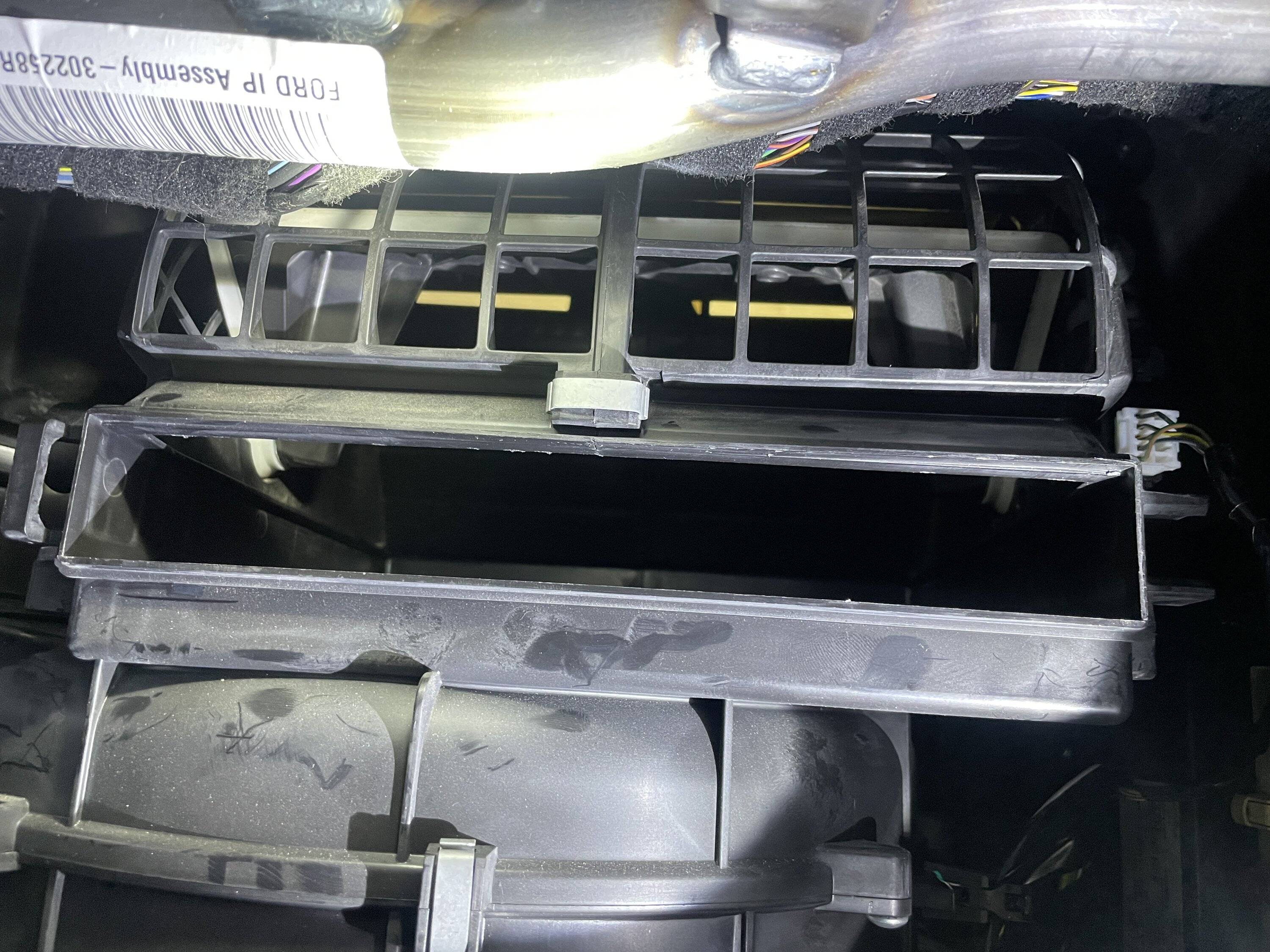

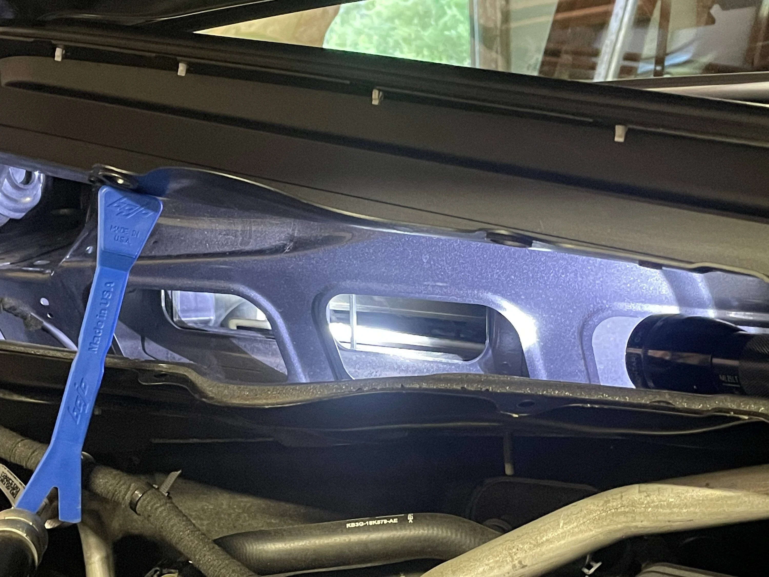

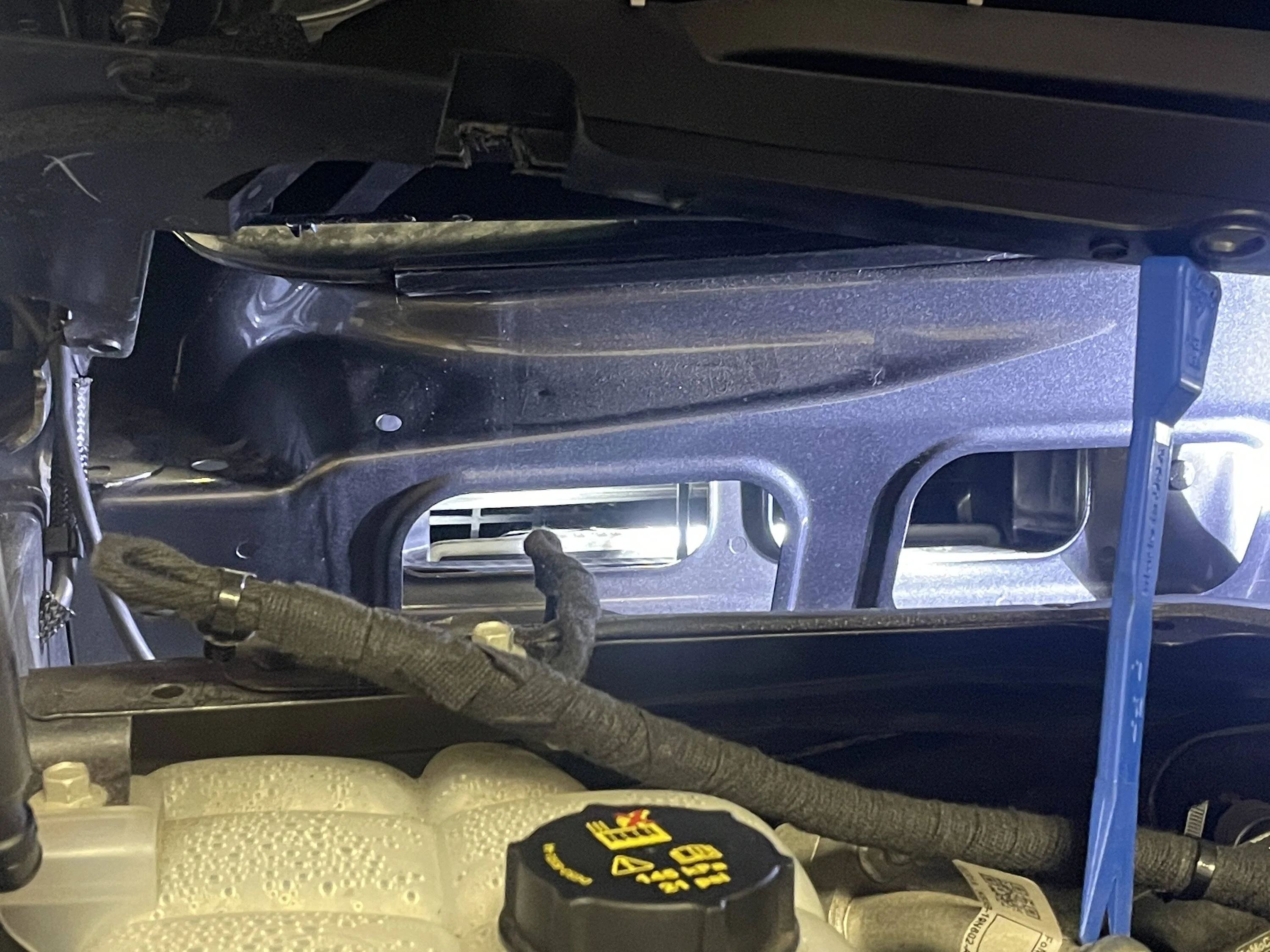

For those curious where the two openings are located.
Remove the (8) clips that hold the plastic shroud at the rear of the engine bay towards the windshield.
You'll see two openings on the firewall that are approximately 5" x 3". The openings beyond the openings.
View(s) from engine bay.
View from inside the truck behind the glove box. There is a motor on the right, you can see the wiring harness that rotates the recirculation door. You can see the daylight coming through.

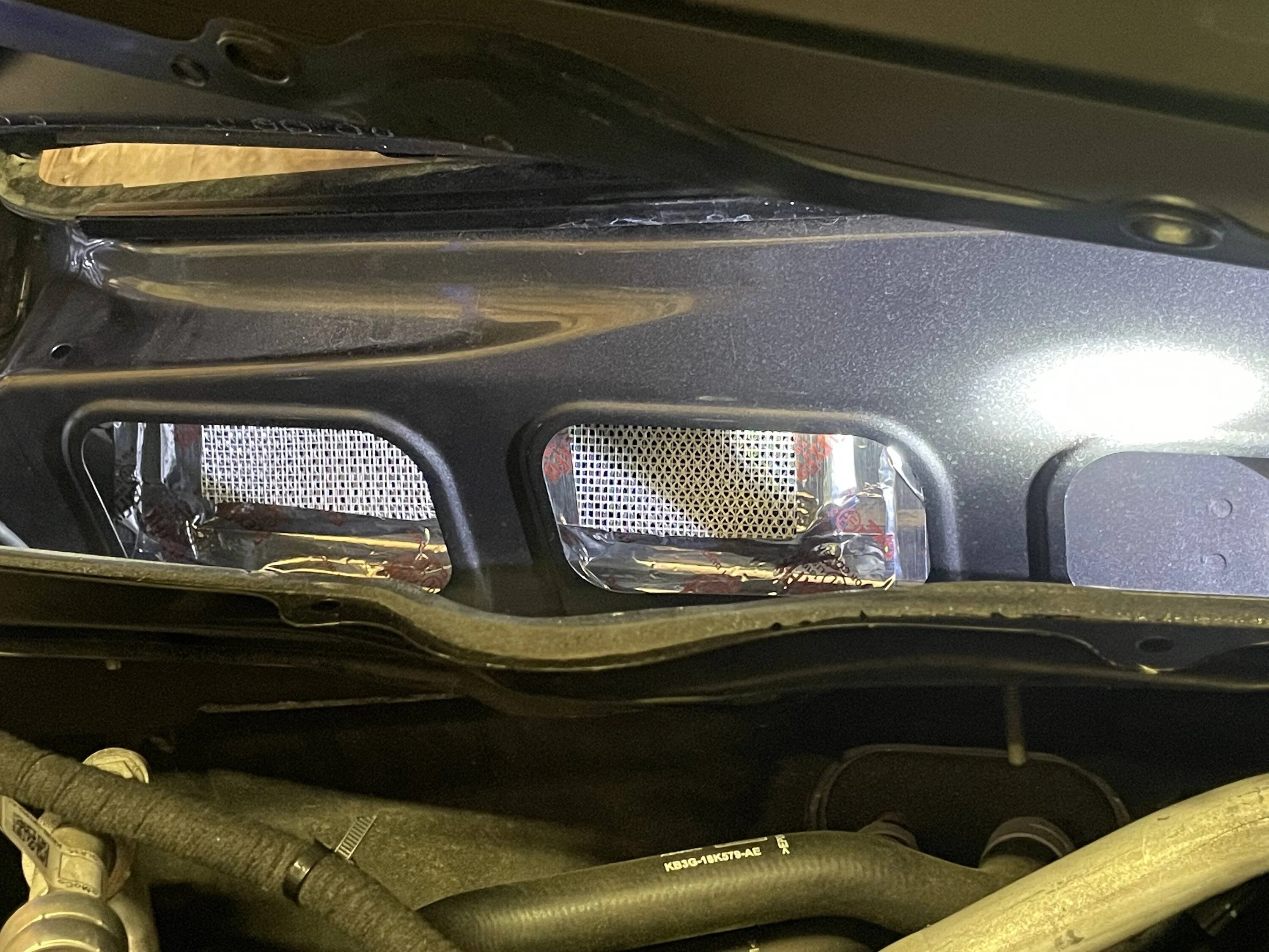

I ended up using some aluminum drywall patch. The sticky side really helps positioning the pieces and holding in place while it gets taped. up. Cleaned the area with alcohol and used aluminum tape to hold in place and seal the edges. Gonna be a pain to remove the tape when a more permanent solution can be printed up. I ended up cutting two pieces 5.5" x 3.5" so there is a 1/4" overlap around the openings. Taping was a PITA, but not impossible. I trapped another one last night in the truck, I'll keep on trapping until no more are left and no signs of droppings. The mesh is small enough it should also keep out most bugs. I may have a slight reduction in fresh air, but I doubt it would be noticeable. The alternative is much worse.
