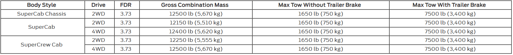

I don't think it is for this Ranger. Seems like the 2 main things you need to achieve a 7500lb max towing capacity are a frame mounted hitch receiver that allows a capacity of 7500lbs AND a brake controller. You need both.
No, you only need the hitch. If your trailer operates on electric (vs surge) brakes, you'll also need a brake controller.

this is a RTFM situation. According to the manual, you don't get 7500lb capacity unless you have a trailer brake (and controller) equipped.

You're absolutely right: RTFM. It says "without trailer brake" not "without trailer brake controller"--you just added the "(and controller)" yourself.
Surge brakes don't require an electric trailer brake controller, and are actual trailer brakes that fulfill the documented requirement. A lot of people seem to not get that what they need for their own trailer isn't what other people need for their trailer.

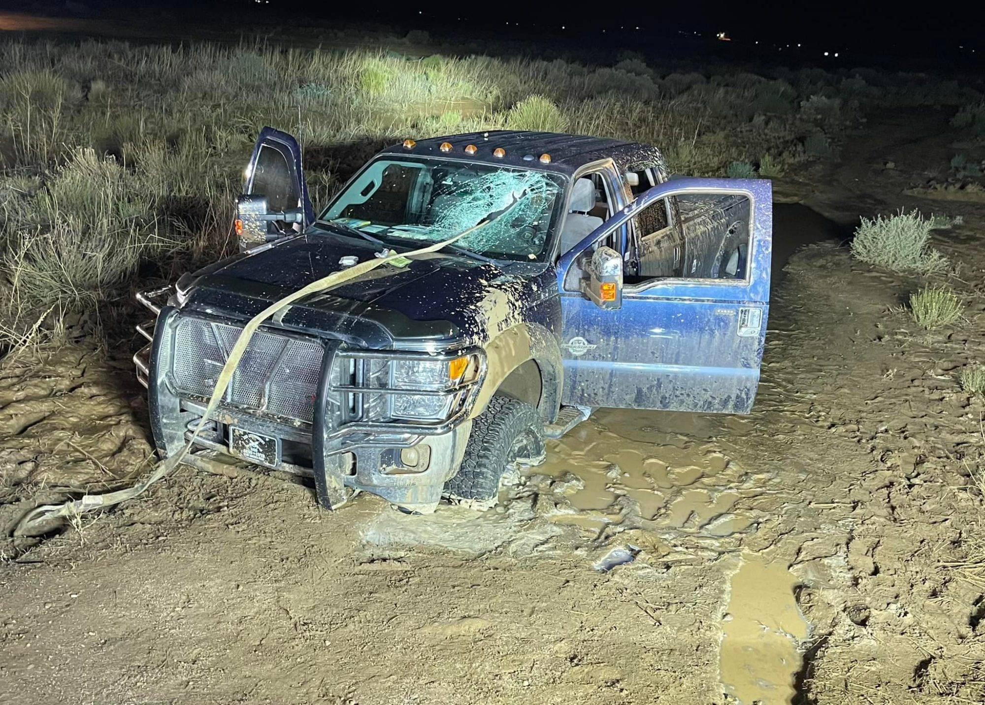

Like this guy where the ball pulled through the bumper and came through the windshield and killed him.
Almost any stuck vehicle is going to exceed the 3500 lbs limit of the bumper, regardless if the ball is rated for 12000 lbs.
Sorry, I don't mean to come across as a jerk but this can literally be life threatening to you and others around you.
Please be safe and do it right.

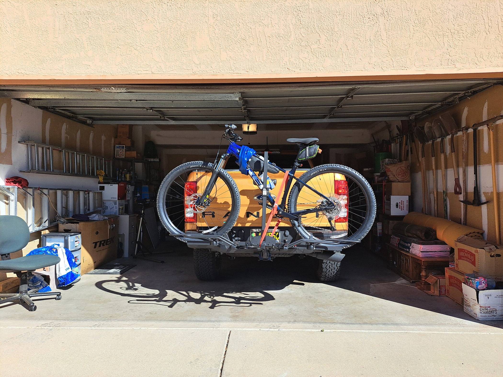

I would not recommend towing from the bumper but installing a receiver hitch to the frame and getting a 9 pin connector with a dropper hitch. Towing from the bumper can damage it and the frame mounted hitch is much safer and has more towing capacity and security. And like Dennis @dr-zaius said, it can be downright dangerous.
I have owned 2 boats and towed them on trailers with previous trucks on frame mounted receivers. Currently on the Ranger have a frame mounted receiver with a carrier rack attached that I use for transporting my Mtn. bike which is considerably lighter than your motorcycle. Even at that prefer the security of hitch mounted receivers. Assuming you will probably be trailering your Bike.
