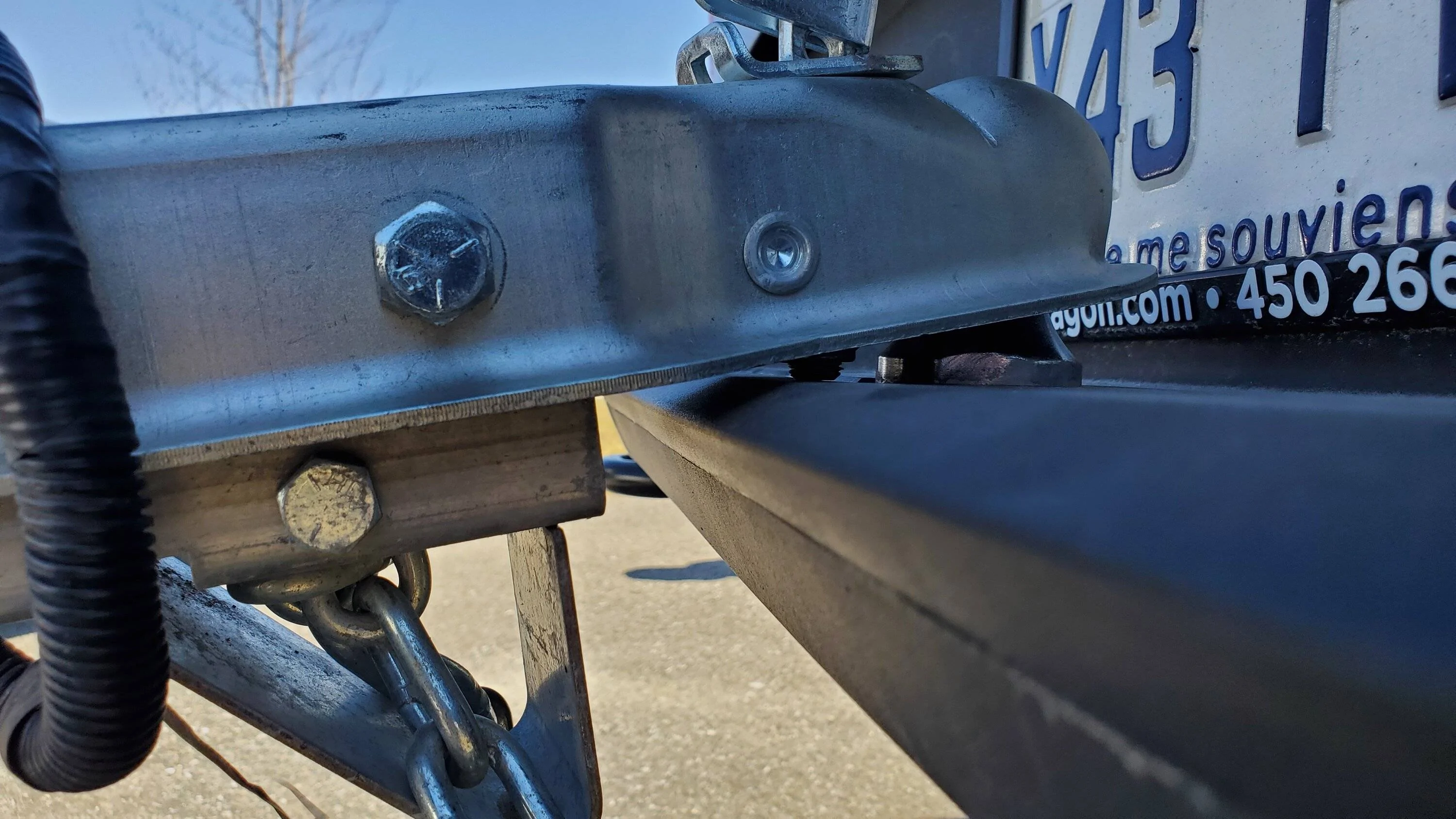

3" 1/4 shank fits. I got that on mine. But unless the trailer is lifted, it's useless. I tried and came to the conclusion that i need a hitch. The rear is just too high. I must precise that i have a tremor so it's higher, but still not the best. I put 2 washers to elevate the ball a bit more, and it still rubs.

also need a extended tongue on trailer...

@Simon Says did post with pictures that a 3.25 shank works. Picture also showed you need to check that your trailer doesn’t hit the bumper when turning.
I would bet most of us that tow use the factory or aftermarket receiver hitch. Lets us get the ball hight right for a level trailer and the hitch out of the way when not towing.

If by the Ford one (mentioned above), the shank length is only 2 1/8". That is not long enough. Also, Simon Says stated that the 3 1/4" long shank will work, and he even has a picture of it installed. I provided a link to one that has the 3 1/4" length needed. The right answer has already been provided.
