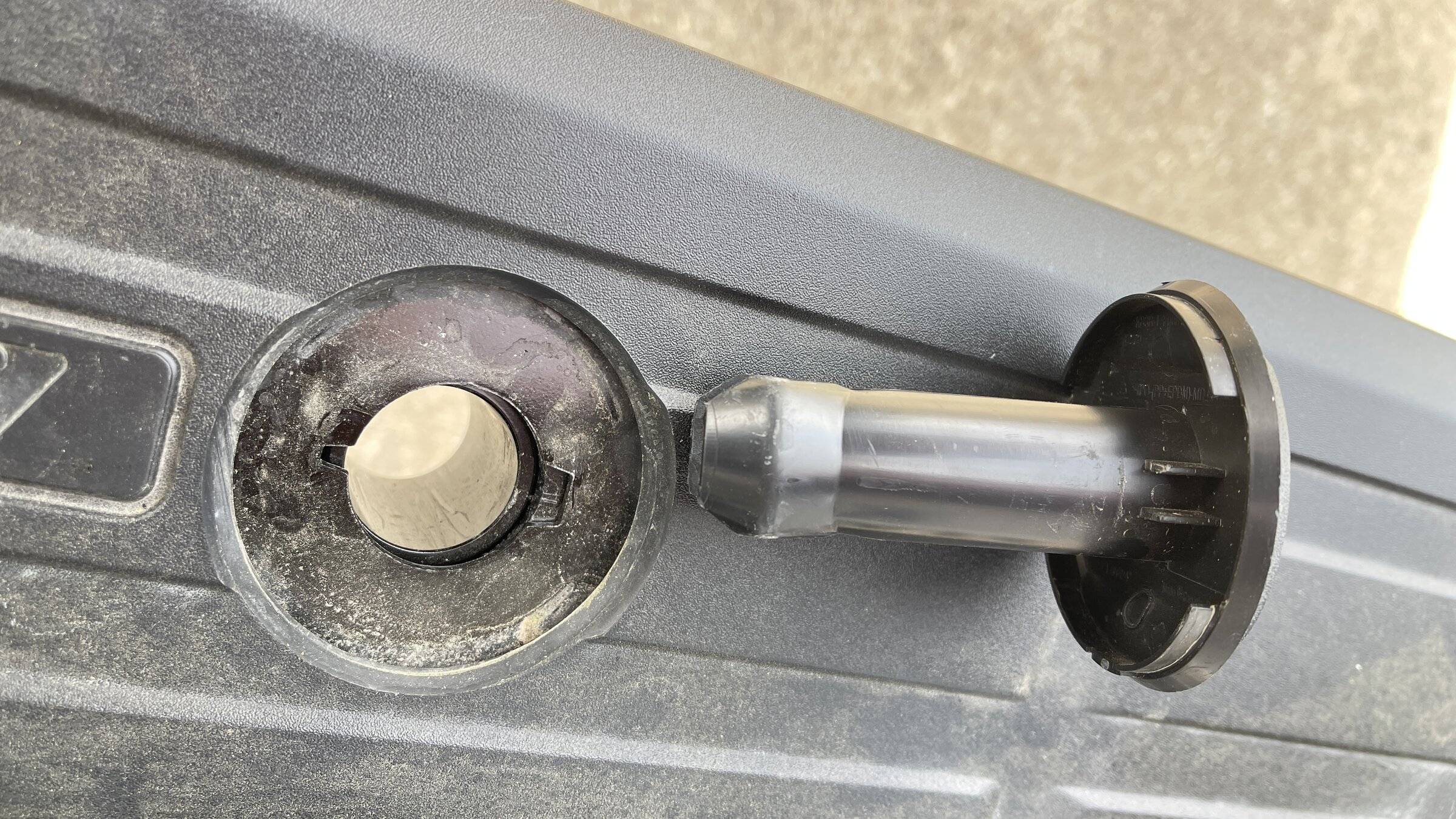

I just took delivery of a 2022 Ford Ranger Lariat and it appears to have everything I need to tow with except for the 2" ball.
There's a hole in the rear bumper where I can take out the plug and put in a towing ball.

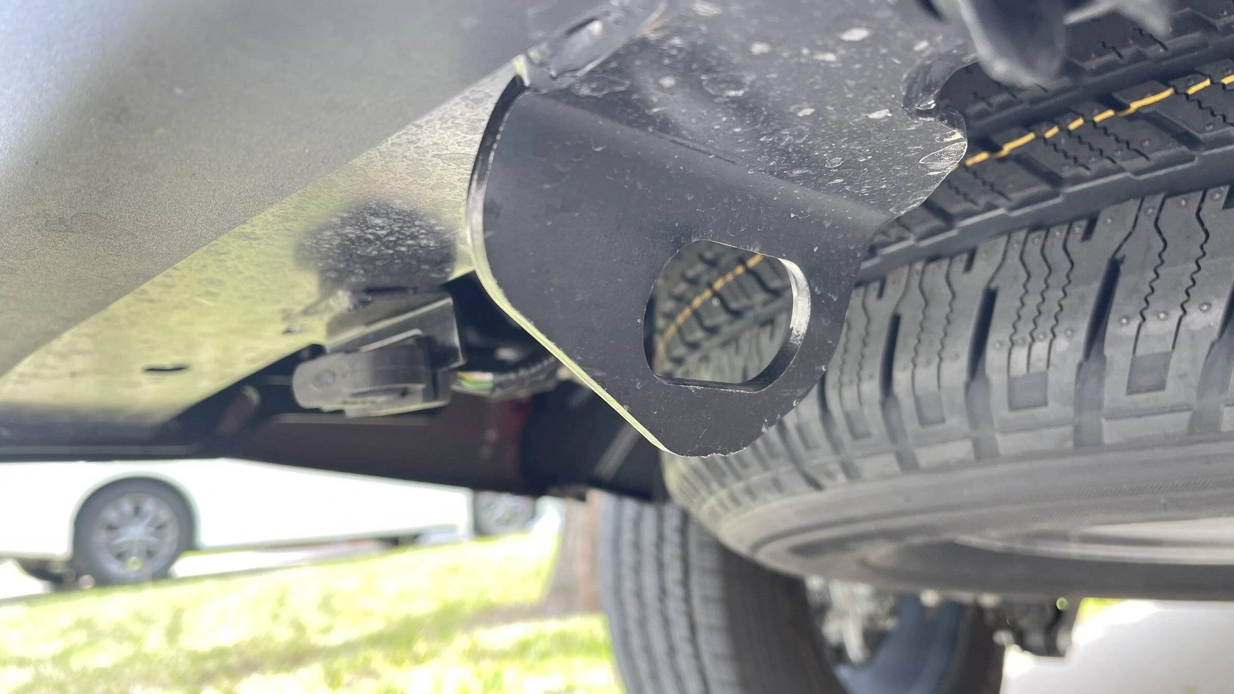

Under the bumper is the needed 4-pin electrical connection and the loops (see pictures) where you can secure a chain from any trailer that you may be wanting to tow.
In the cabin, there's anti-sway and towing controls
However, I can find NOTHING about putting the ball into the bumper of a 5G Ranger. Not in the owners manual and not on YT and not online that I've found
I learned this while visiting a U-Haul center where the tech knew immediately that I did not need to install the receiver bar on the bottom of the vehicle but the ball he had did not have a shank long enough to go through the hole in the bumper and be secured with a very large nut screwed on far enough to allow a cotter pin through the shank below it. The shank length of the ball at U-Hall was 3 1/4 inches. The shank needs to be longer, but I don't know what that needed length is.

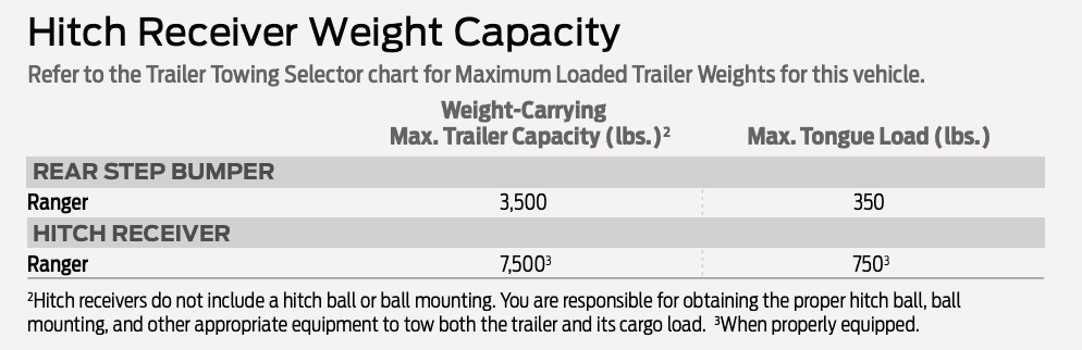

Just saw this from Ford thanks to a link from Elmosaurus above. It says the Rear Step Bumper can have a max trailer capacity of 3500 and a tongue weight of 350. Compare that to the Hitch Receiver of 7500/750. If I use the step bumper hitch, I don't think I would exceed 3500/350 but still have to think about the height of the ball.

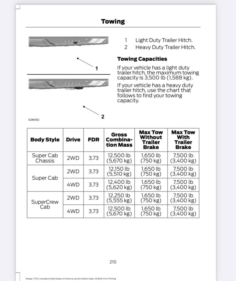

I recalled seeing this in the owners manual regarding using brake controllers and trailer brakes in general (surge or electric) so something to keep in mind that ford recommends this

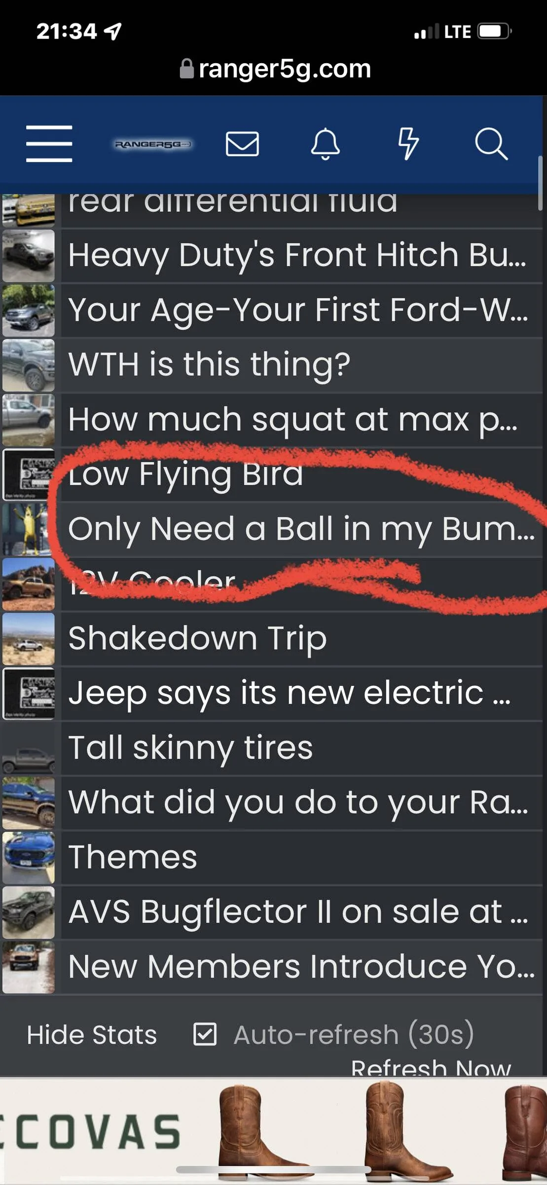

So… this is how the title of this thread shows up on my phone. And then, y’all are talking about the length of your shanks….
