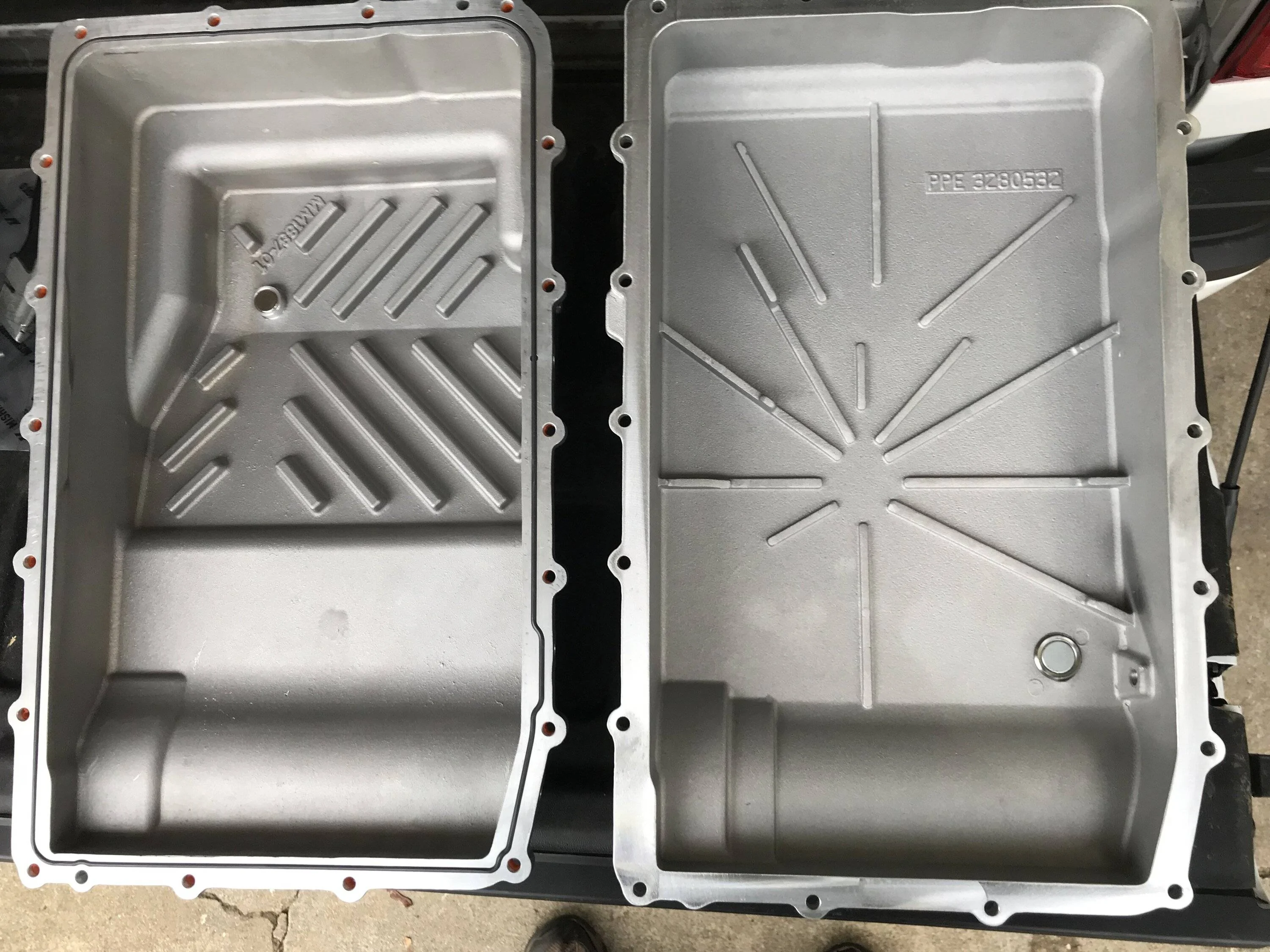

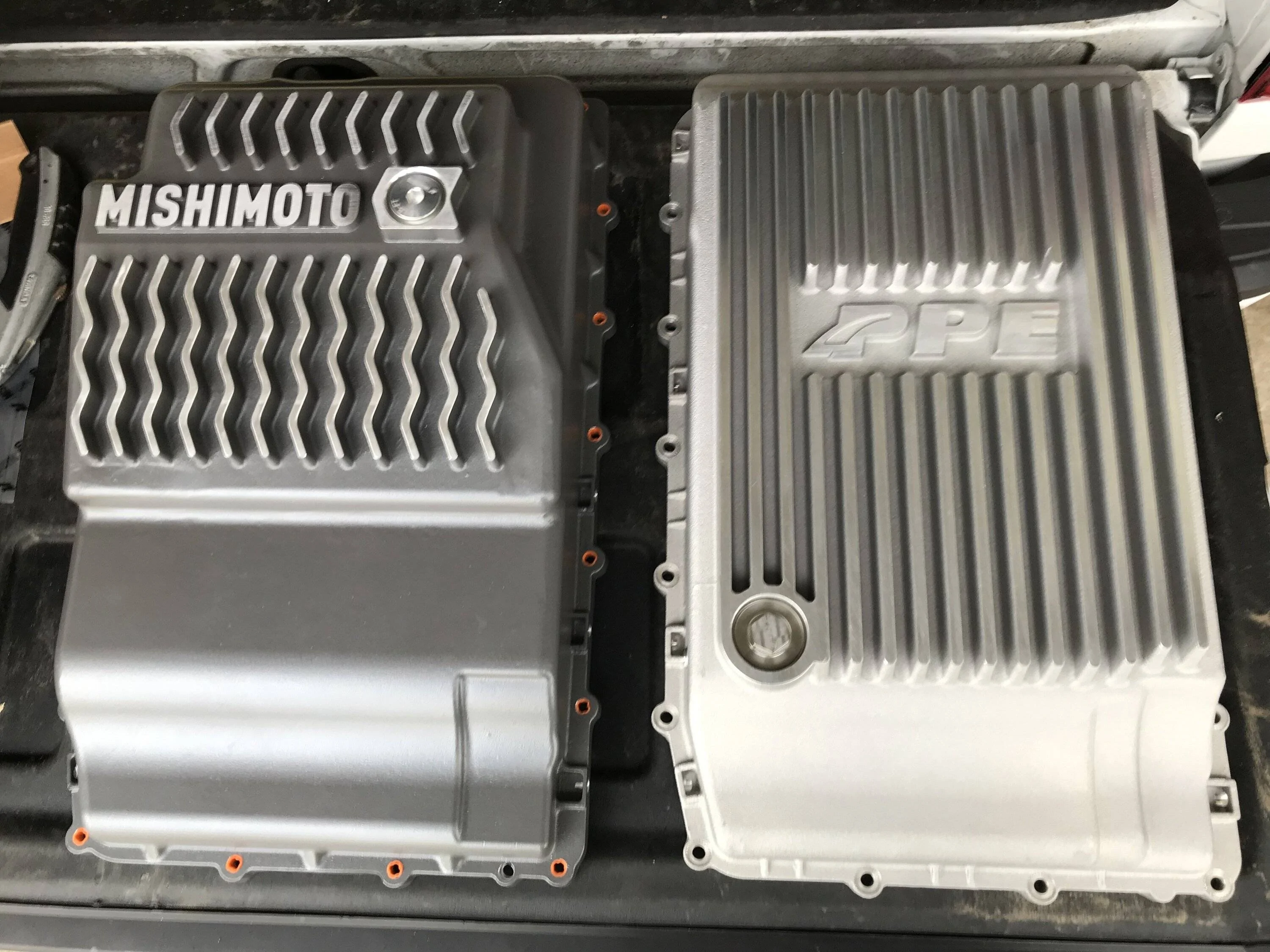

I got both trans pans and comparing them. The Mishimoto pan is very nice and as you can see it’s a deep pan..
‘The PPE pan is not the deep one but between the two I like it better. It’s a lot heavier thicker
and the drain plug is larger. what do you think? I’m going to weigh them to find out the difference.
Just noticed the Mishimoto wont fully drain. The bung is raised. That alone would push me to PPE
I think that's just the plug you're looking at. The plugs are shiny and stick up into the pan.
Definitely curious which one’s lighter and by how much. Let us know when you find out! I’m going to be swapping mine out soon and weight is a bigger concern for me. I’ve already added enough weight to take away 1” from my 3.5” lift lol

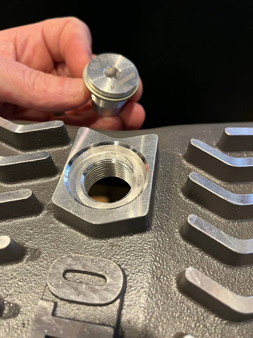

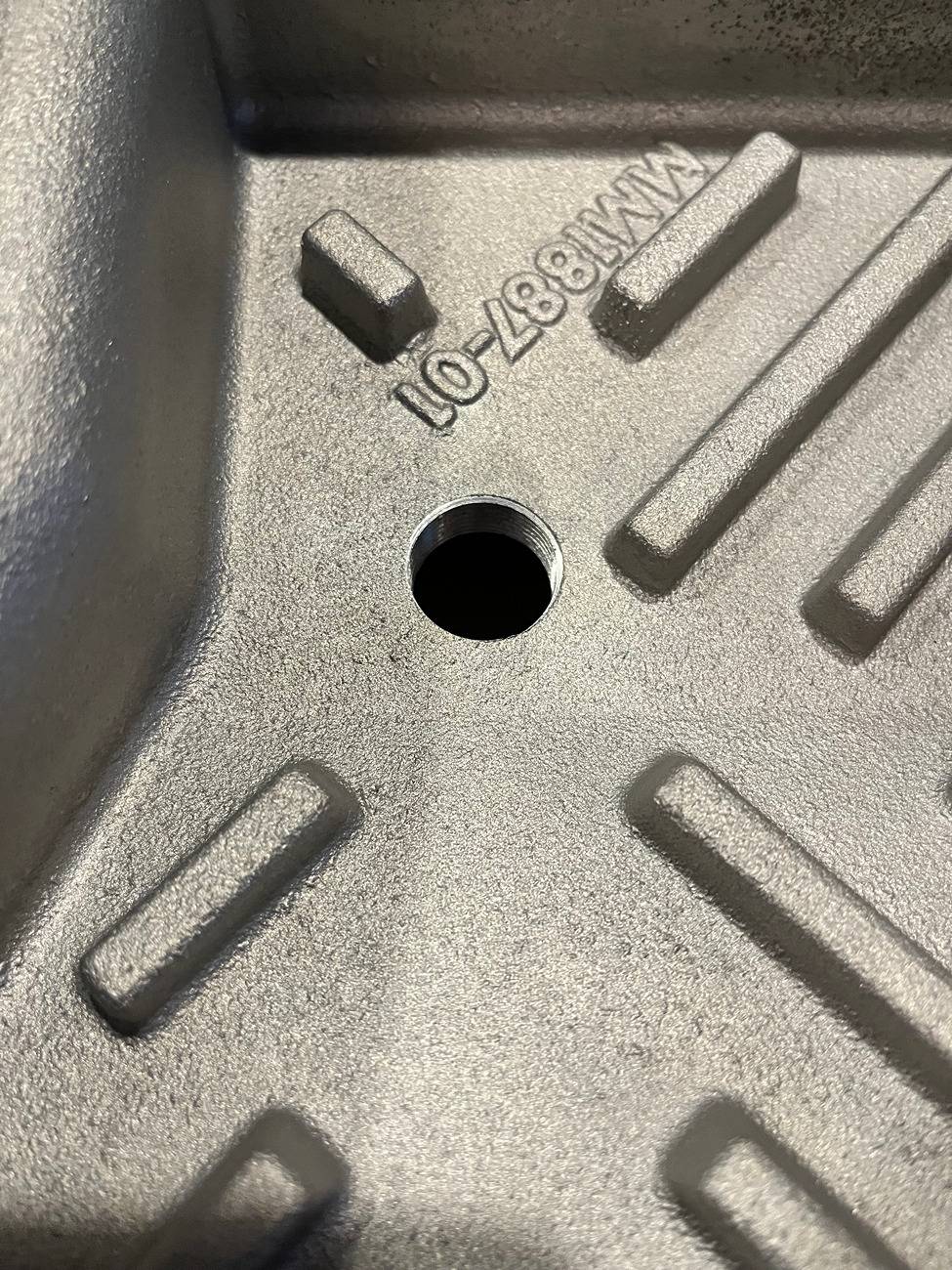

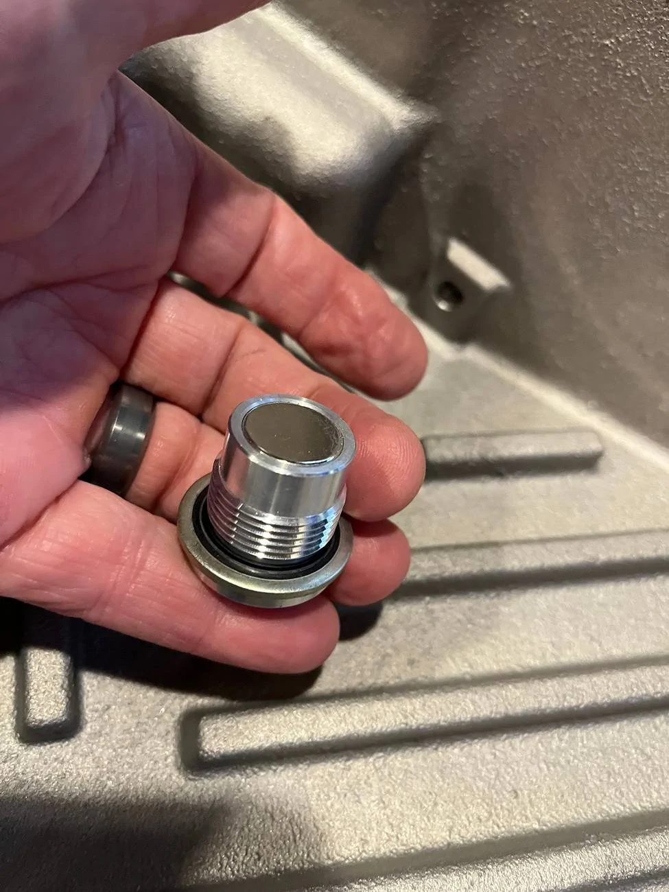

This got me curious so I dug out my brand new in the box Mishimoto pan that I bought back when they were on sale.
It's the magnet on the drain plug. The pan will drain fully.
It's one more thing in my pile of parts to be installed this spring.
And dang, this is a solid piece. I'm impressed.
Anyway, here are some pics.
Edit: If anybody wants any more detailed pics of the Mishimoto let me know before I box it back up.
