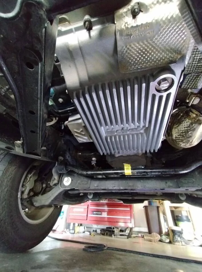

If I remember from when I installed it, it will all drain except for a minor bit around the plug lip. However, I could be visioning wrong.

Thanks Randy & Shawn for replies. Things make more sense now.
I ordered PPE regular (not deep) fluid pan. Should be fine.
Apparently (matches guess of mine) mating surfaces plane (pan & trans) angles down (toward shallow, less tall end of pan). Thus drain at shallow end of pan should work fine.
For deep[er] pan models, bottom of deep end of pan must now be below bottom of shallow end of pan (due to increased height/depth of pan at tall end). Added depth then alters end where pan is lowest (overcoming mounting slant of mating surfaces) & thus drain loc shifts by design.
I hadn't grasped this during my initial puzzlement yet figured there had to be an explanation for different drain locations on different pans.

Per PPE, the shallow pan holds about 3/4 of a quart more, so if you measure what you take out and are confused why it isn't the same level after you put the fluid back in, that's why.
