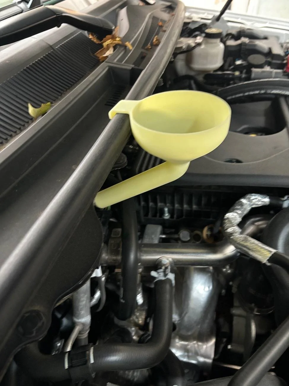

Oh yes the dipstick is the best thing I added so far and just got one of his funnels to try and give feed back. I have not even used it yet and it’s perfect including the fit!! I hope to get the fluid dropped overnight this week coming up and give it a test..
