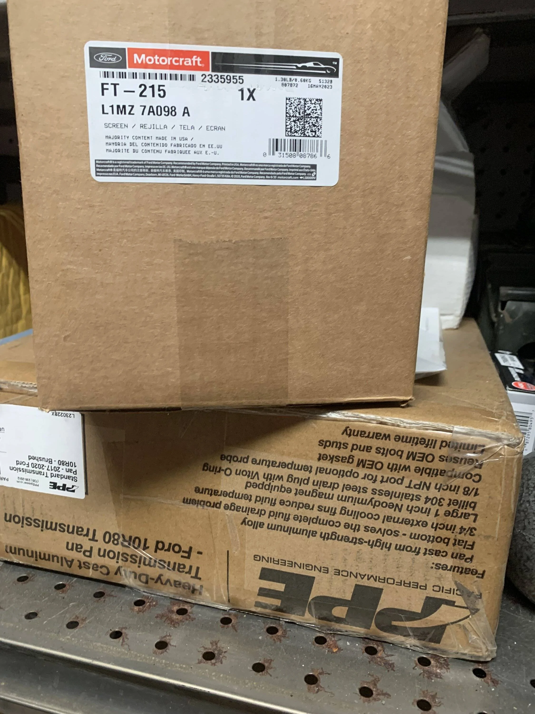

So glad I bought the regular PPE pan now. Actually purchased it by accident I did want the deeper pan but glad I messed that one up. Now I just need to find some time to install. Also I bought Motorcraft filter on RockAuto for those who are interested.
